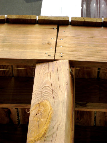

    1. bobframe | Aug 13, 2008 10:45am | #3

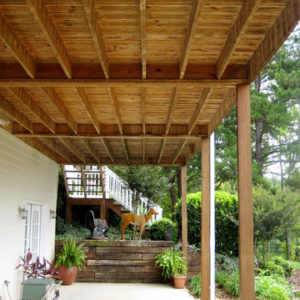

      Sorry about my confusing words. I am trying to attach a picture to help explain. The sistered 2x10's run perpendicular to the house and span the 12' depth of the deck. The are connected to the ledger board on the house with double joist hangers and to the 2x10 rim joist at the outer edge of the deck. These 2x10's joists have 2x8 joists connecting them- they are on 16" centers and span 10' in some sections, 14' in two other sections.

            now I undestand what yur talking about...
            are the 6x6's at the ends of the sistered 2x10's???
            what does their connection look like???
            my inclination is to say the sistered 2x10's are inadaquite...
            look into adding another set of sistered 2x10's perpendicular to the 2x8's at their centers in a tressled beam configuration...
            and add screws.. pull the loose nials that you can get to...
          3. bobframe | Aug 13, 2008 03:28pm | #19
            IMERC said: look into adding another set of sistered 2x10's perpendicular to the 2x8's at their centers in a tressled beam configuration...IMERC, cam you describe a "tressled beam configuration" to me?The sistered 2x10's are sitting on top of the 6x6 posts. This is actually another concern- the 6x6's have twisted so badly they are really worrying me-clear to me that the posts have to be replaced. Suggestions on something that won't twist.To answer your question- I think the rim joist is nailed into end of sistered 2x10's and that whole system is toenailed into the ends of 6x6's. Doesn't sound very secure does it?Trying to show pic of posts-what am I doing wrong- the picture uploads, but isn't opened- I just see the little ".jpg" icon.Edited 8/13/2008 8:32 am ET by bobframeEdited 8/13/2008 8:52 am ET by bobframe

        Jeff_Clarke | Aug 13, 2008 03:18pm | #18
        OK Bob - Personally I would start over and here's why:Code design should be to 40 PSF live load - that puts a total load of say 600 PLF on your (2) 2 x 10s which exceeds their capacity by a factor of about 2.5.
        14' is too long a span for 2 x 8s under these conditions.
        Ledgers are no way to attach the 2 x 8s to the (2) 2 x 10s - should have joist hangers.  If the obvious bow in the ledgers correctly follows the line of the bottoms of the (2) 2 x 10s (not the outboard member)  then you have obvious deflection under no load conditions.
        I don't see any evidence below the deck of proper railing post attachment - please advise.
        IMO the outboard member should be a double, not a single - despite the fact that the main joists load the (2) 2 x 10s this member is essential to prevent racking.

          1. Piffin | Aug 13, 2008 07:08pm | #28
            10-15# for dead load and 40# for live load means a minimum of 50# design load, IMO. That is for dealing with deflection and system failure, but does not adress all potential vibration issues which can come via overkill on design loads generally.

      I think from the first post that the 'sistered' 2x10s are the beams running perpendicular to the house, and 2x8s land on them so the deceking can run perp to the house and drain away.Most of the bounce would be in those beams if they are only doubled. Should be 2x12 tripled.The 2x8 are fine for the 10' spans but overspanned at 14'I'm going to read the rest of this and get caught up before mouthing off any more now;)

  7. Piffin | Aug 13, 2008 07:01pm | #27
    OK, I have had time to see the photos and thought about this.
    My firs t comment is a general one. That in way too many places decks are not subject to inspection and that leads to the fact that there are too many failures making fro a black eye on this industry, tho a lot of those failures are due to homeowners doing an addon after the fact. I see that you had a builder do this so shame on him.
    I see three things wrong, but given that he was poor in what I see, there could also be other problems contributing to this.
    First, when a deck is framed this direction ( I do it that way myself so the deck boards can lead water away from the house when given sufficient pitch) there is no need whatsoever for a ledger. The beams can be coupled to the house with fewer connections and less chance of water penetraing the envelope. Ledger connections are responsible for a LOT of rot problems in the house frame proper. But when a beam is hung to the house with a single hanger and a self healing membrane behind it, odds of water problems are far reduced.
    By using ledger first, then attaching a beam to that ( in what manner I don't know) there is an added structrual step. The more connnections, the greater the odds of failure from human error / poor workmanship or from hardware failure froma number of causes.
    One of those causes that is commonplace now days is corrosion from ACQ lumber. If six years old, your deck was built about the time that we were all changing over to ACQ PT from the older better CCA PT.One problem caused by this change is that the newer has a form of copper that reacts in presence of water with standard fastening hangers and nails or screws, sometimes causing them to rust out in a s little as six months. We have mostly changed to SS fasteners, but some still have not got the word or don't care.
    So - that connection of beam to house copuld be part of the trouble.
    second, The beams running perpendicular to the house are undersized. They should have been tripled 2x12 IMO. Since everything else hangs suspended from them, every thing would shake and bounce.
    Thirdly, the 2x8s are OK at 10' spans but undersized at 14' spans. They need to be doubled with 2x8 sisters or strengthened by the method Forrest described. To my knowledge, 14' is still a bit of a stretch for that method. I have seen it specified by engineers before, but think that it was only up to about 13'4".
    If I were the one doing this, I would want to start from scratch to be sure that there is no damage from water behind that ledger and that everything else is completely right.
    But for a shorter term stop gap measure, you could do the following...
    Inspect at ledger first that it is soundly attached and then the connection of beam to ledger/house.
    Then stiffen the beams by running a 4x4 diagonal knee from the post at about 6'6" high, back at 45° towards the center of the beam. This will shorten the span the beam carries, and transfer more load directly to the posts. That height will keep you from bumping your nogin. If you can get by with starting it lower, you get to t he center of beam better.

  8. bobframe | Aug 13, 2008 08:35pm | #32
    Jeff,
    What do you think of my brother's suggestion (add double 2x8's or 2x10's underneath the existing 2x10's thereby converting them to 2/18's or 2/20's)??
    If the problem is the 2x10's, why doesn't this fix it? Only 7 of them to deal with, so it would be relatively inexpensive (compared with demo'ing the whole deal and starting over) and I don't think it would look terribly odd. Do you?
  9. brad805 | Aug 13, 2008 08:38pm | #34
    The connection detail at the beams may be a part of the problem.  The 2x_ attached to the side of the beams is likely nailed only.  It appears to me that this is a simple seated connection and many appear deformed.  I would check this as any movement of this piece will allow joist movement.  I dont like this connection, because the norm is to nail this board on without ever considering where a joist lands and in many cases 2x2 stock is used.  All the 2x2 stock I have seen is normally fraught with knots and other poor wood qualities.  The nailing of this 2x_ ledger is important since if the nails are located midway between joists, the 2x_ piece is in bending and is not always adequate for this.
    As to the flex in the structure I would ask what your goal is?  Improve this a bit or make it rock stable for gatherings?   If the later, re-building may the easier solution rather than the trial and error methods.  Especially true if you need to replace the railings.
    After you have checked the beam and ledger connection details, jump up and down at the center of the beam and then do the same at the middle of a joist.  Now I know this is not very technical, but it helps to determine which part of the assembly is the bigger offender.  Obviously, stiffening the beams is easier as there are fewer of them.  Many solutions have been suggested, just make sure to consider the adhesives carefully and adding depth (2x_stock or ...) is the more effecient solution.  Many subfloor adhesives will not work as well as a structural adhesive since they are designed to be flexible.  Flex at the glue joint is not what you want in this case.  Another point to consider would be the pressure the glue needs to develop a proper bond.  Some require great pressure which you cannot develop in this case.
    Another option if your joists are the problem would be to add beams between the posts.  Using this beam, along with hanger type brackets at the wall ledger you can install new beams at the midspan (under the joists) of the existing joists.  This will reduce the number of pieces you need to reinforce, and will stiffen the posts which are in dire need of a connection.  Yes, it will not look as clean below, so it may not be an option.
    Brad

          2. NatW | Aug 15, 2008 04:55am | #71
            I'm a DIY, not a pro, but saw a couple things I've not seen mentioned. Others can speak better to whether they are significant.
            1. In the initial picture, the bottom of the far post appears to be about a foot farther from the house than the top of the post. Is this just an illusion?
            2. There is a downspout on the middle post. Is this just a deck, or is there also a screened in room with a roof above the deck? May make a difference on the repair/replace equation.
            To others: On fastening a beam on the house side, could posts be added to support the beam, possibly with angle braces, or is too difficult to ensure a tight fit over time? It doesn't appear the posts would interfere with the door.
            -Nate

  12. girlbuilder | Aug 14, 2008 09:42am | #46
    I was going to say to add blocking between the 2 x 8's but then I saw the pic of the post connection (or lack thereof) and the way the rim joists are sagging desperately each way, indicating in my mind improper connection and overloading.
    The 2 x 8's are not correct for the span either and the box-frame way that it was constructed is flimsy as well. There is no firm connection from front to back or back to side.
    Are you a carpenter or a homeowner part-timer?

  17. Piffin | Aug 16, 2008 11:19pm | #83
    nevermind - joke. I'll delete it.
    Meanwhile I am starting to peruse your website.
    The photo showing at ledger attachment where the gas line enters shows bad stuff to me.
    They used some flashing and then ran out and no more. ( I see that this missing flashing is where the porch roof covers the deck, but requires assuming that no water will blow in, not a valid assumption in my area) There are half as many bolts holding it as what I am used to seeing, tho I work in snow country where heavier loads can be expected.
    BTW, There is no need to remove the nails holding the boards to the framing. If that joint seems loose, just add screws.
    Properly done footings would not be easily apparent - you would need to dig to see them.

      Regarding replacing the 6x6 posts. If I was going to replace the twisting 6x6's, how would I do that? Cut them off at the concrete and put a replacement post on top? Or, yank the whole post out of the ground and pour a "proper footing", then attach the new post to that footing?
      1. Piffin | Aug 16, 2008 11:56pm | #87
        to my mind, the posts and footings are the least of the problem. Lots of ways to deal with that.But
        http://web.me.com/robertframe/My_Rear_Deck/Joist_Span_Problems.html#3
        This is another thing I just now see. I CANNOT FIND ANY toenails attaching the joists to t he 'beam'!!!!
        The other picture on other side of beam seems to show two nails only per joist, so maybe on the other side of these...But that is only a third to a half as many as needed. You can deal with that by taking off the 2x2s and adding LUSX28 hangers.But the more I see of this, the more I would be prone to a rebuild.Again, it CAN be improved, but if you will be there all your life and not flipping this, you want it right.

            Jeff_Clarke | Aug 17, 2008 04:31am | #94
            Ho.  Le.  Shiiite.   Never got wind of the roof load on all of that too.
            Did you ever measure the thickness of the deck boards?  Part of my original point recommending rebuild was that even the decking (if 3/4" not 5/4) didn't come up to standard practice.
            So the comments re:  it's only a freakin' deck - no, it's roofed as well.
            Even if that whole area is screened (can't tell from photo) that railing doesn't cut it either.

          6. Piffin | Aug 17, 2008 04:58am | #95
            "The 2x8's 14' spans is a problem, but difficult to fix in place. Never really heard if sistering with added 2x8's or even 2x10's fixes the issue"You missed it. I and at least one other guy said that doubling those longer 2x8s would handle that bounce where they are overspanned at 14' I think I saw it as so simple and easy I did not stress the mention of it.As far as the underbeam re-inforcment, I don't think of that as atypical really.There are two ways of doing beams. One is flush set which you have now, the other is to cross over the beams with the joists and is actually more common in many places. That is what your structure would look like once you finish it.
            If the attachment to house end look goofy with an extra piece of hardware there to reach up to the ledger, you could trim out the beams and the posts with painted one bye material to look more refined.For that matter, you could upgrade to IPE if you are removing the surface material. Then it would look more like this
          7. bobframe | Aug 17, 2008 01:51pm | #97
            You said: There are two ways of doing beams. One is flush set which you have now, the other is to cross over the beams with the joists and is actually more common in many places. That is what your structure would look like once you finish it.
            If the attachment to house end look goofy with an extra piece of hardware there to reach up to the ledger, you could trim out the beams and the posts with painted one bye material to look more refined.Sorry- I don't understand this comment. Can you explain??BTW, that Ipe deck is FREAKING gorgeous. Come down here to Georgia and build me one right now!!!!Regarding decking thickness: I mic'd the decking at between .99" and 1.08". I thought this was referred to as 5/4 (kind of like calling our 1.5"x3.5" lumber "2x4's")
          8. Piffin | Aug 17, 2008 04:35pm | #102
            5/4 material doers measure out to be what yours is. the Q brought up earlier was whether it was that or not. it is, and that is thick enough. 3/4 would not have been thick enough except in IPE` which is much stronger and can span more than 16" OCwhat you did not under stand is that I was talking about trimming out your posts and the beams you add in under. Let's see if I have a picture of that sort of thing....This porch shown has a finished cieling above it, but you can get the gist of this- what finished trimmed posts and beams would look like in under the other framing. Most of these shots let you see the depth of the beamThe one titled west porch is before we started, and winter view is after finished

    That beam to ledger joint is the weirdest I have ever seen, i think.
    http://web.me.com/robertframe/My_Rear_Deck/House_Attchment.html#0
    That hanger is for a doubled 2x6 and as you note, at least one of the doubled 2x10s goes to the house wall, with poorly attached ledger abutting to the beam assembly.
    A way to improve this joint would be to use a much larger ( taller or top-hanging) joist hanger to suspend the added underbeam your brother suggested. I might also replace that existing hanger with one made for double 2x10, and use 16d nails instead of the 1-1/2" TECO nails - or use 4" structural screws also.
    One more item - looking from under at framing.
    http://web.me.com/robertframe/My_Rear_Deck/Joist_Span_Problems.html#1
    Where the post from railing above is bolted to the rim joist - put blocking in there back to the next joist. That post MUST be flexing that rim and the joint there when leaned against!
