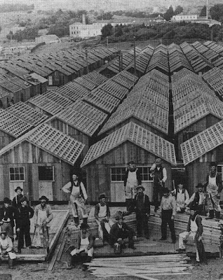

here's my grandfather building one his barns in Pontiac ? Capac ?, Michigan.....
about 1915 0r so.... he had a 1910 Indian Motorcycle and loved macines... but ther are no power tools on this job

Is he third from the right, in a white hat?
2d from the left , with a hammer in his handMike Hussein Smith Rhode Island : Design / Build / Repair / Restore
He was my second guess.
Don't believe him Piffin..Mikes just touchy coz his grandfather was a dwarf.
Nice pic of you and your family Mikey! I like your hat!
I knew you were old but I didn't think you were THAT old!
