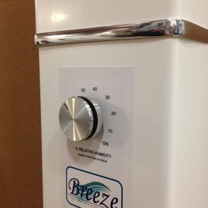

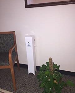

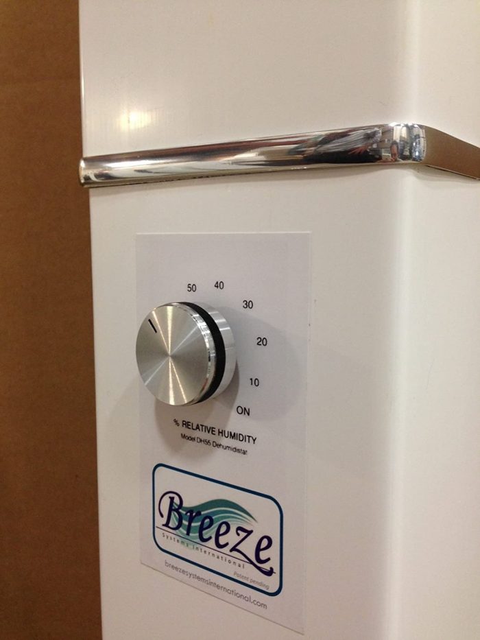

  3. jmmass | Jan 13, 2020 10:45am | #5
    Bob C
    5.0 out of 5 stars Amazing results from a unit called the Breeze, available online from Breeze Systems International at 1/4 the price of units like Humidex, Wave, and EZ Breathe- I was a non-believer, but am now blinded by the light!
    Verified Purchase
    I was 100% skeptical about this thing having any impact on my musty basement. I thought I was buying snake oil, but was at my wits end when it came to how to deal with the smelly basement on Cape Cod. We had a dehumidifier for years that would remove the moisture from the basement, but we would still get a "wet" spot on the floor at its lowest point and we had a musty smell that had us looking for ways to seal the basement door. When we would open all the windows and the bulkhead, we would get relief, and it would smell okay, but once we closed things up when it got cold or was raining we were back to a smelly basement.
    I installed this where our floor is the lowest and where we often would see condensation on the floor and have it venting out one of the basement windows that I adapted for the purpose with a vent.
    I am absolutely overwhelmed by the difference that this device has wrought - my basement musty odor is "cured" - it smells great down there and here is why - this little thing acts like a chimney of sorts, it pulls up the nasty moist air from the floor and shoots it out the window - and sucks down fresh air from the upper floors - circulating the air into the basement with fresh air, BUT also removing the worst air that is down near the floor.
    I couldn't be more shocked at the results this little device has delivered - amazing. I really thought I was going to be dissapointed as I thought "what on earth can this thing really do" but the answer is in the description - a dehumidifier gets the water out, but you still have the same stinky air in your basement - this thing really does the job and I could not be more pleased. I show everyone who comes into the house. My wife is also amazed - she used to dread going down to do laundry - now, she has no excuse!

  8. jmmass | Feb 11, 2021 08:36pm | #10
    Humidex makes a good product, but you can do so much better with a unit that uses the same principle, is at least the same quality, and sells for much less (nearly half the price), the Breeze DL. We have had one in our basement for almost 10 years. The entry level Breeze (single fan) has been selling on Ebay and Amazon for over 10 years. The Breeze is made of a sturdy plastic, so it doesn't rust or dent. Has no computer parts, which aren't recommended in humid areas, and is backed by a no-questions-asked 5-year warranty and full tech support. It's quiet, takes less space than a Humidex, and can be customized by the seller. It installs by using a simple dryer vent hook up, so it's a DIY project. Also, the Breeze is made by an American company, unlike Humidex. Check it out by searching for Breeze Systems International. You'll be glad you did.
