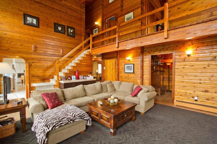

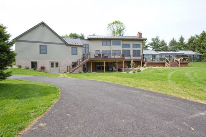

We are in the process of remodeling (not full gut) a 1978 log home. Think lincohln logs. No chinking. We have a central AC (4 ton) unit with a single zone. The house is 3500 square feet. The heat is a small part infloor radiant and the rest tube and fin hydronic. The heat and hot water are from an oil boiler. This is a 2006 Burnham unit.
There are significant hot and cold parts of the house. There is no AC in the basement.
I’ve had 2 contractors out. So far, one wants to put in a several minisplit units in the poorly served areas (mater BR, entry, and basement). This will also handle heat in this area as well. The second contractor said to place zoning units due to 14″ spiral ducting trunk lines and make the house 4 zones. Replace fin tube in the mBR. Add minisplit in the basement. The only similar line item was minisplit units in the basement.

      I would like to use existing if able, and one contractor says yes and other no. Currently, AC has 1 zone. Main level thermostat. Freezing cold in upstairs rooms, warm main level, and hot at the far ends of the house. No AC in the finished partially below grade walkoutbasement. Frequent short cycling. Heat is 4 zones, upper level, main level, and basement all fin tube base from boiler. Kitchen/mudroom in floor radiant on own stat.
      The house is located in PA with newer double pane andersons, and moderately poor insulation throughout house.

    Suggest you have the HVAC load calculations done. There is a lot of glass in that one wall, and that will have a major influence in heating / cooling. The calculations will let you know if the existing system is sized correctly and distribution needs to be fixed, or if additional capacity is required.
