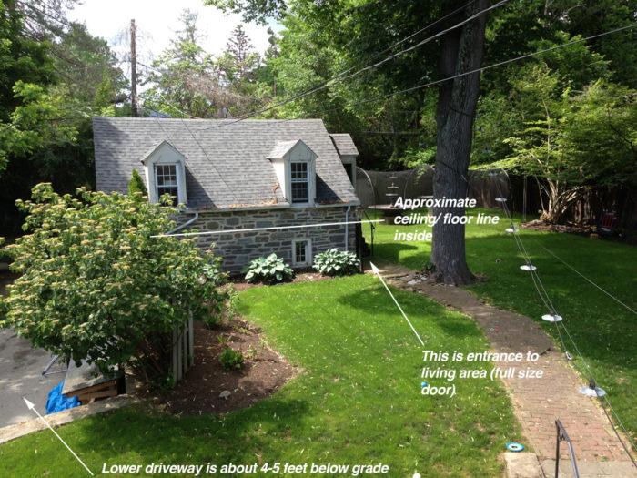

We recently moved into a 1911 big-old fixxer upper tha has a carriage house out back dating from the 1930s.. It was VERY disgusting with mold, critters, bad roof, etc. so we decided a complete gut job was in order. There is sort of a “T” shaped room and a half above the garage that could be used as a SMALL apartment someday, but probably more than likely a “clubhouse” for my two boys who are soon-to-be teenagers.

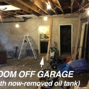

The old system I pulled out was a complely rotted oil fired boiler (most of the radiators had cracked due to freezing I guess). I had an oil company come and drain the sludge of the old tank and haul that away too (it was in a small room accessible from the garage but behind a door).

1) The garage has 2 rooms off of it’s interior.. one where the old boiler tank was, and another where a small bathroom is. As long as these two rooms are behind closed doors and separate from the actual garage parklng area, can I run ductwork DOWN from the apartment above to heat these spaces? I will also obviously be installing CO2 sensors in these rooms and in apartment above.

    Another A- LIST consideration for the project is moisture. Is there a great deal of moisture that will come up from the garage slab? If so, you will need to control that before you seal and condition the space above. From one of your pictures, it appears to me there is plaster(?) with peeling paint(lead hazard!). If you can feel the moisture there on a rainy day, reconsider where you put your reconstruction dollars.

      Thank you all for your responses! MyBuilder... 3 of the four (non door) sides of the garage are about 5 feet below exterior grade (there is an elevated yard (I've attached another photo that might shed some more light)). THe walls DO in fact get damp in area, and I'm aware there may be lead (I will test, but truthfully I think the paint is from WAY back in time). I was planning on eventually dry-locking the walls, painting with a nice epoxy-type paint and calling it a day, then finally makeing the garage "nice"... maybe even get some openers in there so we can use it AS A GARAGE! What luxury!
