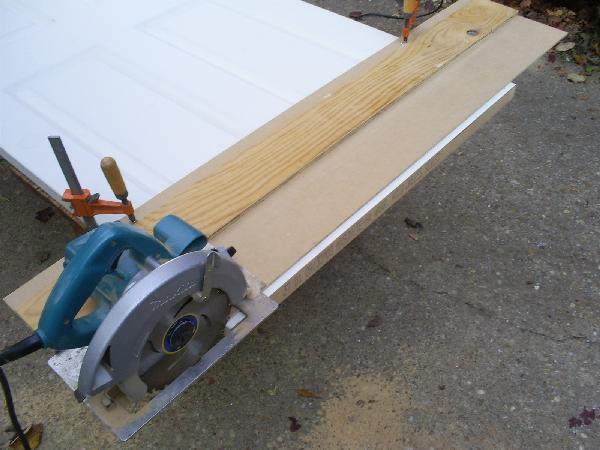

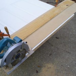

  8. stevent1 | Jun 29, 2009 10:18pm | #15
    Make a shooting board for your saw. 1/4" mdf and a rip of plywood. Leave the 1/4" "wide". Glue and srew throught the 1/4" into the ply. Run the left side of the saw foot to trim the sled. Then trim the small side with the right side of the foot.  This pic shows trimming a door blank.
    Put either edge on your line and you will get a good cut.
    Make your cuts upside down and the cuts will be splinter free.
    Chuck S
