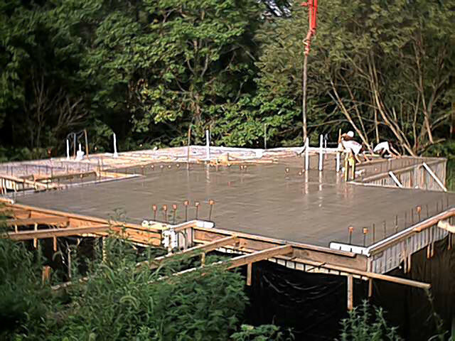

pretty cool.. i like the structural slab for the main floor.. kind of unusual , even for an icf house..

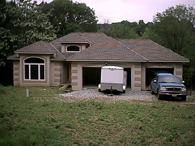

.....now... when ya gonna cut out the arch so your trailer will fit in the garage ?

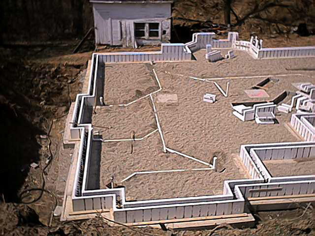

Beautiful and intersting, especially after reading about insulated foundations in the new FHB. What part of the world is this in? One thing I've wondered about: Is there ever a problem with termites and/or ants getting into the foam?

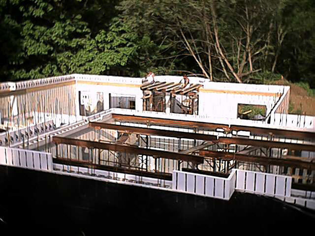

What brand of ICF is that?
Did you pour it in one lift?
DRC
we used ARXXX http://www.ARXXBUILD.com we did 2 pours for the walls
I saw what looks like steel supports to hold the first floor slab. I like that design, did you have a structural engineer help with that?

Structural engineer check the loads. and the place I rented the scoffolding ran the calculations on the scoffolding.
the insulated concrete floor forms were http://www.insul-deck.org
Does any house come with that garage?
