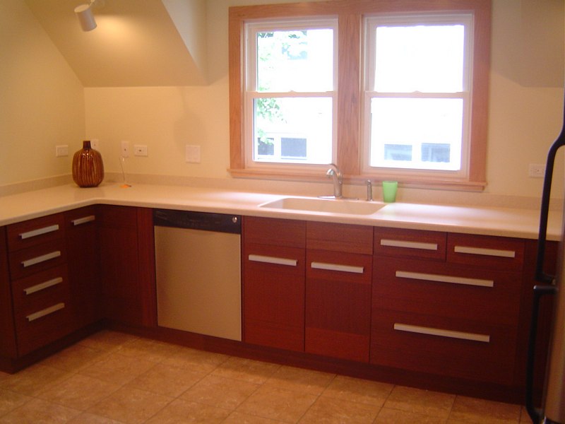

    1. bobo66 | Apr 05, 2007 06:35am | #9
      Forget the cabinets, I love that view out that kitchen window.
      1. dovetail97128 | Apr 05, 2007 07:09am | #12
        Beautiful isn't it. Hill top vineyard, for Oregon Pinot Noir Wines.

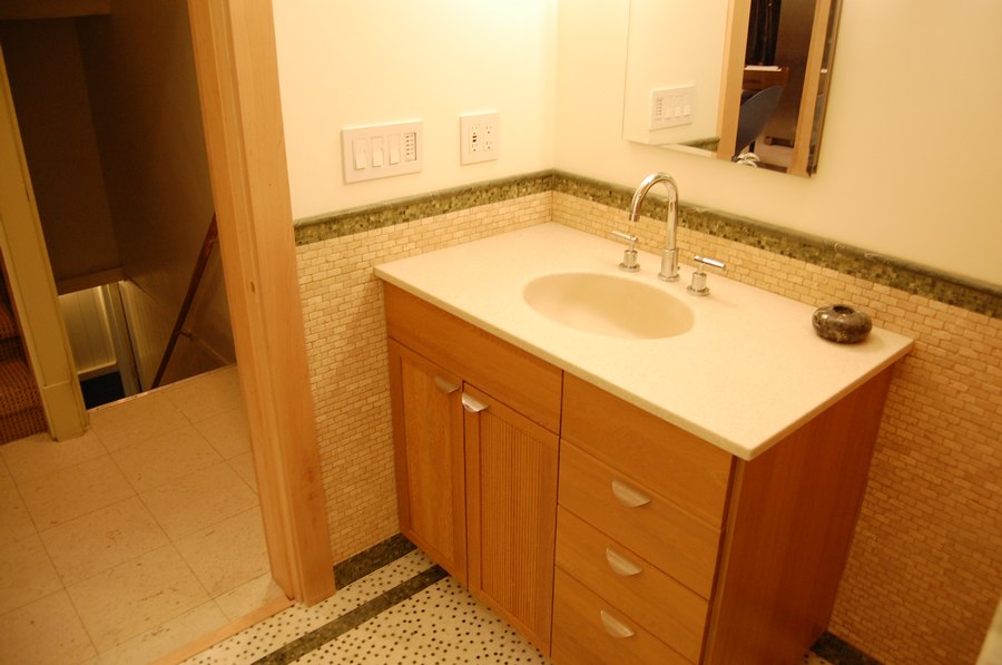

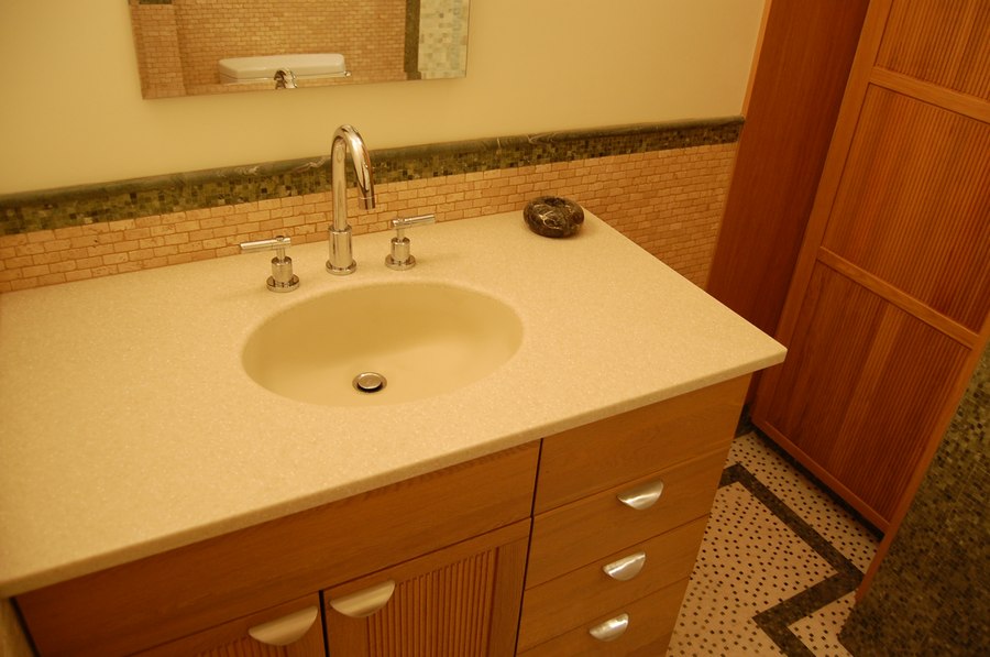

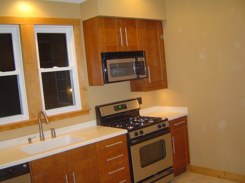

      4. paulwaterloo1 | Apr 05, 2007 06:26pm | #29

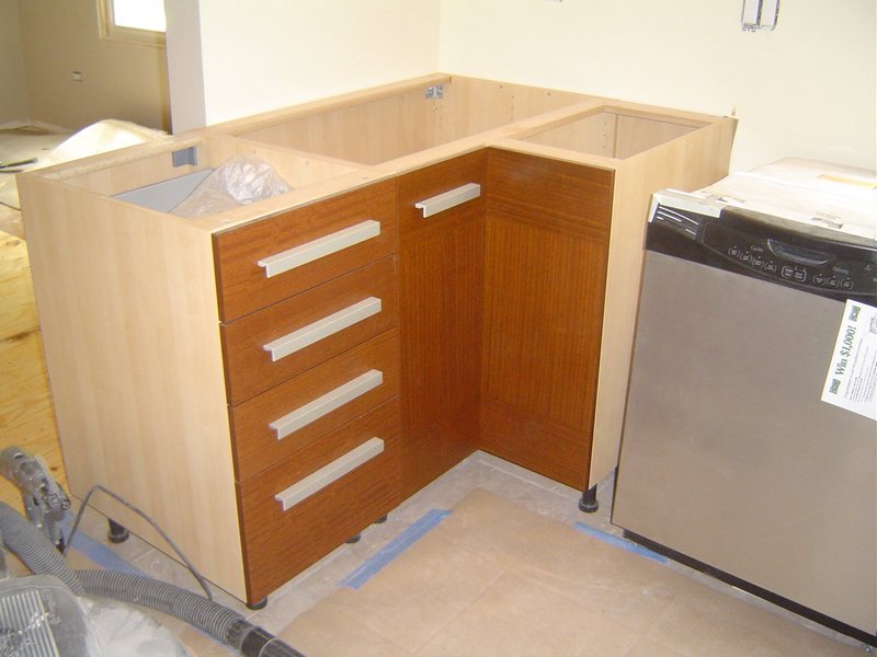

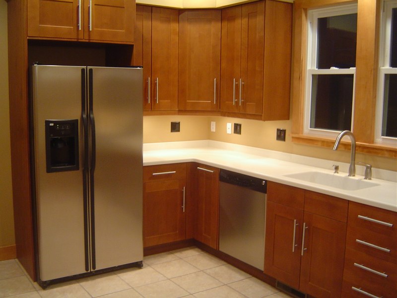

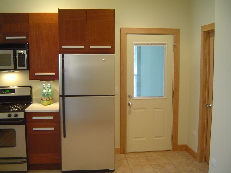

        I have installed two IKEA kitchens in a two flat building that I gutted last year and reconfigured.

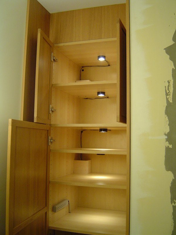

        Cost for the two kitchens below with cabinets, drawers, faces (everything from IKEA): $5500 or so. Cost for the two solid surface LG counter tops and sinks: $4800.
        They look great, I customized them with a few boxes, the way the upper cabinets mount is SUPER EASY. I am not a contractor, nor have I ever done a kitchen install before these two. I did it myself. Glue the pegs in, use a brad nailer to attach the back panels. The hardware BLOWS most low to medium cabinets away.
        View Image<!---->

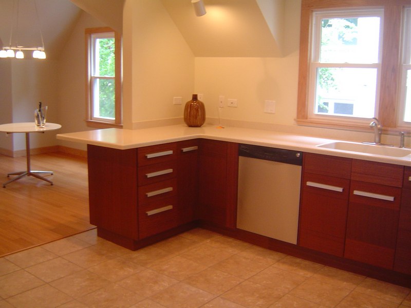

        Here is the second floor unit, it looks much better in person:

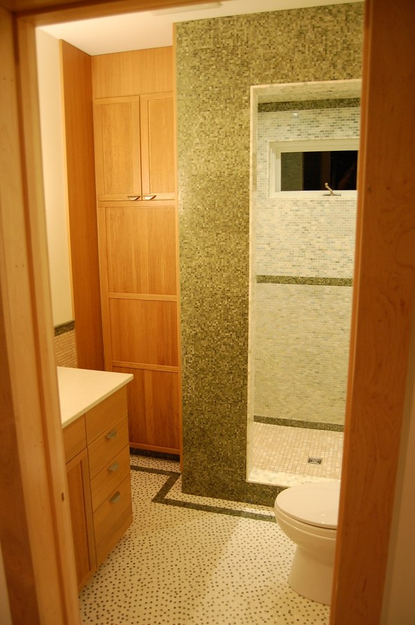

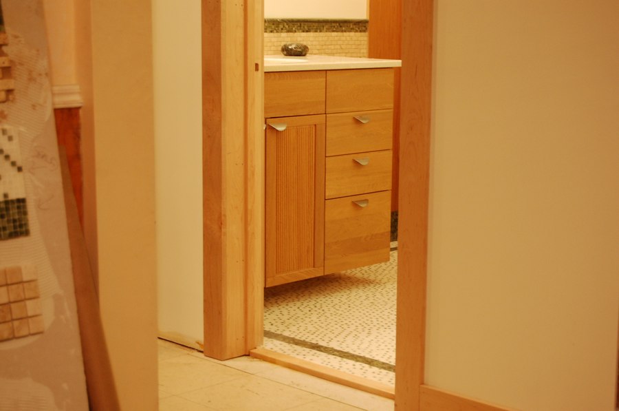

        I also just put some in my own house bathroom that I am just finishing up. I cut the vanity cabinet down 2" to make it 22" in depth versus the stock 24". You can go one extra inch. You have to cut it in the middle back and biscuit join it back together. I put these on 2x4's on the ground, the vanity support is in the middle so it appears to be floating. The wall panels are a fridge trim panel you can buy. The fronts of these are solid oak, the most expensive style. About $1100 for everything in the bath. A local cabinet place (Polish factory in Chicago quoted me $2800 for the same thing). I really like them.
        Edited 4/5/2007 11:29 am by PaulWaterloo
        Edited 4/5/2007 11:30 am by PaulWaterloo
        Edited 4/5/2007 11:31 am by PaulWaterloo
        1. dovetail97128 | Apr 05, 2007 06:53pm | #30
          Nice job! I like that style of fronts. Tried to talk my clients int it but they balked.

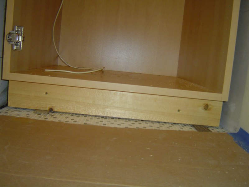

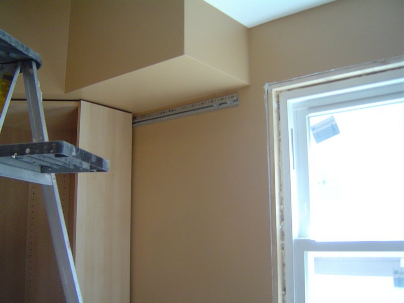

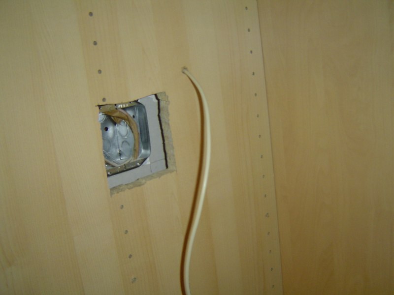

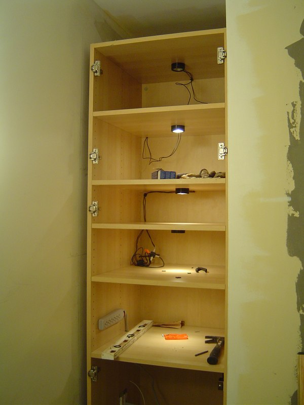

          3. paulwaterloo1 | Apr 05, 2007 09:18pm | #35

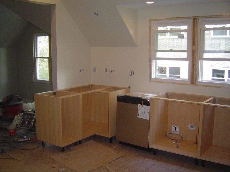

            Here's a few pictures of how I trimmed it out....on the left of the dishwasher there was a large opening, about 5-6"
            I put some 1x or 2x stock back there, made a small frame and attached a cut down side trim panel to it to fill the space in.
            The other thing I did that IKEA doesn't really tell you is that I put end side panels on each sides of the appliances, on the dishwasher and stove. You don't see the side of the cabinet at all.
            You just need to cut them in half and use half on each side, you only see the front edge, plus it allows for more clearance in the back of the appliance bay side to side if the wall isn't square.
            Here is one more trim panel I made for the 1st floor corner cabinet, you need at least 3" so the drawer can open....you can see the trim panels on each side of the dishwasher.

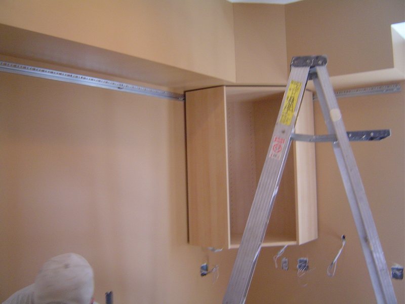

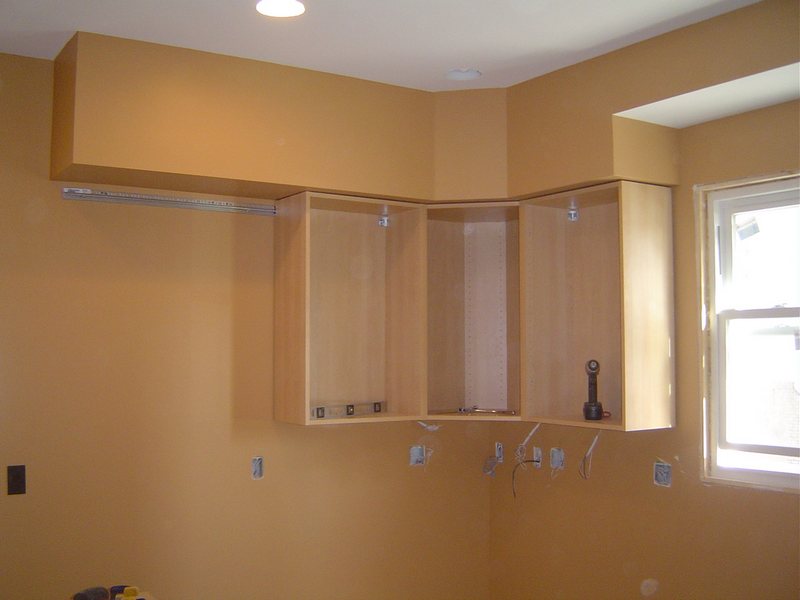

            Here's how you put the top cabinets up, you install a rail cut to just shorter than the cabinet width, slide two stud assemblies in for each wall cabinet, and you just hang them up there and put to nuts on the studs, very easy to do. The holes are oversized so you can adjust them up and down very easily.
