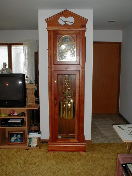

A clock I made for my dad . Cherry wood with Hermle movements . Since he has farmed all his life I made a small plow for the finial opening.
The side pillars are fluted but don't show up that way here for some reason. I put a small lamp in the case that puts a soft glow on the face at night .

Tell me about how you went about building that clock, also the finishing. That's a sweet project.
It was a spur of the moment type of thing . We were at my aunt's funeral and my dad was looking at the grand father clock in the hallway and he said that he needed one of those things. Well that was in Nov. and I had not gotten anything for christmas for him so I ordered the works . they arived 2weeks before Chrismas I piced out some cherry that I had stashed . I made the sides and back with raised panels inside and out . I used an ogee panel raising cutter . all of the cherry was rough cut air dry stock The finnish is satin poly . I did not stain any of the wood. It has aged very nicely over the the years (been 5 or 6 now) Any thing else you want to know just ask.
The plow was made from small scraps of cherry and the plow handles were soaked in boiling water for a couple of min. and then bent to shape the moldboard was made from a thin chrome steel sheet . It is simular to the plow that John Deere made in the shop at Grand Detuor ,IL in the 1800s. I did get the clock finished the day before Christmas

What is that on the rail just below the clock face. Is that initals AH or is it some kind of other symbol.
B J Boy I wish I had 1/4 sawn oak . This is the first grand father clock I made . I made a banjo clock years before and did not have the works . It is hard to find works to fit in a clock that is done withj out a plan ,I knew what I wanted it to look like , didn't think that it would be that hard to find the works to fit it. The company that I bought the works for the grandfather clock had what I needed . That is the reason I waited for the works to arrive before I started the grand father .
Bill , that is an AH and the little walnut bar has Papenburg in raised letters Those are my dad's initials . Don

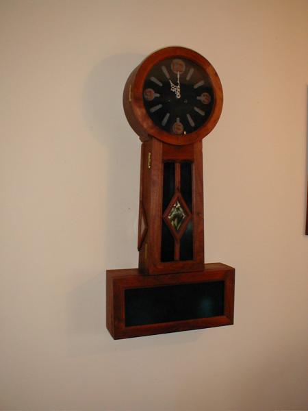

Thanks B J , I might try to make up a clock or two to sell. Just don't know where to sell them though. My banjo clock has a blue glass face with walnut numbers set in small sandblasted circles. don
Walnut banjo clock
