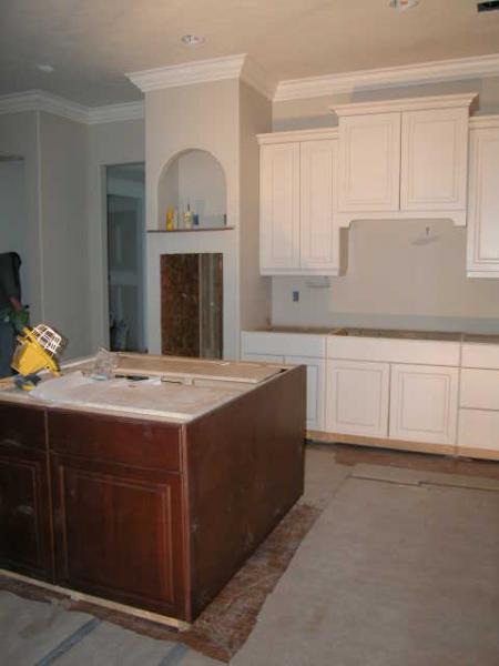

actually .. I’m not. Hate installing white (or off white as this one may be) kitchens.
spent last 2 Fri’s helping out a buddy. Got to carry lotsa vanities up way too many stairs … nothing much to take pics of .. just a bunch of off white vanities …
Here’s some of the kitchen. this past Fri I spent the afternoon running all the euro-crown. The island will be more exciting after he dresses it up with some applied trim moldings.

You know Jeff, I've always said this and I'll say it again ,you do nice work,for a republican.Vince Carbone
Jeff, very nice Kitchen indeed. I'm going to suggest that you get your eyes checked for colorblindness though, cause that island ain't white!

oooh.... i like white kitchens..Mike Smith Rhode Island : Design / Build / Repair / Restore
Jeff: I would consider your work very upper end. Always lots of detail and very well done. Your workmanship shows.

white is right
Jeff,
Were the undersides of those cabinets finished? The job I did back before the Holidays, the bottoms were maple thermo-foil - had to spray them ourselves.
Later, got to meet the factory touch-up man. He said "Throw that wax stick away." Turned us on to some aerosol canned lacquer he uses.

this is one of his kitchens. I just came in coupla Fri's ago to help hump the big vanities up stairs .... then went in last Fri and he was dumb enough to ask what I wanted to do in the afternoon after we'd finished up setting the rest of the cabs together ... so I picked running crown.
I hate white(or off white) .... get a miter so tight ya couldn't fit a thin slip of paper in ... and it still looks like it's fat/open with a "dark line" running down ... joints that'd look better than perfect in a stain grade still need hit with the wax fill stick ... then ... they're so tight there's no where to squish the wax into!
The runs were small enough on this kitchen that I pre-assembled all the "outside mitered sections" ... 23g pin nail with a little glue and lift into place as a unit.
faster ... better ... gooder.
That island ... yeah ... we were hoping it wasn't for the unit next door? Figured we'd nail it down before anyone else noticed?
Part of the insland couldn't be set till this last Fri ... had a central vac pipe sticking up .. had to wait for the vac guy ... guess what his name was?
ended up with 3 Jeff's in that kitchen at once ...
imagine the brain power at work!

Maybe it's just the picture, but it would appear the the one corner of the island is 1/64" out of level.

If you'd wash your hands more the white cabs wouldnt be such a problem.
Nice work though.
what I really like about them is ya really can't take a nice sharp pic ...
something about all that white(or off white) confuses the camera and no matter how mard ya look .. ya can't tell if those joints are nice and tight or a mile wide open.

Looks very nice, fits in the kitchen nicely. What kind of countertop would he be putting on? How about lighting? (Sounds like wouldn't need that many lights!)
