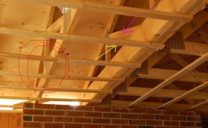

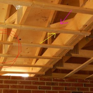

        1. mikerooney | Mar 07, 2009 10:04pm | #6
          In the last pic, you can see that the framin' switches direction.
          I wonder if they turned the board there also.There's only so much a finisher can do with a bad hang or frame job.More pics would be helpful.On a service call a customer complained about a humped joint on the M brm ceiling. What he showed me was actually a shadow in the center of the board, two feet from either joint.I tried to tell him this, but he insisted that I "fix" it.

          1. ruffmike | Mar 08, 2009 12:43am | #8
            I wouldn't be surprised if there was a big crown where the trusses change direction.
            Zano's right also. The man doing the strapping should have straightened it out, although it sounds like the same crew did the whole job. Personally I would have used RC1 channel and shims.

      4. JTC1 | Mar 10, 2009 05:03am | #22
        Is it just me, or do these truss centers look mighty wide - like 32" oc?
        I am looking at the first photo and comparing what I assume is a 4" octagonal electrical box to the truss / strapping spacing.

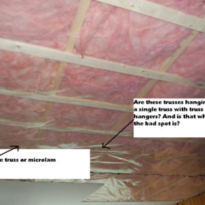

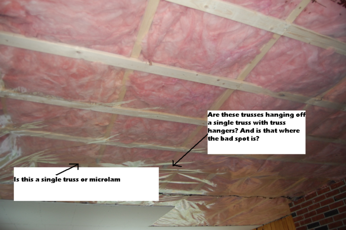

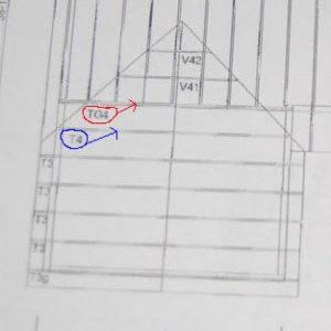

          1. Framer | Mar 10, 2009 06:15am | #23

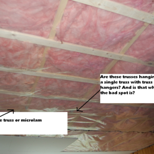

            Is that a single truss going one way with truss hanging off the with hangers going the opposite way And is that where the bad spot is?Joe Carola
          2. Piffin | Mar 10, 2009 06:32am | #24
            You guys are starting to see it all too, eh? She got taken by a hack outfit, no doubt.She may be a bit particular, but her red light only came on when these guys started screwing her.but she's smart enough to still have the money in her own pocket
          3. Wanda200 | Mar 10, 2009 07:58pm | #26

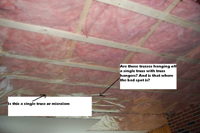

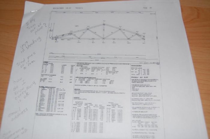

          4. Wanda200 | Mar 10, 2009 08:01pm | #27
            Hi guys,
            Thanks Piffin for taking the time to search through those posts.
            I have a couple of ?'s for you concerning the roof.
            #1. Can you tell from looking at the pics that the trusses are up and down and should have been shimmed? (Joe Carole mentioned that in his post # 117517.14)
            #2. Who is responsible for inspecting the progression of the work the customer or the contractor? Should I have had an inspector come in to inspect the roof before letting the roofer install the sheetrock and insulation/vapour barrier? I remember asking the had guy this ? and he assured me it wasn't necessary and he had checked the roof and it was fine.
            Now how would you define microlam?
            Should I be concerned not only about the strapping but also the trusses?

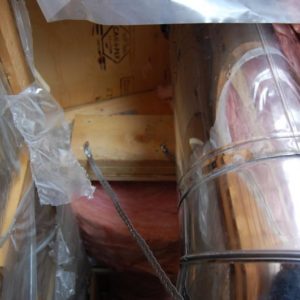

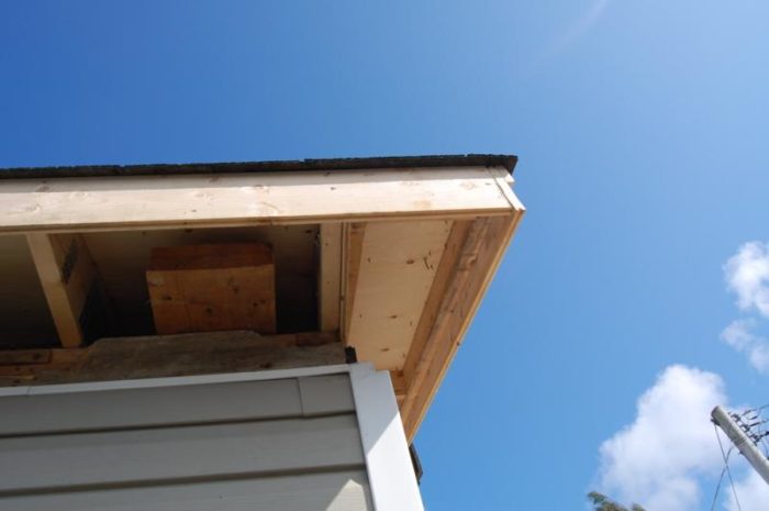

          5. Wanda200 | Mar 10, 2009 08:44pm | #28
            Hi,

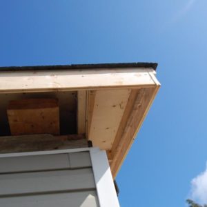

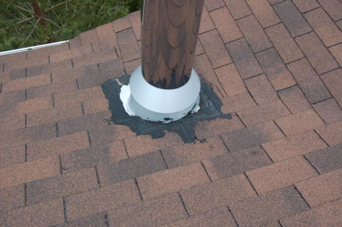

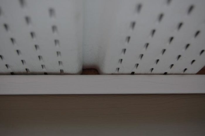

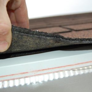

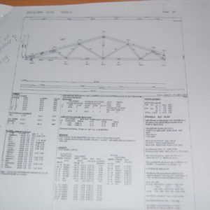

            Here are a few pics I managed to dig up from my collection. PIctures of the new roof before any insulation was installed.
            Wanda

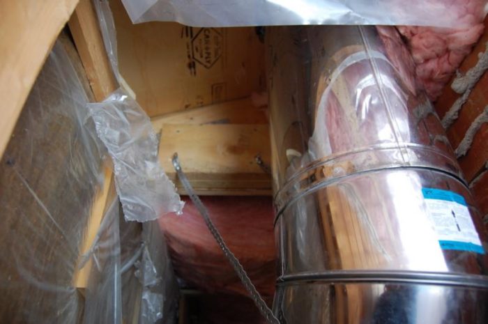

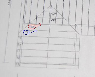

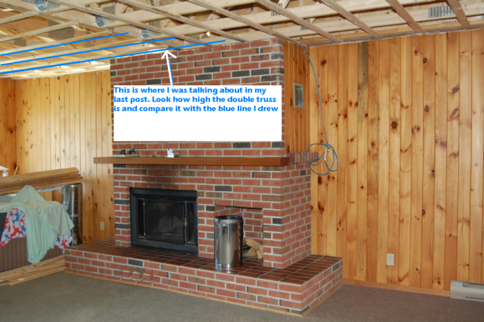

          6. Framer | Mar 11, 2009 12:11am | #31
            Wanda,
            I just noticed in this picture that you don't have a double truss that holds up the perpendicular trusses. You have a single truss with a 2x6 bottom chord and what may be 2-2x6's nailed to the truss with the perpendicular trusses hanging off those. You can also see how that truss with the 2x's nailed to it goes uphill with the strapping.Joe Carola

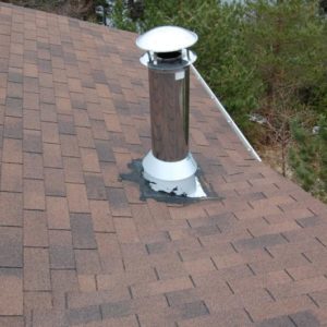

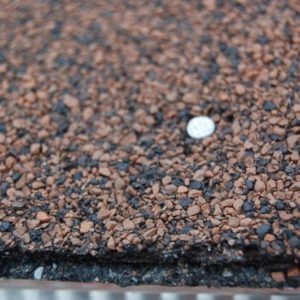

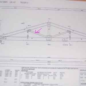

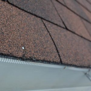

          7. Piffin | Mar 11, 2009 12:17am | #32

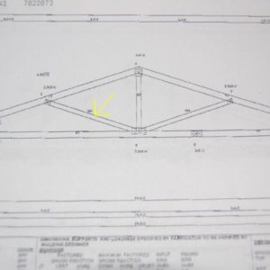

            OK, I see more here in these photos.in this one
            http://forums.taunton.com/n/docs/docDownload.aspx?guid=0FA183CD-2BDA-4FF6-AFC1-7D2CB5ACD452&webtag=tp-breaktimeyou can see the answer to Joe's question. There is a tripled truss to hang the alternating direction ones off of. That is good. I think he was concerned that they may have shorted you a bit and hung off a single.But this photo also shows a major sopurce of your problem near the FP there. See how they broke all the joints of the strapping on the same truss? and how short those are there. It is a basic principle that carpenters learn right off the bat is to change location of those joints so stress is spread across a larger area. By conentrating the joints, they concentrate the stresses and amplify problems.In other words, they caused this finishing to be bad by doing amateur carpentry there. On the opposite side of the trippled truss, they could have run beyond with strapping also to spread loads and stressesSo far, I can't see much more of the nails in strapping except that most of it does appear gun nailed rather than roofing nails, but still only one nail per connection ....still downloading last three photos....The only other Q open in my mind is what kind of nails were used for the hangers to secure the alt direction trusses to the tripled. If you have that opened up again, the hardware is stamped right on it which nails are required. Somebody on site might be able to identify which were used. sometimes hacks use roofing nails for that too since they are easy to get in.

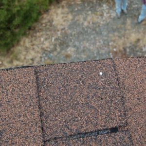

            But think about it, roofing nails designed to resist some minor wind load s in less than a square foot area used to hold hundreds of pounds of loads....not good. I am suspecting this because the guy was a roofer first. He had roof nails in his pouch handy. He used them to nail up some of the strapping....He was ignorant which way to hang crown molding. He was ignorant how to place strapping. So he may very well be ignorant what nails to use in the truss hangers. you may be able to help educate a hard working ignoramus and better his life.
          8. Piffin | Mar 10, 2009 11:51pm | #29
            I haven't seen anything one way or the other to make me have an opinion on the trusses. The guy might have been a perfectly adequate roof and framing contractor.I would be very concerned about taking a good look at the strapping when this SR is replaced. Id it is as appears, the strapping is hung with only a handful of roofing nails and while it is unlikely to fall down on your head to hurt you, it will also not be likely to hang tight forever, so as some of it comes loose while other spots hang tight, more and more waviness will appear. There is also not enough strapping, so the SR will sag between the ones that are spaced too far apart.I hang it nor more than 16" OC and nail with two 8d ring shank nails at each connection. Could be two 6d at each in some cases, but not for you.Reason I call your nailing roofing nails is the large heads showing in your recent photos of plastic and FG insulation before SR went up. At least half the nails were those large headed nails and in only one place did I see a pair of nails.Inspections?IMO Both. The HO needs to protect himself.

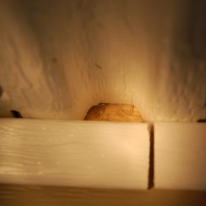

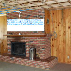

          9. Wanda200 | Mar 10, 2009 07:47pm | #25
            Hi Framer,
            The area near /just in front of the fireplace is the worst. The area near the Large window happens to be the best. With all that light shining through that part of the ceiling is perfect. It's just before you gett o the fire place where the rest of the job deteriorates.. as you look down towards the backwall.
            wanda

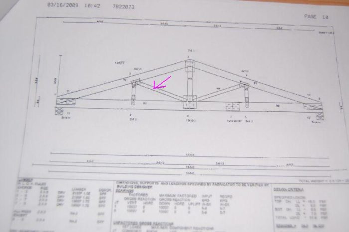

          10. Framer | Mar 11, 2009 12:02am | #30

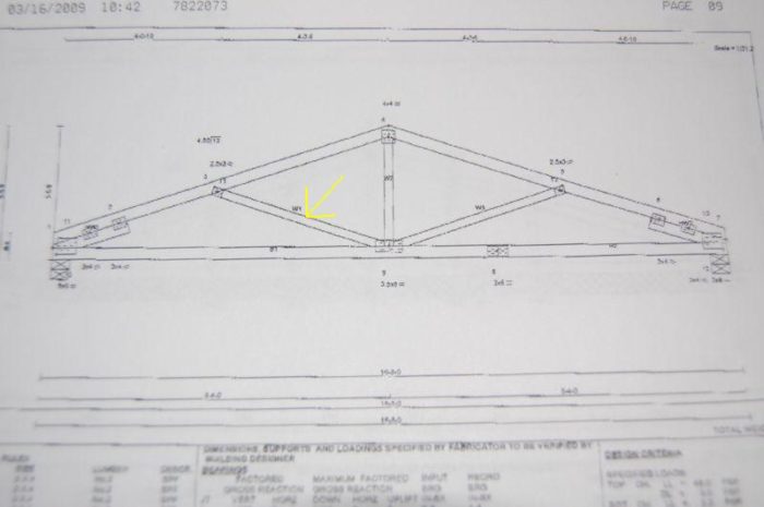

            This is where I was talking about in my last post. You can see where the double truss and the other trusses that go perpendicular are higher. You can see your strapping going up hill where it nails to the bottom of the double truss. Maybe my eyes are wrong and it's hard to tell from the picture.Joe Carola
          11. Piffin | Mar 11, 2009 12:27am | #33
            Yowsah!I was just counting bottom surfaces and didn't notice that trick. I saw the sloppy strapping and tilting uphill and wondered why that truss might be seated higher and all, but had myself thinking it was a tripled truss.
            This company better be ready to show the truss plant design engineering to show that scab job is kosher, That one might be moving from excessive load under varying snow loads all winter and causing her troubles.
          12. Piffin | Mar 11, 2009 12:30am | #34
            http://forums.taunton.com/n/docs/docDownload.aspx?guid=3399AE16-44CB-4492-AE39-4F1E8EBA90C3&webtag=tp-breaktimeWait up - this one makes it appear there is a sister truss behind that one. and higher seated. I can't tell for sure.

  6. Piffin | Mar 11, 2009 01:24am | #35
    Joe, I think I see a part of the problem there. After missing that one call, I kept studying the last photo I relinked. Trying to see what it was that I knew was wrong there...
    see that one truss sprayed red and marked TG-4 two ply?
    it is one ply where it sits and has a 2x6 bottom chord and gabled end web pattern. The other red I see is one the one I mentioned that seems stitched to the one the alt direction trusses hang onto.
    So it appears to me that the two red marked ones with 2x6 bottom chord were intended in the design to be a twin to hold the attached trusses. The guy got things out of order or ignored the design plan and then when he discovered his error, he decided to make up for it bu sistering another 2x6 to the back side of the bottom chord.
    So the alt trusses hang from the wrong truss and the design was ignored and then not fixed properly. The two that are tied together, probably move differently under load so the whole structural frame is sighing up and down there and giving the sheetrock a challenge.
    Structurally, it would probably never fail catastrophically, but because they did such a sloppy job with the strapping, they are amplifying things instead of spreading it out to be un-noticeable.
    I'm sure glad I'm not the "contractor" on this one! I'd have to wait for whatever the judge let me have for pay, or I'd have to start by getting an engineering repair order from the truss plant.
    I wonder what Boss Hog would have to add in this thread. He is probably itching to get back to work and turn his mind back to trusses again.
    1. Piffin | Mar 11, 2009 01:27am | #36
      calling your attention to the last 7-8 posts in this thread and photos of the trusses and comments from Joe and myself. See what you think.
      1. user-58963 | Mar 11, 2009 02:08am | #37
        I think this not was meant for someone else.
        1. Piffin | Mar 11, 2009 06:43am | #40
          No - for you. Discussion about trusses in previous few posts.

          9. Piffin | Mar 12, 2009 01:05am | #57
            How serious of a problem it is would depend on the review by a truss engineer. There are ways to beef up a truss system from under the roof once in place, but would have to be specified by said engineer. Looks like Ron is giving some professional curtosy to the guys on the ground who designed it by staying out of the way.But one thing to keep in mind is that the engineer who designed the trusses and who looks at them, will be viewing with load bearing in mind - whether it will fail structurally or not.He may or may not be considering the way these move in cold. There is a phenomenon called truss lift, and your alternating pattern may make that more of a problem. The situation you are dealing with re keeping a flat ceiling will still have to be smoothed with proper strapping after you are assured that the truss system is sound.

          11. Wanda200 | Mar 24, 2009 02:41am | #59
            Hi guys,
            This has certainly been a renovation from hell. The saga continues.... went up today to meet with my new contractor only to discover other "deficiencies". A potential fire hazard!
            I have yet to pay my bill. the men I hired to redo the ceiling began tearing down the drywall today in the main room. wow! Now it appears the fireplace wasn't secured. They didn't install any brackets and the only thing supporting the elbow (metal tubing was a small chain attached to a screw.... ) My new contractor told me the support wasn't adequate. He now has to install a proper bracket. (this is slowing down the work) When we took a closer inspection we could see the  insulation (pink fiberglass) hanging down and there was one area with no insulation and no drywall. That helps explain why the fireplace wasn't giving off enough heat. But it's the debris  around the base of the shield that's got me riled up. bits of broken drywall and wood. Talk about a fire hazzard! No doubt that came from the old roof when it was taken down. I wonder if the flasing is up to code..hmmmmmmm

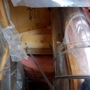

            Anyways a picture is worth a thousand words. I will post a few pictures of the fireplace when I get them downloaded. That way you'll be able to see what I'm talking about. Make a short story long.. I'm lucky this was discovered now. Had I decided not to take down the drywall and start over I would have never discovered this "fire hazard". My contractor also pointed out that the hole cut around the metal tubing wasn't up to code. There was no 2 inch gap all the way around the metal tubing. This information was clearly written on the metal elbow. Very shoddy work.
            So now the contractor has to examine  the roof from outside. He will also crawl into the attic to check things out. Hope I'm not in for anymore surprises.
            I found out why the plastering wasn't up to scratch in some areas. If you look closely at the picture you will see that that metal hangers on the truss are hanging slightly below the chord of the other truss. Plus there is a piece of strapping perpendicular from the middle of the fireplace that wasn't nailed in place. The end of the strapping was just hanging down resting on top of the brick fireplace. Hard to see that from looking at the picture. Is it that time consuming to scew a nail into a piece of strapping. Those guys took short cuts! They also skimped on their nails. Only one nail attaching the end of the strapping to the joists. You guys were right about that.
            Wanda
          12. frammer52 | Mar 24, 2009 03:48am | #60
            Wanda, the amount that is hanging down, should not affect the drywall as it was attached to strapping.
            Did you have the trusses inspected while the drywall was down?
            What effected the drywall was the way the strapping all ended on one truss instead of radomly ending.  By doing it this way you cause any imperfection in the height of the trusses to potentially cause it to telegraph in the drywall.
            Edited 3/23/2009 8:50 pm ET by frammer52
          13. Wanda200 | Mar 24, 2009 04:24pm | #61
            Hi Framer,
            Yup, the joints needed to be staggered.So the guy who installed the strapping did a shoddy job. Nothing that can't be fixed though.

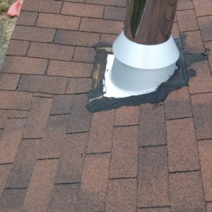

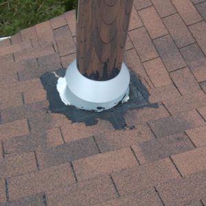

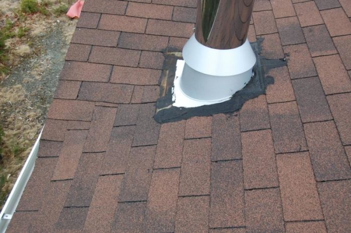

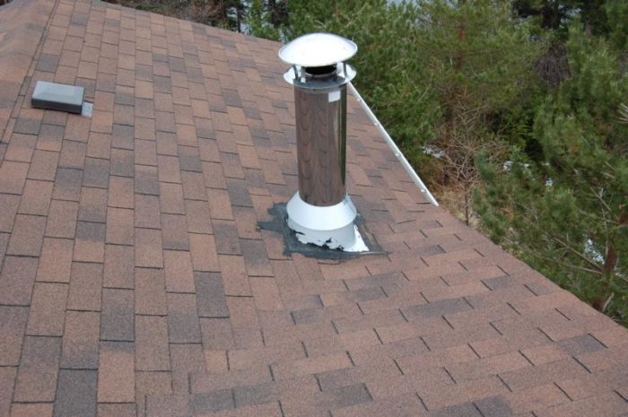

            Framer maybe you can tell me how you would fix a chimney problem. According to code There needs to be a 2" clearing all the way around the chimney pipe. Notice the guy didn't cut out a circle he cut a square opening. How can this be fixed without damaging the shingles? reciprocating saw?
            Here are some pics of behind the fireplace. You will see lots of debris that was just left around the metal shield.. if that's what it's called. On the left hand side you will notice that there should have been a sheet of drywall installed over the insulation. The only thing supporting the metal tubing is a small chain just screwed to a piece of wood.
            Wanda
          14. frammer52 | Mar 24, 2009 04:38pm | #62
            You need to hire a person that installs these fireplaces.  Is that an insert?
            I know you need a thinble or something like that to go through a roof or wall.
            ps. The original framer is Joe, this is the other Frammer, Dave.  Just do you don't mix us up>G<
            Me thinks you have a big mess!  I have installed hundreds of roofs with trusses and they always required bracing, which I haven't seen.

          19. Wanda200 | Mar 27, 2009 01:21am | #67
            Hi guys,
            Yes, I'm wondering that myself.. how did it pass inspection???? That is the ? of the day.
            Dave, you were wondering about the bracing.. What type of bracing are you referring to?
            How are the trusses attached/secured to the roof? what type of fasteners are used?
            I asked the new contractor about the trusses. Mentioned the 2 ply possibly being out of position. He said the trusses look ok. I also gave him the architecual drawings from the truss company. He said he'd check for any problems. He will go up on the roof and take a look in the attic.  A mason will come in to have a look at the chimney.
            Need you guys to take a look at these pictures and tell me if the gaps in the sheathing are normal.
            Wanda
          20. Wanda200 | Mar 27, 2009 01:30am | #68
            Hi again,
            It appears that the chord on one of the trusses is damaged. Probably not enough to compromise it though(you can see that pic in the previous post.
            Unfortunately, I can't find the picture I was searching for . Oh well, these will have to do.
            As far as inspections go.. I was just assuming the company would take care of all that. They would carry out the necessary inspections. Not so in my case.
            Wanda
          21. Framer | Mar 27, 2009 02:16am | #69
            Call the inspector and tell him to come out and inspect everything since this must have been closed up without inspections.
            Whoever you got to do the now work has to stop right now and let the inspector go in there. They can't continue until you have your trusses inspected also. Wasn't the permit hanging in your window?
             Joe Carola
          22. User avater
            BossHog | Mar 27, 2009 03:20am | #70
            The damaged truss looks to me like it needs some attention. But it's hard to tell for sure because there's a shadow halfway over the damaged area. I'd suggest calling the truss manufacturer to ask them to take a look. Their butt is on the line too.

            Wanda200 look at the tag on your pipe for the chimney. See if it has a mfg name on it. It was probaly Selkirk if you go to their web site. http://www.selkirkcanada.com .
            They should be able  to help wit you chimney.Also as others have said those trusses
            are not braced.

          25. Wanda200 | Mar 27, 2009 04:08pm | #73
            Hi,
            Just finished reading an article online about truss erecting and bracing.
            Here's what I discovered.
            Trusses have very little strength laterally
            Temporary truss bracing is required until trusses are all secured.
            Top chords are susceptible to lateral buckling
            Possibility that all webs could buckle in the same direction, so permanent cross braces should be added to the longitudinal stiffeners at each end of the building.
            Similar permanent longitudinal stiffeners and cross-bracing are required for tention web members (8ft) and longer. In case of stress reversal(wind uplift)
            Now the trusses are attached to the ext walls using framing anchors or bolt thru truss.
            The article also mentioned a knee brace .. is that temporary or does it have to stay in place.
            I also read that webs provide bracing as does roof sheathing.
            Wanda

            mgard38 | Mar 27, 2009 04:20pm | #74
            The trusses should have 2x4's from the gable back to the first truss.Also 2x4's along
            the bottom. Your truss company usually provides drawings for this. I would go to your local lumber yard and see if they can have their truss mfg inspect these trusses for
            you. Also did the info I gave you about the pipe help?

          33. KHWillets | Mar 28, 2009 08:18pm | #83
            The chimney should probably be supported where it goes through the roof sheathing, and by braces if it goes above a certain height (check the manufacturer's instructions). Do you have a pic of the chimney above the roof? At the ceiling plane there's sometimes an insulation shield that's required to keep the ceiling insulation from leaning against the pipe. You don't have a ceiling there, but you might want to rock around the pipe (with 2" clearance), install the proper ceiling fitting, and insulate it. Otherwise it looks like you'll have cold air behind that brick facade.I'm not an expert, just someone who read all the manuals when we put one in :).

            Wanda, Wanda, Wanda....My Dear Sister Wanda....heavy sigh....Mixed review here, but I don't see any reason to pay this original contractor unless a judge tells you that you have to.Where to begin...I guess first to put your mind at ease - that nothing that can't be corrected, but the more I see from your photos, the more I see wrong, so you really need the services of a home inspector even if you pay him yourself. Based on what has unfolded here in your winter saga and the pictures posted, I have little doubt that there is more wrong that I haven't seen.gaps in the sheathing - there should be gaps of about 1/8" to 3/16" but never more than 1/4" shingle manufacturers equire that any gap of 3/8" or greater must be patched with metal well nailed at edges. I cannot tell from your photos for sure, but it does appear than one of the gaps is on the order of a half inch or so.The chimney flue - several things. The support is not a chain but a support strap. In some cases, this is enough. iN others it is woefully inadequate. Does the installation allow the pipe to swing side to side? or does it support the pipe and not allow movement?As the chimney flue passes through the ceiling plane, many jurisdictions require a firestop spacer. Some do not.
            Here is the theory behind it - if a fire starts in the firebox area in the lower 8' behind the brick wall, the way you now have things configured, that fire can easily spread intot he rest of the attic space and have the entire roof on fire before a sleeping person in the next room is aware of any trouble. so a firestop of sheetrock or metal or a combination is used to prevent air flow up from this chase into the attic at the same plane as the ceiling sheetrock.The BRICK WALL - I only now see what sort of wall that is - a single wythe unsupported veneer. a true brick wall would have a minimum of two wythes ( layers) of brick making it at least 8" deep. What I see is 4" deep making it a veneer only. A good kick could knock it over. A minor earthquake could knock it over. A high heat source could crack the mortar and cause it to fall over. It has NO lateral strength at all. It is a pile of bricks balanced with gravity in line holding them inplace. The correct way to build this fireplace chase is to frame a wall with 2x4s and sheathing, then lay up the brick in front of it, attaching the brick veneer with masonry ties to the structural support wall behind it. I find myself wondering if there is a foundation system under this pile of bricks capable of supporting the weight of it. If not, the floor will sag, then the wall will lean, and eventually fall. Will it fall on somebody? or just make a big noise and pile of dust? You need a PE engineer or a capable experienced inspector to see what the extent of your worries is in this regard.back to t he chimney flue - none of that plastic should be vaguel;y able to cantact the piupe. The FG insulation should be 2" back from it as well. That is the purpose of a shield.A good roofer can remove the jack flashing and cut the roof sheathing back a bit further to maintain that 2" space up there and re-install the jack with little trouble. Most of the time, that would be the least of your troubles, but since you will be renting this place, you have little control over how safely residents use the fireplace. Most inexperineced users will overfire it, IMO.Unless there was a lot of kindling on the firebox, that debris was normal and no concern, other than for cleanliness. What I saw was all masonry debris, not combustibles, and not a danger.Truss bracing - I do see bracing there, but I do have the concerns I expressed earlier and that you can only determine with a visit from the truss maker.Roof edge trim - has got to be some of the sloppiest I have ever seen, but it it is covered with AL or Vinyl, I suppose it is adequate, or will be. But as shown in the photos, I could do better when I was 16 YO.I feel for yah - sorry I just now saw this thread come up again. my radar must have been tingling - I was thinking about your case a few days ago.

          39. Piffin | Mar 31, 2009 06:39pm | #89
            That girder out of position is probably what I was seeing with the red paint and markings labeling one of the more unique trusses with a 2x6 bottom chord as one of two or two of three or whatever.Just go with what their engineer says and follow up to make sure it is done the way he says. There are a lot of potential ways to fix this and he will see more on site and know more about the situation than anybody here can say based on the photos. He will know his own product and will have the liability on it.Don't go thumping him with that fact though. Just ask questions and take notes and photos. he'll get the hint, and already he sounds far more professional than the hack would did this work.

            Hi Piffin,
            I have one ? for you.... this guy says he doesn't have to go up because he can clearly see by the photos what the problem is.
            I really think he should go up and have a look. I wouldn't be surprised if he discovered other things that the pic can't possibly show.
            For instance how about the anchors used to fasten the hangers to the trusses..hmmmm
            Wanda
          41. Piffin | Mar 31, 2009 07:35pm | #91
            That one may be outside of what he feels is his extent of liability so wants to keep hands off.Things like that are where I recommended it would be best to hire a local experienced home inspector to see how all the various systems tie together.Say your town again? Maybe somebody here at BT is close.
          42. User avater
            BossHog | Mar 31, 2009 07:46pm | #92
            I don't really know what to say at this point. I don't know what they mean when they say that "the girder is out of position". I didn't see anything obvious from looking at your pictures. I would still suggest pushing for a site visit if there are questions about what's been done. But you don't really have any leverage to force them to do so. I'm still up for reviewing anything about the trusses you can get in PDF format. If you ask the truss company for truss drawings and a layout in that format they may be willing to email them to ya. I can give you an email address if you don't want to post them here. .You mentioned truss anchors in a post to Piffin. In many places they simply aren't required. The only thing they do is hold the roof down in hurricanes or tornados. They don't affect the performance of the trusses at all.

            I think I know which picture you mean. To me it looks like a girder truss with a 2X8 nailed to the back face of it. But it's hard to tell without more pictures or visiting the jobsite. That's why I keep suggesting a jobsite visit from the truss company - They won't want the liability of knowing that something was done wrong, and will likely make some effort to see that it's corrected.

          45. Wanda200 | Mar 31, 2009 09:50pm | #95
            Hello BossHog, I have taken pictures of the architectual plans I was given. Now it's only a photocopy. The print is very difficult to make out (miniscule) I took pictures of the photocopy and will post them here. Not sure if you'll find the pics helpful but who knows. So I will post them just in case.
            wanda
          46. Wanda200 | Mar 31, 2009 09:53pm | #96
            Hi,
            The rest of the pics...
            wanda
            Edited 3/31/2009 2:53 pm by Wanda200
          47. Wanda200 | Mar 31, 2009 09:58pm | #97
            hello,
            not sure if I posted this pic. Page 5 architectual plans
            Wanda
          48. User avater
            BossHog | Mar 31, 2009 11:18pm | #98
            O.K. - That helps a lot, and I think I know what happened.
            Take a look at this drawing - This is the layout, or plan view of where the trusses go. Note where I've circled the "T4" truss (Blue circle) and the "TG4" girder truss. (Red circle)
            This appears to be a drawing of the "T4" truss. Note the web indicated by the yellow arrow - I'll refer to it later.
            I beieve this truss is "TG4", which is a girder truss. Two of these trusses should have been nailed together to hold up the end of the "T2" trusses. (I didn't post a picture of the "T2", as it's not relavant to the problem)
            Note the web indicated by the purple arrow.
            Now take a look at this picture which you posted earlier. I believe the web with the yellow arrow in this picture is from a "T4" truss. That truss should NOT be there.
            The purple arrow appears to point to a web from a "TG4" truss. Then there's a 2X8 nailed to the back of the bottom chord, so we can't see much of the truss.
            If you look at where I made the red circles, that's a large plate from a "TG4" truss. That's where truss "T4" should be.
            Here's my theory of what happened.
            Someone put a "T4" truss wheere the girder "TG4" should have been, and hung all the "T2" truss from it. Once all the bigger trusses were up, they figured out that they had screwed up. Instead of fixing it, they decided to add a "TG4" truss to the "T4" truss and add a 2X8 to the back side of the 2 trusses.
            If you're there again, can you tell me if the hangers are nailed to a 2X4 bottom chord? I'm almost sure they are, but would like to double check.
            I've seen this happen before, usually with rookie framing crews. unfortunately It won't be easy to correct. They may want to put a beam under it, replace the girder truss, or something like that.
            I'd sure like to know what kind of fix they come up with...
          49. Wanda200 | Apr 01, 2009 12:56am | #99
            Hi BossHog,
            I should give you a Huge HUG!
            Thank you for pointing out those errors. the red and purple marks really help. Too bad I don't have more pictures of the trusses.
            So they have screwed up! Now as soon as I hear back from the truss guy tomorrow I will let you know what he has to say. I'm dying to find out how he's going to solve this problem.
            ? is should that roof come down????????? They are charging me top $ for that roof. Why should I except an "altered", fixed roof. Hell, I've waited 7 mts now so I really don't care now if it takes them a month to put a new roof on the structure.  But reality is they probably will just do a fix it job and charge me the full amt.
            Next time I head up to North River I will find  out for you whether or not those hangers are nailed to the 2X4 bottom chord.
            Thanks again BossHog for taking the time to look over those pics. :) I really appreciate the time you guys have taken to help me with my reno ?'s. Thank god for the internet!
            Wanda

          51. Piffin | Apr 01, 2009 01:18am | #100
            That is the way I had surmised from seeing the photos earlier.Now I am not even a truss man, and didn't have the paperwork, but iot was so clear from common sense and from all that paint markings on the trusses themselves to make it foolproof, and the guy STILL managed to make himself a fool!Just warms the cockles of your heart, doesn't it?seeing the layout page makes me realize this bad ceiling is only in a small part of this house, and how much load is being transferred to that girder truss, so it is easier to understand why it might have been moving and keeping her ceiling flexing right at that point.
          52. User avater
            BossHog | Apr 01, 2009 01:27am | #102
            I kinda figured something was up, but wasn't sure what it was. Maybe the added 2X8 should have been more of a red flag.But again - That's why I like to see things first hand. Had I been on the job for more than 30 seconds I would have known right away what was going on. I don't like to make assumptions.

            mgard38 | Apr 01, 2009 03:03am | #105
            Instead of tearing the roof down the engineer may be able to suggest putting a double LVL in place of.The 2x8's using simpsonstrong drive screws for lvls

            mmoogie | Apr 04, 2009 02:23am | #114
            For starters there is no drip edge on the roof in that photo. The trim is an eysore, but I'm assuming it's all supposed to get wrapped in vinyl and aluminum. Can't tell from the photo whether that old trim below the soffit will wind up buried in the soffit wrap or not. Looks like not.If the plywood is 1/2 inch it should have clips between sheets in the space between the rafters. I believe 5/8 inch is OK w/o clips, but I usualy use them on 5/8 too.Flashing and waterproofing details are critical.Steve
          66. User avater
            Sphere | Apr 04, 2009 02:38am | #115
            I saw that too, and the fascia looks like T&G? I sure hope its getting wrapped.
            But I had always used a 2x4 subfascia and a 1x6 fascia, the soffit goes in the sub, OR the wrap hangs 1/2 down and catches the soffit.
            I think she got ####ed without being kissed.Spheramid Enterprises Architectural Woodworks
          67. Wanda200 | Apr 04, 2009 10:42pm | #118
            Hi Sphere,
            "I think she got ####ed without being kissed"  LOL can I use that quote when I go up to talk to the guy from the company about the shoddy workmenship!
            Is that typical to use T/Groove for fascia? is it code? Another example of shoddy work.
            Beneath the soffit in the front of the house there is a strip of vinly guess I'd call that J trim. The contractor pulled that out only to discover the BARE WOOD behind it. No he said with wind rain water could be driven in not to mention small rodents being able to get in. Now what covering should they have put over that before nailing on the vinly siding?
            I'll have pictures posted as soon as I get the time to download them.
            Now I must get my paperwork together for my meeting on Tuesday. Oh what a fun day I'm going to have.  This job has been a f.. up from the very beginning. So many deficiencies. They just F.. up and then come back to repair the shoddy work. Costing me time and money. Not to mention undue stress. My god we're heading into the 8th month. Next week is only a 4 day work week.
            Wanda

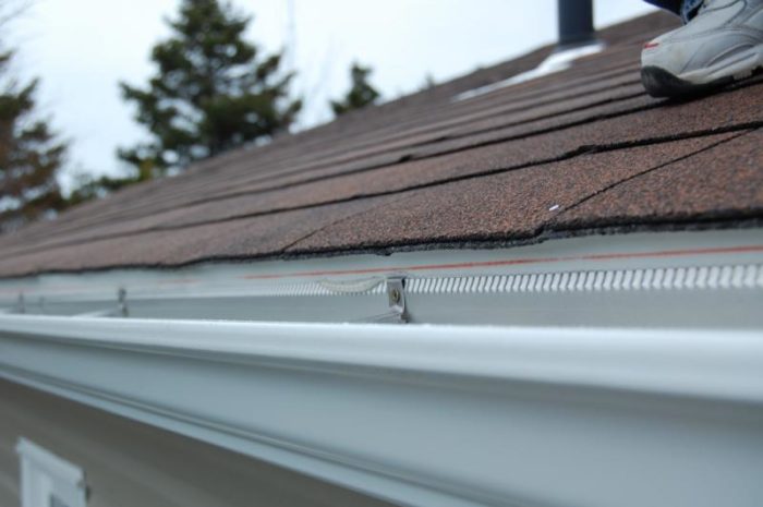

          68. Wanda200 | Apr 04, 2009 10:34pm | #117
            Hi Moogie,

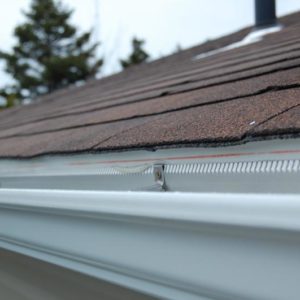

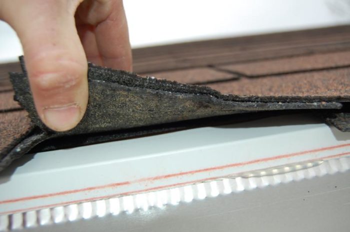

            Guess what?  There is a drip edge on the roof. But you'd never guess how they attached it to the roof.
            They nailed through the shingles to attach the drip edge!!!!!!!!!!! So they have nails all around the perimeter. OMG!
            Wanda
          69. Piffin | Apr 04, 2009 11:00pm | #119
            "They nailed through the shingles to attach the drip edge!!!!!!!"Sheesh! I thought this was such a mess because they used a roofer to do all the carpentry and sheetrock work also, but that makes it sound like they didn't even have a skilled roofer on your job! I'm looking forward to the pictures you have yet
          70. Wanda200 | Apr 05, 2009 02:52am | #120
            Hi,
            OMG! I feel like blasting the balls off a few roosters!
            Yes they nailed down through the shingles to attach the drip edge all the way around the roof. I told you they were Neanderthals.
            I have a few others I can post but you can have a look at these and see what you think
          71. Wanda200 | Apr 05, 2009 03:20am | #121
            Good evening,
            I'm here watching Hockey Night in Canada trying to forget about my renovation job from hell.
            Here are the rest of the pictures that were taken of the roof today.

          73. Piffin | Apr 06, 2009 12:44am | #123
            I'm going to start some commentary here, but have to remind you that it is best to resize your photos for posting here. I normally do not even try to open one over 200kb size. I feel addicted to your situation and bound to see it thru so I am trying to down load, but this will take me a good half hour with the size of these just to see the pictures.Lucky for you, there is a good movie on meanwhile....I can't recall how that chimney flue approaches the sheathing plane, but there really should be more of an effort to get it out of the valley. No roofer will ever warrantee a roof that has a penetration in the valley. There was a design goof in that detail - not that this hack outfit would have followed the plans anyways. And if a man has to use roofing cement like that, it is prima facie evidence that he has no skills to be turned loose on unwary customers. I am choosing my words carefully, being willing to repeat them in any court of law where this outfit might be arrogant enough to try and collect any money from you for this junk, BTW.No nails need ever be exposed on a roof surface except the last two in a ridge cap. And those are high up where little water ever runs over them, but they get some caulk to seal too. These exposed near bottom with volumns of water running over them and no sealant will have water seepage inside of two years wetting the wood and leading to rot.I almost think the gutter installers did the metal work after roof was on but it is all botched up with that caulk there instead of proper install and lapping of joints. Gutter lip should be UNDER the drip edge. The drip edge used is the cheapest type possible.The top shingle exposure is uneven - from zero at one end to a couple inches at another. I don't know how it is possible to get that far off parallel in such a short roof.I wonder if there is ANYTHING this outfit did right....Oh Yes, the shingle layer did start at the bottom and lay to the top - at least he got that much right.
          74. User avater
            Dam_inspector | Apr 06, 2009 12:58am | #124
            It looks like the valley has the shingles underlapped, or maybe it's an illusion.
          75. Piffin | Apr 06, 2009 01:46am | #125

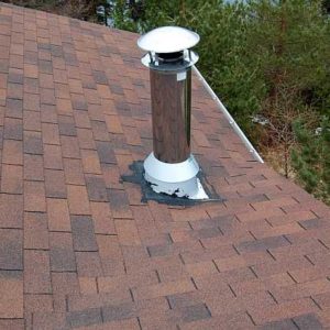

            I am not sure what you mean by underlapped.It is a woven valley, and the flue was set after the roof shingles were laid, with only about 2" up under a flap of shingle exposure, then lots of block gumbo.Gauranteed to leak within a year or two.I have no idea if there is underlayment or I&W lining the valley either.
          76. User avater
            mmoogie | Apr 06, 2009 01:57am | #126
            Maybe it's just me, but I'm not really seeing any drip-edge either. Wouldn't be the first roof that was ever laid without it, but still...
          77. Piffin | Apr 06, 2009 02:16am | #127
            I see L-style in a couple, but one shot looks like none at all where I can't be sure.But it is laughable for th gutter to be over instead of under it.
          78. User avater
            Dam_inspector | Apr 06, 2009 02:25am | #128
            It looks like the shingles are layed so that the flow of water will go under some of the shingles. They look like they are improperly woven to me.
          79. Piffin | Apr 06, 2009 02:53am | #129
            I don't see that. I think what you are seeing is the crotchlines in some of the shingles.
            But either of us could be wrong on that.
          80. Wanda200 | Apr 06, 2009 03:09am | #130
            hello Piffin,
            I"m under the impression that my roof is under warrantee. You're  telling me that no roofer would ever warrantee a roof like mine (one that has a penetration in the valley)  My god!
            Why wasn't I told this by the company engineer before the roof went up?
            This picture might help you recall how that chimney flue approaches the sheathing plane.
            What size pictures are  best to post on the forum? 640X800
            Wanda
          81. Piffin | Apr 06, 2009 12:57pm | #131
            "the company engineer before the roof went up? "He had no idea where the roofer would put the flue or that he would do such a sloppy job.you've told us that the roofer did all this work, but what I see is that the flue was put thru the roof after the shingles were laid, so maybe they somebody else doing that - a metal jockey who know nothing about roofing.I recall that behind brick now. I believe they could have gotten that pipe elbowed further away from the valley, but I'd have to be there to be sure. That is something I'd have the new guy study out if you have to rebuild that area of roof to deal with the truss problem.If you look at the vent showing on a couple pictures in this same section of roof closer to the ridge, you will see how a flashing boot should be worked into the shingles. This one mostly just lays on top of them with a bunch off goop. so it is poorly done even for a clear section of roof, but a valley carries a high volumn of water and is a location where more ice backup occours.the type of warantee you have is what we call a tail light warrantee - good until my taillights get around that next bend in the road. If they were to do anything at all for you when it starts leaking, it would only be to spread some more black glop around up there. The only way plastic roofing cement does any good is when used like a glue, between two pieces of material, not gobbed on top. remember the kids in kindergarten? Some would use the paste to glue paper together by spreading it first, then stick the paper together - the right way. Others would just smear it on top of the seam where it would not do any good, then cry when the project fell apart on the home home to show Mommy.

            Just got off the phone with the contractor.. he said I don't have a drip edge on the roof.
            So I guess what I have there is a fascia flashing?????? He realizes the flashing is a mess.

            Now that the problem with the roof has been taken care of I have another problem to deal  with.
            Remember I said I was also meeting with the mason on Tuesday. Well after having a lengthy 1 hour discussion with him it was advised that I remove the fireplace and mantel. He was shocked to discover that it wasn't properly supported from underneath. Apparently all that weight is just resting on the floor joists. He said whoever put in that fireplace should be shot!
            This man is a certified WETT inspector & Technician. So he knows what he's talking about. I checked out the references he gave me and  was shown pictures of his work (his working portfolio)
            Now remember I did have an CHMC home inspector carry out a 3 hour inspection of this home way back. So I have to wonder why this problem wasn't discovered. I actually had 2 other masons up to talk about my fireplace a year ago because I wasn't getting much heat. plus I noticed that the floor was sloped beneath the hearth and there was a small crack in the tile on top of the hearth. Well now I know don't I. Bit too late.
            Before the drywall and plastering can go ahead I have to have the  large fireplace removed from the main room. That was the Mason's recommendation.  For now I am left without a fireplace. OMG! He said it would cost around $8000-9000 for a new one. The cheaper option would be a heat efficient wood burning stove. Now I've got to hold off on the flooring. A decision has to be made. I could just have the new flooroing I have installed and worry about putting in a new fireplace and chimney next year. But that would be doing things #### backwards!
            Sure hope I don't run into any other surprises.
            Wanda
          90. Piffin | Apr 09, 2009 03:39am | #144
            I thought that might be the case when I saw the face was only a 4" veneer with no frame - and you mentioned sloped floor under it.You will just have to decide if you want a masonry FP, a metal zero clearance with faux face, or a wood stove setup.I'd go with the later myself. but you can still get into 5-6K with the unit, the chimney and the surrond.
            Nine grand ain't a bad price for a true masonry fireplace though.
          91. Wanda200 | Apr 18, 2009 04:22am | #145
            Hi guys,
            I was up to check on things today. The men were busy stripping off all the shingles. It appears that the company didn't even bother to use building paper beneath the shingles.   I know if you don't use some sort of building paper/tar paper beneath the shingles condensation is likely to accur. They also discovered that insufficient flashing was used on the roof (valley section). The plywood sheathing/roof decking wasn't secured sufficiently in some areas.
            Remember the pics I posted showing gaps in the roof.... My contractor had to purchase and install a sheet of plywood to cover the gap that was right in the middle of the roof. I'd say that gap was 1" minimum! I could probably slip my hand through it.
            One other thing they skimped on.. They used 2 1/2" nails instead of 3 1/2" nails to fasten the  (T2)trusses to the TG4 girder. Get this they only used 2 nails per hanger. My contractor told me he uses (7) 3 1/2" nails on each side of the hanger.I"m guessing that's called the flange. He nails in through the sides of the hinge into the truss on both sides.
            Wonder what else my contractor will discover when he goes to replace the trim around all the windows tomorrow. (some of the vinyl has to removed in order for him to replace the trim)  There is probably no soffit trim to be found anywhere on the house. I know the front doesn't have any.   Maybe he'll discover that the roof trusses aren't toenailed on properly. God only knows. I asked him to check that out. If they used the wrong size nails for everything else I'm willing to bet the guy used the wrong size nails when he toenailed on the trusses to the exterior walls. Since this is a renovation they are not required by law to use brackets to attach trusses.  :(  But in new contruction they are.
            The contractor has taken pictures of all the "deficiencies".  Everything has been documented. Shouldn't take anymore than 2 weeks to complete all the work.
            Wanda

          93. Wanda200 | Apr 24, 2009 03:57am | #147
            Hello,
            Just curious but what size sheathing do you use when it comes to roofs? 1/8" or 1/4" ?
            Do you use tar paper/roofing felt?
            Found out this evening that there were certain areas where the sheathing wasn't nailed down sufficiently. They had actually missed the trusses and drove the nails into thin air! So that slowed down my contractor.
            I really should refuse to pay anything for this disgusting/ slob job! Talk about cheating the customer. I am so grateful to this forum. Imagine had I not posted my concerns here at breaktime. Thanks to all the experts here on the forum I've been saved from a really crappy reno. The contractor would have gotten away with fraud.
            Wanda
          94. Piffin | Apr 24, 2009 01:03pm | #148
            Roof sheathing depends on live load requirements and layout of the trusses.You have snow loads to deal with, so with trusses at 24" OC, you should have 5/8" sheathing. If trusses laid out at 16" OC, then 1/2" would suffice.Always use underlayment. Tarpaper or one of the newer synthetics. Also, there should be a product called ice and water shield 6' up from the eave, and in the valleys.

          99. Wanda200 | Mar 27, 2009 06:57pm | #78
            Hi,
            Here are some more pictures of the roof. Showing the front of the bungalow.
            There is no way to tell how those trusses are fastened to the ext. walls.
            Wanda
          100. Framer | Mar 27, 2009 06:51pm | #76
            Wanda,
            The answer of the day is call the inspector yourself and get him out there immediately!!!
            Is there a permit for this job, yes or no? If not call the inspector now and have him look at this. You have nothing to hide, right? There should've been a permit. It should've been in your window, was it??
            Your new contractor should not be doing anything until you have an inspector and truss rep out there to look at this.
            It's YOUR job now to get an inspector out there. You kidding yourself if you come back and tell me that it's the new contractors job. If so, where the permit and tell him you want to see it in your window right now like it supposed to be. You tell him you want to be there when it gets inspected. This new contractor can't close anything up anyway before it gets inspected.
            Are you going to call the inspector, yes or no?

        BossHog | Mar 11, 2009 03:06pm | #45
        From the pictures I can't really tell what's going on. The trusses could be completely adequate, or there could be serious problems with them. I did see a couple of things that I would like to look at more closely if I could. Withuot reviewing the layout, knowing the loading, and climbing around in the attic there's no way to know fer sure.
        I love being labeled the ditz - That was how I got the guys. [Jessica Simpson]
    2. LIVEONSAWDUST | Mar 11, 2009 05:15am | #39
      Piffen, my hats off to you, you are quite the detective, I had to go over those pics a couple times to see what you are refering to.
      I think you are exactly right, one of the 2 ply trusses is out of position.
      Seems to me that Wanda should get the truss company to engineer a proper fix and deduct the cost of that from final payment as well, dont you?
      1. Piffin | Mar 11, 2009 06:47am | #41
        Well, it is really the contractors job to make it right, but they have pissed on her all winter over this already. What is a "reasonable time" to show good faith? I can't make that decision on this deal.and it was Joe who zeroed in on the problem with the instinct of a homing pigeon.
        Edited 3/10/2009 11:48 pm ET by Piffin
        1. VinceCarbone | Mar 11, 2009 06:56am | #42
          Shouldn't there be bracing up in the trusses also?   Vince Carbone
          Riverside Builders
          Franklin,NY
          1. Piffin | Mar 11, 2009 07:43am | #43
            I'm not much of a truss man and don't have the truss engineer's plans,so I don't know. I figured Boss could fill in some generalities and confirm whether my thoughts were right. I'm quite sure I am, but you never know.I think I see the bottom chord on the gable end truss is 2x4 as are all the others there, but the 2x6 on a couple and the red paint and marking drew my eye in.LOL, she said the contractor told her there was a "problem" at the chimney area. He just didn't tell her that he caused the problem

          3. Piffin | Mar 11, 2009 03:12pm | #47
            Oh my goodness, a faux Boss!
            BossHog | Mar 11, 2009 03:28pm | #48
            He's been around for a LONG time, and only has one post. So hopefully it won't cause much confusion...
