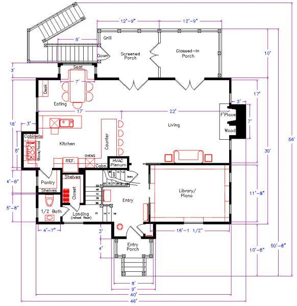

After lots of back-and-forth with the SIL and BIL lately. I won’t build it, but have designed it, and will do the plans. Top and left in the plans looks over the Patuxant just before Solomons, MD.
Had to fit in a nominal 30×40 footprint. Will have Craftsman detailing inside and out.

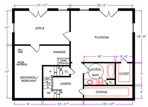

Basement – walk-out in the back (top)
First Floor

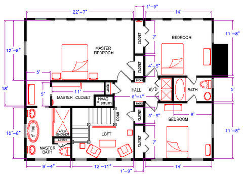

Second FloorView Image

Cool...

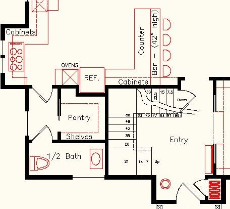

but the location of the first floor half-bath is practically impractical.
I'd consider moving the pantry to the closet, toilet to the pantry (with kitchen access) and closet to the 1/2 bath.
IMHO
A La Carte Government funding... the real democracy.
Yep, that was exactly my initial design!
Here it is-View Image
But they STRONGLY didn't want the 1/2 BA access through the kitchen. They didn't want guests tromping through the kitchen and past the pantry.
The first floor has a 10' ceiling, so the steps up will be fine.
Edited 4/5/2009 9:08 pm ET by McDesign
We need elevations please ?!!!
Oh. I didn't know that guests would be the only users of that powder room. A La Carte Government funding... the real democracy.
Ya dont ship where ya eat!
With 10' ceilings, and second floor framing, won't you need a lot more stairs than shown?
(Not that I have ever had to deal with an archy forgetting to figure some of the required height into a plan before.)
It calculates out okay - those little tiny numbers on the stairs are heights at a minimal 7" rise and 11" run (stairs are 42" wide); I need to gain 132" for 10' + floor trusses. Probably actually have a 7-1/2" rise once I do section views. Might be fun to try a couple of those new-fangled winders . . .
Just need to maintain enough space at the top not to have that wall too close - can take out the closet at the top of the stairs if I have to.

Nice. The bathroom up two stairs does not bother me at all. I have been in older houses that have had powder rooms off of a mid flight landing.
I would maybe open up the stairway in the second floor loft. The space behind the one chair seems pretty inaccessible. Is that for tv watching?
Thanks - yes, that little loft area is for the kids' TV watching.
Did I miss the elevations, too?http://www.tvwsolar.com

Funny, I am going to compliment you on the placement of the pwder. room, as IMO it's down right disgusting to have a bathroom off the kitchen, need I say more. That's where mine has been for the past 25yrs, I know what I'm talking about. Also the closets upstairs are mighty shallow.
<the placement of the pwder. room>
I personally hate bathrooms directly off a room, and always try to avoid it - should always come off a hall, even a short one.
Those upstairs closets are tight - I've told them that's the minimum, and they can widen them if they want to give up space in the bedrooms - those aren't load-bearing walls, and they have to maintain the 40' maximum width.
If they don't give up 3 more inches for the ID of the closet, they will be crushing some cloths.
I usually put the center line of the closet pole l2" off the back wall. They will never miss it in the bedrm.
