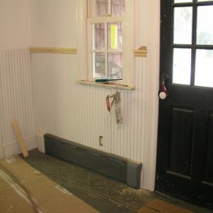

  2. andybuildz | May 11, 2006 03:52pm | #2
    Why not use the sheets of 3/4" beadboard? The lines are much deeper...more like the real thing. I used it in my mudroom recently.
    You can remove the sheetrock where the WS is to go and nail right to the studs to make up for any projecting from the trim.

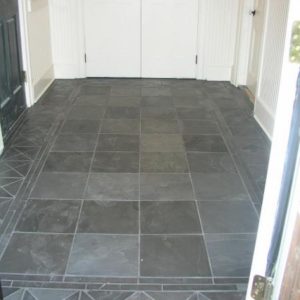

    2. bc | May 30, 2006 06:14am | #18
      some killer tile work!
      1. andybuildz | May 30, 2006 07:10am | #19
        some killer tile work!>>Thanks bc...yeh, even a little room with a small amt of tile work can turn into a whole ordeal. Thats one of the good things non the less about doing work for yourself other than just for customers.I was able to change my plans mid stream from "just" laying down the

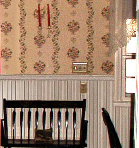

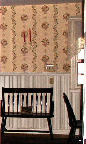

    In my 1838 house, the dining room wainscoting is framed proud of the door trim.  The frame overlaps the door surround.  The "field" of the wainscot is simply two horizontal planks, with a bead at the joint.  The cap is a bullnose with fillet.  The wainscot frame is made up of flat-planed boards, with the base a full 12 inches in height.
    FYI, also pictured is the original Norfolk door latch.  And a c.1840 Empire chair.

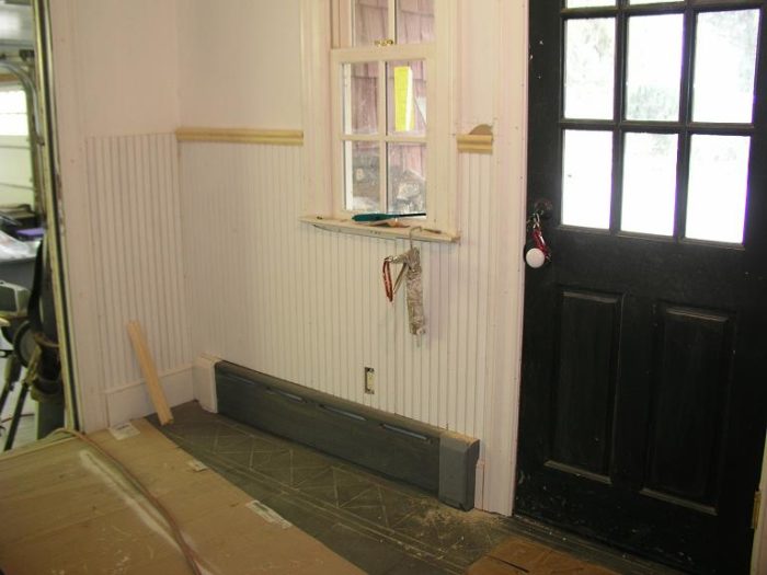

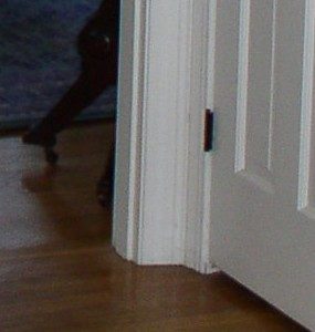

    I have another question on this beadboard installation that will get done next week.  The picture is not very good but it shows part of the room where it is getting installed.  My question is about the window.  The current chair rail is in line with the sill.  the new chair rail will be higher to match what is needed by the dining room chairs ; probably to just under the outlet, allowing for the new chair rail.  I may go higher than the outlet depending on how things look.  I plan to butt the panel against the window casing but I'm going to remove the window sill so I can re-install it over the beadboard.  Since the casing sits on top of the sill, I'm assuming that I'm going to have to remove the window casing in order to get the sill off or is there some trick to getting the sill out without having to remove all the trim?
    George
    1. Ragnar17 | May 23, 2006 11:22pm | #8
      George,
      It's difficult to see precisely what's going on in that picture!  I'm assuming you're talking about the stool, which is the horizontal interior trim element on top of the sill.  But anyway, if it's an original stool, it's not going to be all that easy to remove.
      Without seeing what you're actually working with, I can only make assumptions.  But you're most likely going to have to remove the side casings just to get started.  After that, just work *very* carefully and slowly so you don't crack the stool.
      Typically, the stool is trapped by the casings and the apron.  Many times, the sill is cross-nailed into the apron.  Also, the stool often has a beveled rabbet to mate with the sill, which creates a weak axis when you're prying it up to remove it.
      Alternatively, you might be able to either (1) scribe your panel to fit the window trim, or (2) use a handsaw to cut away the back edge of the stool where it adjoins the wall; this would create a narrow gap into which you could slide the panel.

      You need to install the stool OVER the beadboard?  Because it doesn't project far enough to be proud of the wainscot once it's installed?  Since it's painted, I'd be tempted to cut off whatever profile there is along the face of the stool, and epoxy a new (deeper) piece onto it.  Will you be reinstalling the apron (I think that's the term for the trim piece under the stool)?
      Here's a sketch of some beadboard that extends above the outlet.  I think that works OK  (photo attached below).

        Right,  I'm thinking that I want the stool over the beadboard and yes, I'm removing the apron.   What the picture doesn't show is that the right side of the window is about 8" or 10" away from the adjacent wall.   If I was using individual lengths of real beadboard the installation would probably be a lot easier in this area.
        General question: when installing wainscoting, what is the standard procedure?  Scribe the wainscoting around the stool, put it behind the stool, or remove the stool and re-install it on top of the wainscoting?
        I think I have two ways of handling this.  I may cut the back of the stool, cut a panel for the right side that just fits between the wall and the casing, slide it in from the top and cut the left hand panel to slide in behind the stool and meet the right panel.  Or I can disassemble the trim, install a full sheet and re-install the trim.   Scribing is not an option, I could do it on the left side but not on the right where the wall is so close.  Actually (thinking out loud) if I used a narrow piece to scribe a template I could use that to then cut the pattern on the actual piece that has to fit.
        Another question.   No matter what method I use I'll remove the apron so the panel is behind it.  So, if I scribe the panel to fit the stool or cut the back of the stool and slide the panel behind, when I re-in stall the apron it will end up being a 1/4" closer to the front edge of the stool.  Is this a problem visually, i.e. will it look like crap?  I'm assuming that my installation will look great. :-)

          I've rarely used sheet goods, so I don't know the "standard" procedure.  The back side of the stool abuts the lower sash, doesn't it?  Not sure how the beadboard would go behind it unless it was dadoed.
          I'd be concerned about the apron being proud of the vertical window trim.  But if you scribe around it, it might be "swallowed up," and not look good.  Much depends on the existing dimensions and edge treatments.
          I'm not clear how the 8" wall dimension complicates things.  Accurate measurements and/or a template should ease installation.
