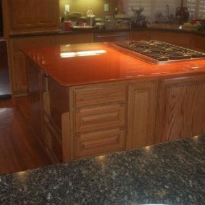

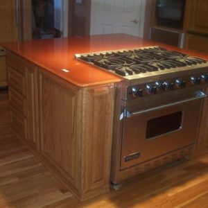

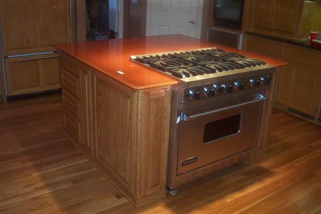

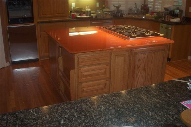

          6. Dave45 | Apr 08, 2006 04:45pm | #31
            In February, I started a thread regarding glass countertops and got a lot of great feedback.  The top went in yesterday, and here are some pictures.
            Installation was an issue until early last week.  The Expo installer couldn't meet the deadline, so the customer hired a commercial glass company to do it.  It took them less than an hour - lol.
            Oldcastle recommended using "Acrylic-Pro" (a water-based tile mastic) spread with a 1/8" notch trowel.  This seemed to work fine and after a couple of hours, it had set enough to work around it again.
            Thanks again for all the input.
          7. ponytl | Apr 08, 2006 06:02pm | #32
            nice top...  I never saw a problem with the install... and your pics confirmed it... but if someone else is pay'n why not.... if it was mine i'd have installed it in a heartbeat... I never assume anyone is more careful or knows more than me until they prove it... It's so cool to be around anyone skilled, informed, ect.... it's a real change... maybe i just see the bottom more than the top...
            p

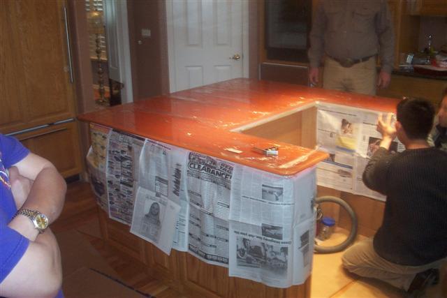

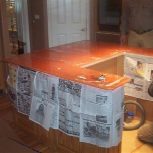

          8. Dave45 | Apr 08, 2006 07:47pm | #33
            Actually, having a pro do the installation was a good plan.  They had the right truck to get it to the site and knew how to handle large pieces of glass.  The top weighs almost 500# and placing it took several of us.
            The customer wanted me there to "supervise".  Since I had done all the design work, I knew exactly where it needed to be.  For the most part, I just explained what the finished job needed to look like, then kept out of the way and watched.
            I did have to give some coaching on troweling the mastic.  I've done lots more tile work than they have - lol.
          9. User avater
            CloudHidden | Apr 08, 2006 08:23pm | #34
            Dave, pretty cool! Can you offer some technical details? Thickness? Tempered? Did the mastic dry clear? Is the glass colored, as it appears? Does the mastic show through the color at all? Anything else?
          10. Dave45 | Apr 09, 2006 02:07am | #35
            Cloud -
            Now that I've done it once, I'm an expert so ask away - lol.  To answer your questions...
            The glass is 3/4" thick
            Not tempered.........(yeah, that surprised me too)
            The actual glass is clear and the color comes from the coating which is applied to the bottom - much like a mirror.  Several colors are available.
            That piece of glass is 19 sq ft and weighs ~475#.   I'm glad I looked into it before I built the island........I made it extra beefy to account for the weight.
            These tops are available from Home Depot's Expo Design Centers.  Like HD, you want to be careful who you talk to.........the associates aren't all that knowledgable.
            The manufacturer says that the coating makes the glass opaque and that there will be no "see-through" but that didn't happen on this job.  After the top was set, you could see a whitish layer under the glass.  The whitish layer was the mastic and you could see the edges of the cabinet where the glass overhung the cabinet.  It wasn't ugly, but it was visible.  I sent pictures to the manufacturer and expect to be hearing from them about it.

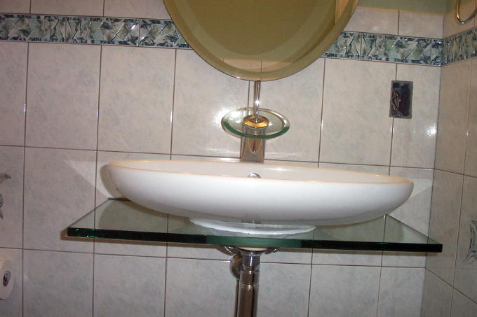

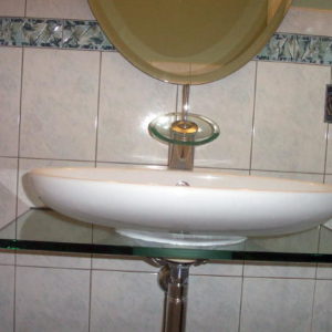

          11. Jerry18 | Apr 09, 2006 08:51am | #36
            That is a beautiful top. I had thought about 3/4" glass tops in my kitchen (sandblasted on the bottom) but worried about scratching. Glass does scratch very easily but as you said is suprisingly strong, even untempered.I did make a fully cantilevered top for the 1/2 bath out of 3/4" glass and although I never got a definitive answer, the general consensus of the experts was, it did not need to be tempered. So far, so good. Here's a pic and ther's more at: http://pg.photos.yahoo.com/ph/leccej/my_photos - in case anyone's interested.JerryEdited 4/9/2006 1:53 am ET by Jerry18

          13. Jerry18 | Apr 10, 2006 06:01am | #41
            Dave,
            I also hope I'm not hijacking your thread.Frankie,
            I believe the glass was 24"x30"x3/4" and I bought it from a glass distributor for $55. It came cut to size with a 1/8" bevel on all edges and polished. For another $450 (not a typo) they would have cut the 8" diameter hole required for the sink, so that I did myself. I think you can see some of the pictures of me drilling the hole with an 8" duct cap and some silicon carbide grit. The sink is made by Porcher (American Standard). The frame that supports the glass I welded up myself from some scrap.That was my first atempt at granite and I really enjoyed it. The only power tool I bought specifically for the job was a Flex 1503 water fed polisher. I made the water attachment for the circular saw and built the work table/tranporter also from scrap. Of course I had to buy all the diamond blades, pads and wheels. For the 3/8" roundover I used a diamond profile wheel made by Alpha that attaches to my polisher and most of the shaping was done with a 4-1/2" grinder with a diamond blade.If you have any questions, feel free to ask,
