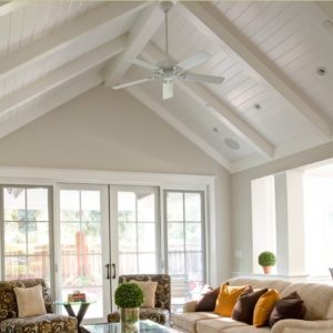

    I think I have decided on 2x6 rafters spaced about 4 feet apart. That would be every other rafter that is currently under the dry wall. And yes, I will do extensive Planning before starting this project. I will probably end up building a small model to see how it looks.
    I am going for a look similar to this picture.
