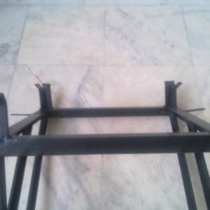

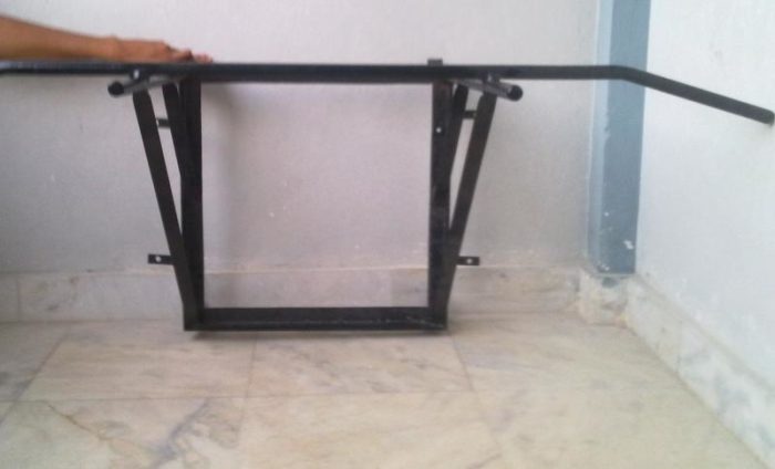

Hi guys,
I need to install this pull up bar on a brick wall.  Pull up bar photos – attached with this post.
The 6 inch brick wall is not very hard, except for the top 1 inch or so & brittle after that.
I am trying to figure out the best way to do this. I was initially planning on breaking large cavities in the walls to fit the 4 flanged prongs and covering it with concrete and add a few anchor bolts for support. Then I read about epoxy grout anchor bolts which can take heavy loads and I am now wondering if I would be better off drilling 4 holes in the main frame of the pull up bar and just use epoxy anchor bolts.
I would still need to fit the prongs in but if the anchor bolts are good enough to take the load I can make do with much smaller cavities for the prongs and use epoxy for the prongs as well rather than use concrete. Do is this sound like a good plan?
I live in India and I will be using a locally available Anchor Epoxy.
I also wanted your advice on the epoxy applicator. The product description (see below) speaks about using this primarily for tile grout. Can I use this to apply anchor expoxy grout for the anchor bolt & also the prongs in my pull-up bar frame?
