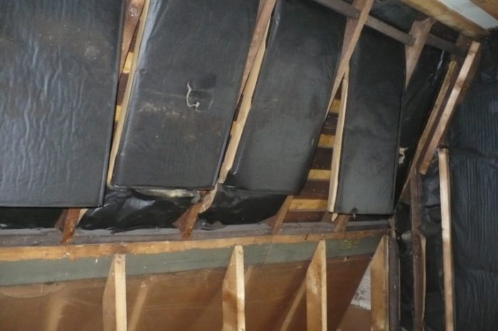

Looking for advise in proper techniques for insulating the ceiling in a Gambrel roof. The rafters are 2×4’s spaced on 19″ centers. The rafters do not hang over or have any vents.
Currently the insulation has big gaps (see in pictures). One idea I had was to leave current insulation and put sheets of foam board on the under side of the rafters then drywall. I’m concerned about condensation. What would you do?

Assuming you are planning at some point to finish the interior, I would insulate the ceiling of the floor below from the outside wall in to the kneewall (note that this area may require vapor barrier before insulating). Doors for future access to the space behind the kneewall might be worth considering. Then I would insulate the kneewall up to the gambrel roof. I would then insulate the gambrel roof. Perhaps 1 piece rigid insulation between the rafters (foamed in place) with additional insulation below the rafters. If headroom is not a concern I would put all the insulation below the rafters (easier, faster and more ventilation).
Vapor barrier should be installed on the warm side where applicable and as practicable. At the very least the penetrations in the ceiling of the lower floor (outside the kneewall) should be sealed. I would try to establish continuous ventilation connecting all airspaces from eave to ridge under the roof sheathing. Of course you will want to address any structural, mechanical or electrical issues before insulating.
Some people would prefer to just foam the underside of the roof. Which has the merit of simplicity and is arguably superior.
Thank you sisyphus,I would like the simple and superior technique. When you say foam the underside of the roof, are you talking spray foam? And does this method eliminate the need for ventilation??Thanks,
Whether ventilation is required or not is debatable. Some jurisdictions, apparently, insist on it and some do not. The approach I detailed reflects my experience (and conservatism) and I am confident it will produce reasonable results.
Spraying the underside of the sheathing with foam is a technique which I have no experience with. It may well be superior. I have, however, questions about the longevity of such a roof system. Specifically what is potential for trapped moisture from condensation or leaks to cause rot? I suspect that time will tell that it depends on the local climate, quality of installation, maitenance and lifestyle of the home owners etc.

One option.....closed cell spray foam between the rafters and trim even.....cover with 2" polyiso foam boards temporarily tacked into place, foam joints while hanging and tape all seams and breaches and hang 1/2" drywall with 3 1/2" screws......time consuming but worth the insulating value including a great thermal break greatly reducing condensation. Use a metal roof or other similiar heat reflective roofing material and forget about venting it.

Some folks still spray foam right up to the back of regular shingles but I personally have found that standard shingles curl prematurely when this is done. Check with your shingle manufacturer to verify.
Since the shingles are in place, I'd create mini-soffit vents and cover with screening to keep bugs out. Cut strips of wood 3/4x3/4" and attach along the inside edges of your rafters along the sheathing edge. This will create a stand off from your sheathing. Use foil reflective foam board and create your own channel for air to move through utilizing a radiate barrier method all the way up to the peak and install a ridge vent. Fill in the rest with foam, whether you cut your own panels and seal extra good with can foam or whether you have someone come in and spray foam. Finish with another layer of foam board over the rafters to create the thermal break and drywall to complete.
Any "simpler" than this and you sacrifice the "good" level of quality you're looking for. Spend the time and $ recommended and you'll find it to be more comfortable year round and less costly to heat/cool when you need to.

Pedro, I like your foam with ventilation concept. I was thinking about doing something similar on a place I own because while I admire the thermal, structural and audio advantages foam offers I am reluctant to abandon ventilation. I got the impression, perhaps erroneously, that Kneetwoods has no soffits so he might have to vent through the fascia or ???

Yeah, I'm not completely certain what he's fully starting with. Sometimes a building is constructed simply as a shelter and was never intended for it's new purpose, thus some reconstruction may have to occur to accomodate the new usage.
I did some pretty serious research prior to building my last home and with some sort of metal roof, I would never bother with ventilation. We're planning our retirement home now and I'll do the same thing for an insulated roof again......I am going to add to the R value but I'll still insulate all the way up without ventilation. To me, metal roofing is a one time expense that pays for itself over the years. Awesome investment.
