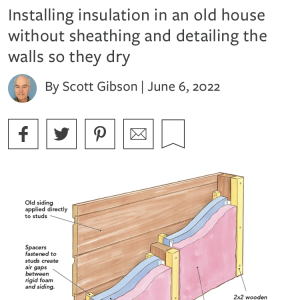

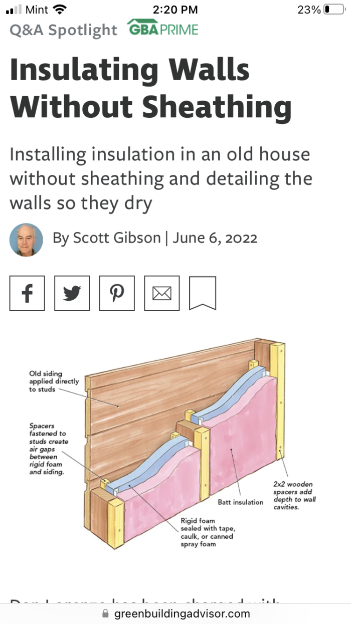

    1. [email protected] | Oct 02, 2023 11:59am | #6
      If you’re talking all the trim off, why not demo the plaster, put in an air gap, fir out the walls to 2x6, hang blue board and do a plaster finish? Then you have the best of everything- air sealing, air gap, extra insulation, and plaster walls. I don’t understand building a new wall in front of the plaster to save it. It will never be seen, window jamb extensions will be super deep and the house will still be poorly insulated with tons of air infiltration. Perhaps this is a compromise between preservation and achieving modern efficiency standards so the house preforms well for years to come.
      I saw an article about this a while back here’s a link
      https://www.greenbuildingadvisor.com/article/insulating-walls-from-the-interior
