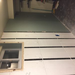

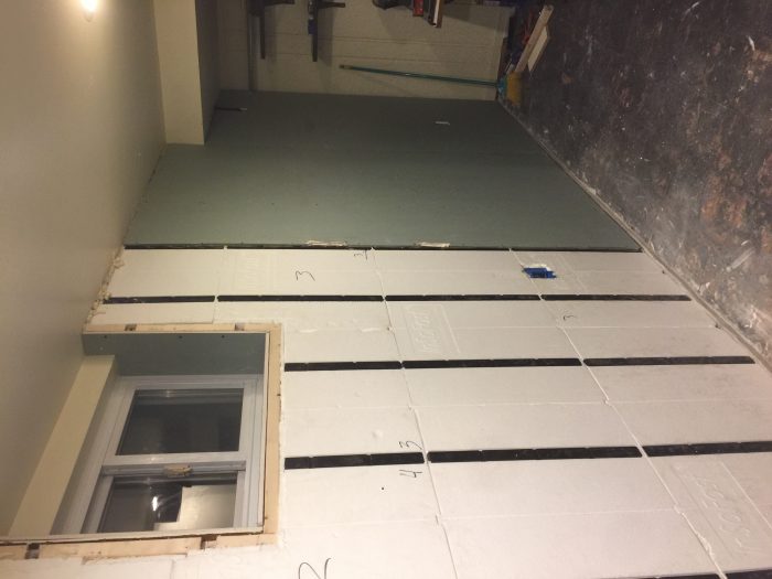

    Investigate using InSoFast panels. The picture shows installed panels being covered with drywall
