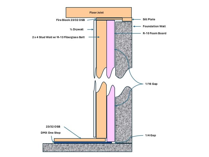

    1. DougR | Jan 07, 2004 10:48pm | #7
      Thanks for the responses. I went back through the archives and I see that this is one of those questions that comes up over and over. Several posts suggested looking at http://www.buildingscience.com, and I found some very good reference material there. They apparently have studied the problem rigorously, and reject the use of a vapor barrier.
      In my case, I have a dry basement, and the only moisture problem is condensation on the cold concrete surfaces. It seems logical that if you can prevent any air from reaching the surface of the concrete, there can't be any condensation. The method they recommend seems realistic to accomplish this:
      Glue EPS foamboard directly to the concrete wall, taping all seams and sealing all edges with adhesive or caulk. Fasten 1x3 furring on top of the foamboard by nailing through it into the concrete. Fasten 1/2" drywall to the furring. No additional vapor barrier. The reasoning for no vapor barrier is that any stray moisture must be able to escape. On an exterior stud wall, it could escape to the outdoors, but on a concrete basement wall it can only escape to the interior.
      Here's my example of how NOT to do it: I started by fastening 2x4s directly to the concrete and then filling in the bays with EPS foamboard. I used dots of adhesive and no perimeter line of adhesive or caulk. This actually held the foamboard and the studs ever so slightly off the concrete, creating a tiny airspace behind and entry points at all the edges for inside air. Immediately upon starting the project, a cold snap hit and the basement walls got VERY cold. In 24 hours I saw water puddling at the bottom of the wall, and upon pulling off a section of foamboard, saw quite a lot of frost buildup under the foamboard. Also saw frost underneath after pulling off a couple of studs.
      Although the uncovered concrete gets wet from condensation, at least it can also dry to the warm inside air. By putting up the foamboard all I did was to cut off the condensation from the warm interior air, giving it no way to dry out - thus frost. I shudder to think what would have happened if I had gone ahead with a plastic vapor barrier and drywall over this wet assembly.
      1. marv | Jan 07, 2004 10:54pm | #8
        I'm with you.  No vapor barrier.  If moister condenses inside the wall, it must me allowed to dry to the inside.  Be sure your foam board is no also a vapor barrier (plastic or aluminum foil skin).You get out of life what you put into it......minus taxes.
        Marv
    JeffBuck | Jan 07, 2004 03:21am | #2
    I just did a basement with a new ... to me .. method that's got good reviews ....
    sheets of expanded or extruded insulation ... dircetly against the block ... friction fit ... with just a few clamps ...
    2x PT plates ... tight against the bottom of the boards ....shot into the floor
    steel stud walls setting on the plates ....
    attached to the joists at the top  and the base plate at the bottom ...
    holds the insulation board tight against the wall ...
    tyvek taped the insulation sheet seams ....
    and now with all seams and such taped shut ...
    the insulation is your vapor barior.
    No poly needed .... nothing to trap moisture.
    I liked it as far as constuction .. and will use it each and every time from now on after reading the research that went behind the system ...
    It's been discussed here before ..... if the search function worked ... you'd be in business.
