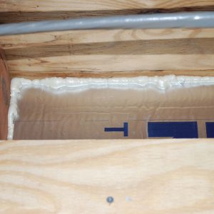

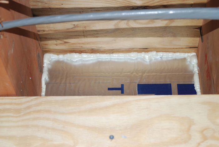

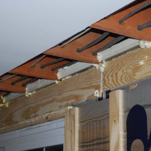

    I used the foam to fill between cut sheets and edges, and along the floor.
    this is two inch foil faced, cut a bit short to make it easier to place, then glued with foam, and sealed around the edges.

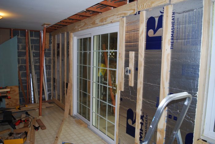

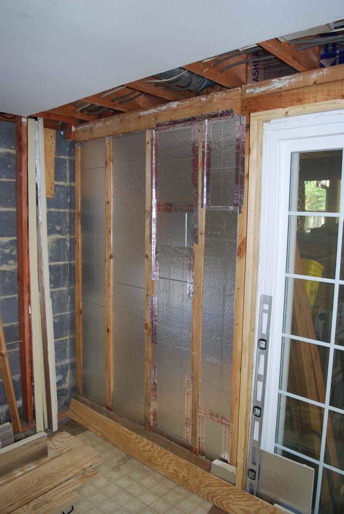

    While I am at it, here is what I did to insulate the walls. this is an outside basement wall, block and brick, was thin paneling on furring strips which were nailed to the block with hardened cut nails.
    I put half inch between the furring strips, then 2 inch foam, secured with half inch plywood screwed into the furring strips, with adhesive in selected areas.
