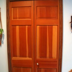

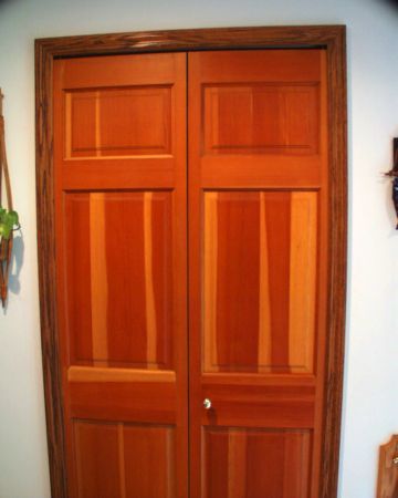

    I like the variegated colors produced by Doug fir when it's varnished:
    1. rf_engineer_5 | Jan 25, 2011 12:32pm | #12
      Where do you buy douglas fir doors at?  I know the box stores only carry slabs of pine, maybe oak.  I have never seen fir.  Local lumber yards or other places?
