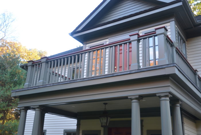

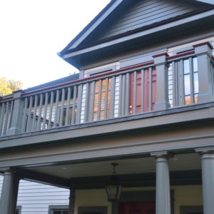

    When I built a front porch bump out on the front of my own house several years back, I trimmed it with WindsorOne. Corner boards, soffit, fascia, balcony post sleeves, etc. Everything is WindsorOne except for the window casing. The flat window casing is stock from Marvin. The top and bottom railings and balusters are cedar. The handrails are mahogany. I went out this morning to give it a close up inspection and it looks pretty darn bueno after nearly a decade of New England summers and winters.  No visible joints, no peeling paint.
