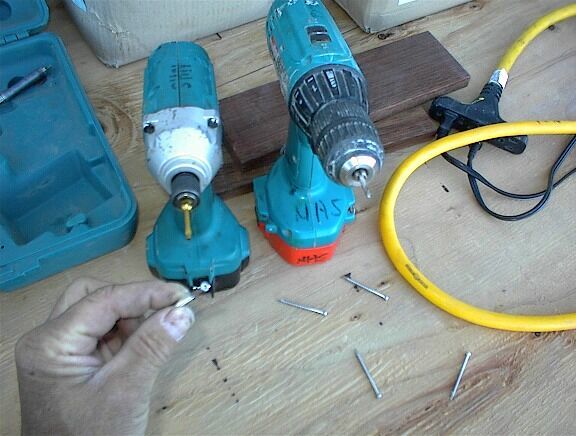

            BTW....  we use only GRK screws for decking... i buy them from a local distributor  in  3000-4000 -  5000 count  boxes  ( like the old  50# box of nails )
            i find them to be less money than McFeeley's
            we also only use the GRK bits, as they are much harder and stronger than  other bits and we buy them in the  50 each box

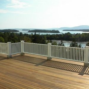

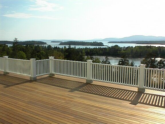

      2. davidmeiland | Aug 06, 2008 04:08am | #13
        I installed with 3/16" gaps. During the wet season they close up to 1/16", so I figure a 5-1/2" board is moving an 1/8".
        Our ipe deck has developed minor checking. It's not a flaw in my mind, and it's not unattractive, it's what wood does when you leave it laying in the sun for years. I only mentioned it because on the day you install it's damn near perfect.
        We recently installed a purpleheart deck. We used 1x4 and spaced it 3/8", partly for better ventilation beneath (it's too low) and partly to allow easy blowing-out of leaf litter that gets in the gaps. I'm sticking with 3/8" gaps on future decks. We also run Vycor over the tops of everything, and anywhere there's a hanger.
        1. Piffin | Aug 06, 2008 05:06pm | #22
          I have been gapping with an 8d nail. I see almost no movement in the 1x4 IPE` we have been using. probably does swell up to almost close in spring as the snow melts off it. Some of my customers dislike seeing gaps, having been used to 1x4 heart pine or fir T&G on some of these. They get walked on with bare feet, thongs and slippers, all the way up to spike heels!
          1. davidmeiland | Aug 06, 2008 05:29pm | #27
            I like bigger gaps because it's easier to clean out the leaf litter. Last deck I built is too close to grade, and I want the added ventilation of the larger gaps. None of my customers own any spike heels, except maybe one guy I can think of and he wouldn't wear them outside.

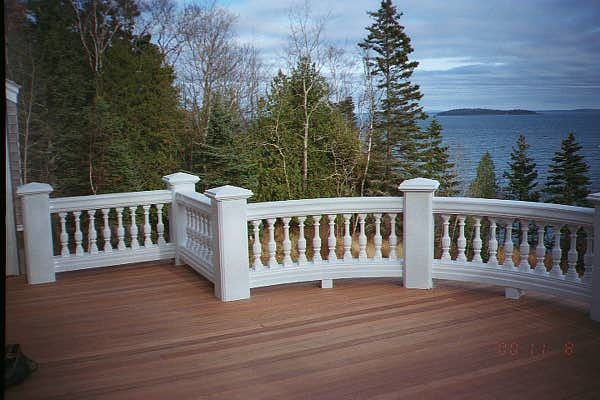

  4. theslateman | Aug 06, 2008 01:12am | #4
    I used Eb Ty on my Ipe deck over 10 years ago.4" boards with absolutely no problems.
    I let it weather naturally -- no finish after laying it.
    I'm in Maine so your results may differ.

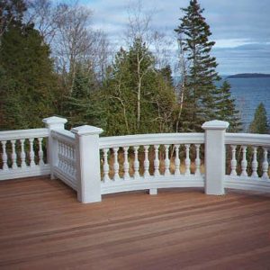

      Hi Walter,I'm interested in comparing notes. Have you ever oiled your IPE`? Is there any checking openning up?I think my oldest one is about 8-9 YO now and I have not seen it for a couple years but I think I will get to see it again in a week or so.
      1. theslateman | Aug 06, 2008 11:11pm | #28
        Paul,
        It's never had anything on it other than Mother Natures assortment.
        Never had checking or any other issues.
        It's 3/4" x 4" stock biscuited out where the Eb ty's are placed. I'm totally thrilled with its and the fasteners performance since early Summer of '98
        1. Piffin | Aug 06, 2008 11:15pm | #29
          I have never seen any actual checking either.I guess openning and closing of microfissures is more what I had in mind

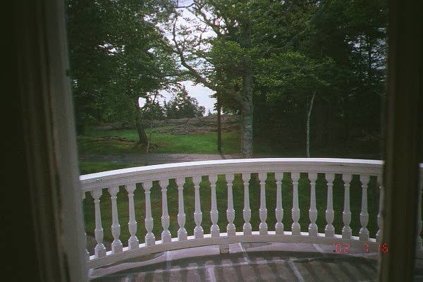

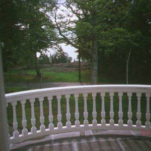

        1. Piffin | Aug 08, 2008 02:05am | #34
          Well,.hmmm...Thanks for saving more of it for us tough guys who appreciate wood instead of plastic.
          1. vintage1 | Aug 08, 2008 03:51am | #35
            Piffin,
            that deck is a thing of beauty!  Can't quite decide which is better, the deck or the view.
            Of course, me being in the midwest, I have to favor the view, just slightly ;>)
          2. Piffin | Aug 08, 2008 04:20am | #36
            I did the deck, God made the view.I'm just a poor carpenter, he is the master craftsman.here is another picture of some work we did together.
          3. vintage1 | Aug 08, 2008 04:32am | #37
            Another very fine project!
            On both, what is the railing made of? I especially like the turned balusters in the first pic, but you don't see too many of those made of wood anymore.
          4. Piffin | Aug 08, 2008 04:51am | #38
            That first one was a Fypon railing.
            They used shots of that porch for a poster and one of their catalouge photos a few years ago. Fypon is injected molded polyurethene foam with interior re-inforcing. All their molds are made from original wood profiles.I'll attach another similar that we built from red cedar and turned the ballusters ourselves. It is over a tinned copper roof though.The second is all wood made on site.
