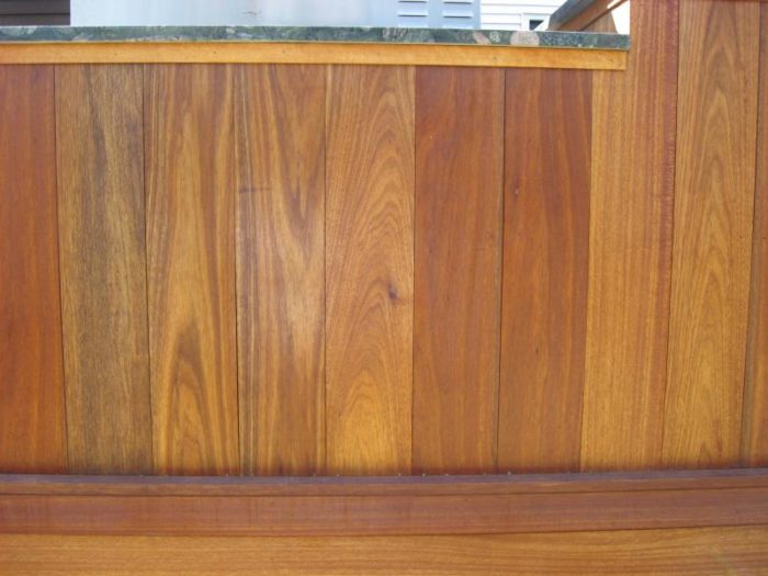

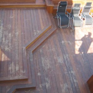

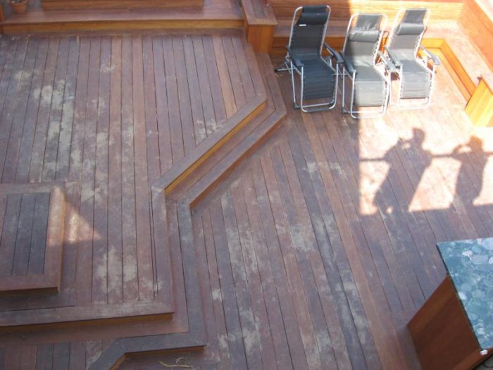

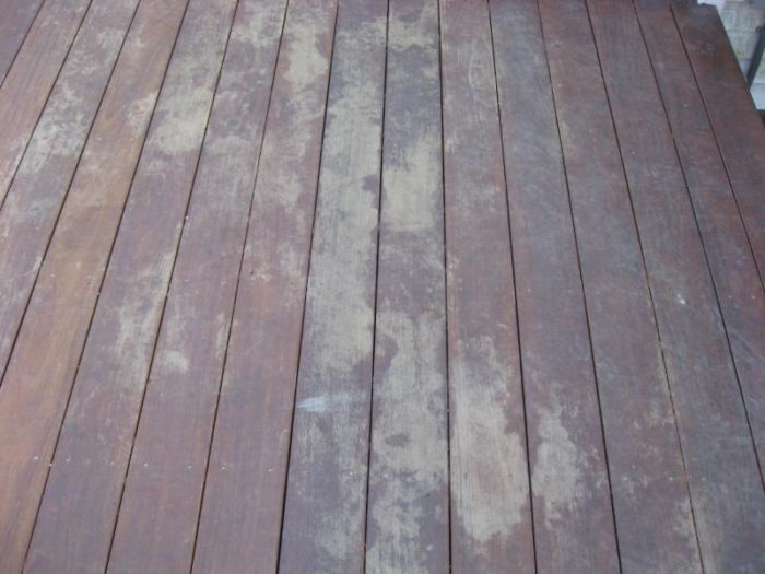

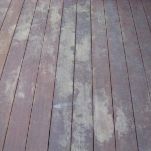

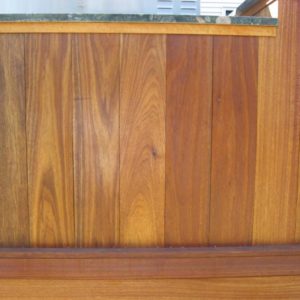

I just took these pictures yesterday.  The Penofin seal has come off in splotches throughout the decking on the horizontal surface.  It is not uniform but is all over the deck on the horizontal surfaces.  None of the vertical surfaces have any issues.
I always tell a customer that natural hardwood decks will require regular maintenance and if you want to maintain the warm finish you will need to refinish each year.  But this went through one winter and has not been exposed to the sun too much because of the snow on top.
I would appreciate comments on anyone’s idea what is going on here and if there is: 1) a reason this happened that could have been avoided, 2)  a solution for a longer lasting finish and 3) the best way to clean up the finish now

    The application data says that it may require annual reapplication, and it is just an oil finish.  So, I would expect it to need refinishing after any prolonged exposure to moisture.

    I don't care for Penofin since it requires recoating in 3 to 6 months. If its put on new lumber without washing the mill glaze off, it won't penetrate well. You have to remove all the excess when applying. Follow the manufacturers instructions for repair.
