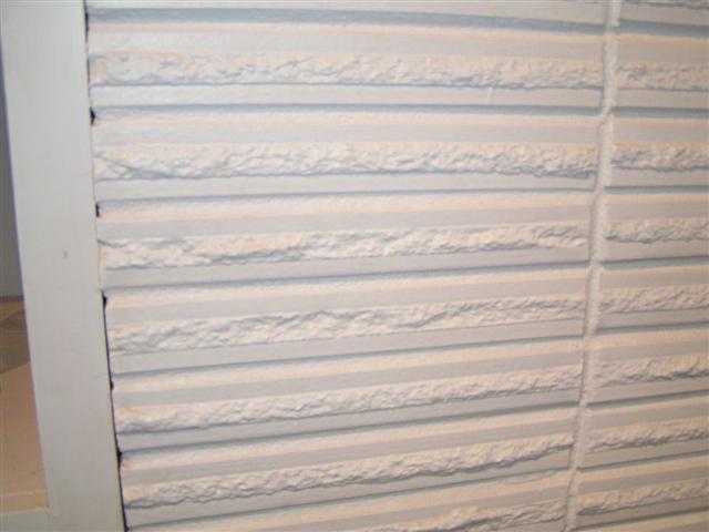

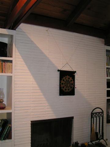

I’d like to reface my 1950’s brick fireplace but each brick currently on the face has a “stripe” through the middle  that is irregular heights. I guess they thought it was decorative at the time, but it’s not so great now. I’m not sure how I would get a solid level surface to work with. As part of the project, I’d like to put a flat panel TV in as well.
Anybody have any great ideas for dealing with this?

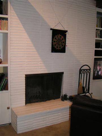

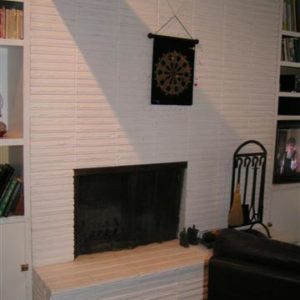

      Here are some pictures of what I'm dealing with. You can see the brick detail and just how much of it there is to cover. Would appreciate any suggestions.

      2. TTF | Oct 28, 2005 08:48am | #22
        The brick on your fireplace are called Romans - the horizontal stripe comes from where you break them apart, they came in sets of four in a square set. When I was a kid I spent hours breaking these apart as a hod carrier. These were popular in the 60's, even into the 70's.
        I also had these brick on the fireplace in my first house. I tore them off, and layed up a new face. It took about two hours with a rotohammer to tear them off, and 2 more to clean it up. Its messy and you should get a mason to do the rebuilding.
        Another option is to cover them with a slate, tile, flat (fake) brick or stone. To get a flat surface, you could morter (thin-set) and screw concrete board over the brick, then lay the tile on it. You could also afix a mantle onto it as well. This would be a lot easier, cleaner, and likely cheaper.
        If you are putting cultured stone on, you could screw wire lath to the brick, put a morter scratch-coat on, then lay up the stone.
        Good luck.

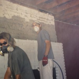

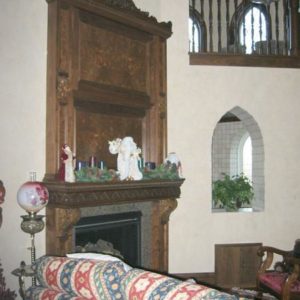

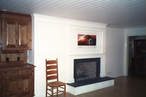

    The bricks are removable.  The first photo shows us working on a similar project.  With a small air hammer you can have those bricks off in a few hours.  We also removed the hearth as it was irregular and replaced it with a 2" slab of slate.
    This firebox, like yours, is offset.  Ours supports a fireplace on the opposite wall.  We used the "offset" box to our advantage by building an automated slide to hide an LCD tv.
    In the second photo, you can see the a panel directly over the fireplace (the one with the Porsche poster that my son added temporarly).  It slides to the right.  There is 5" of depth behind the panel.  Enough room for a 42" LCD.  It is stationary and mounted to the bricks.  I don't have any photos of it in the open position, but it does seem to add to the wow factor for new guests.  The motor assembly is housed inside the hearth.
    Hope this helps.  I have a few in-process shots if you are interested...
    Dean

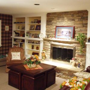

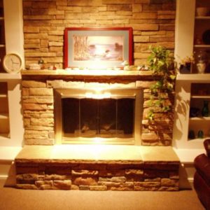

    JIM THIS IS THE FIRE PLACE THAT I JUST REFACED WITH CULETURED STONE I NEVER DID ANY STONE WORK BEFORE /IT WAS ALOT OF WORK BUT ENJOYED EVERY MINUTE.
    DAN

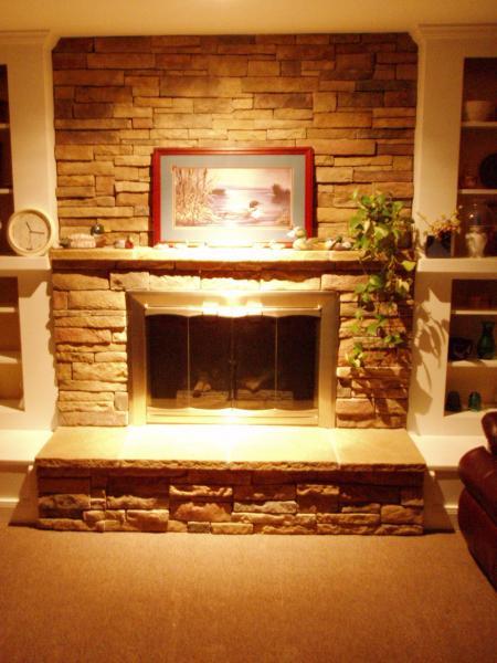

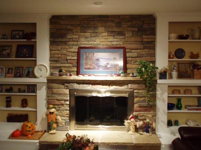

  8. DK | Oct 28, 2005 05:53pm | #23
    JIM
    THIS IS THE FIREPLACE I JUST REBUILT I TORE OFF ALL THE OLD FAKE CEMENT STONE
    AND ATTACHED WIRE MESH WITH CEMENT SCREWS . THEN I MOTORED CULTURED STONE.
    IT TOOK ALOT OF TIME TO FIT THE STONES BUT I ENJOYED EVERY MINUTE OF IT I NEVER TACKLED ANY STONE WORK TYPE JOBS BEFORE AND THIS WENT PRETTY SMOOTH
    GOOD LUCK! DAN

    1. DougU | Oct 29, 2005 01:34am | #24
      Don
      Some how you got that posted twice.
      It looks great. Got any pictures from further back? I'd like to see the shelving units.
      And take off your caps lock!

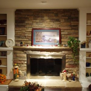

      1. DK | Oct 29, 2005 08:13am | #25
        Doug,
        Here are a few more pictures of the shelves and fireplace . DAN
        1. DougU | Oct 29, 2005 06:07pm | #27
          Looks good Dan.
          Proportionately well done!

      I suppose you could. The uneven quality of the bricks would make it difficult to get the backerboard flat.   It also depends on how much you want the face to be built up.
