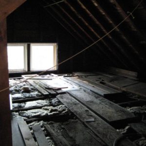

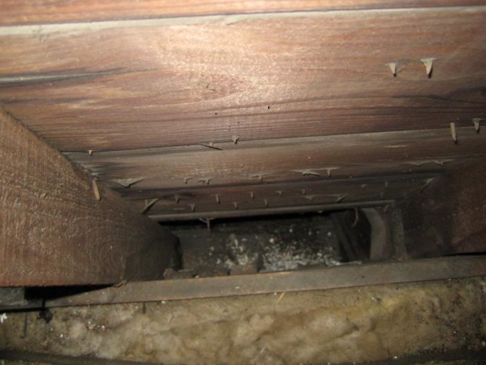

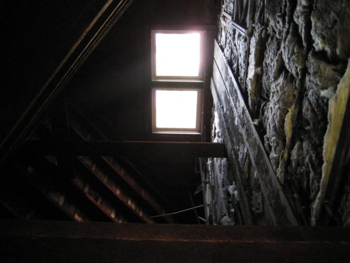

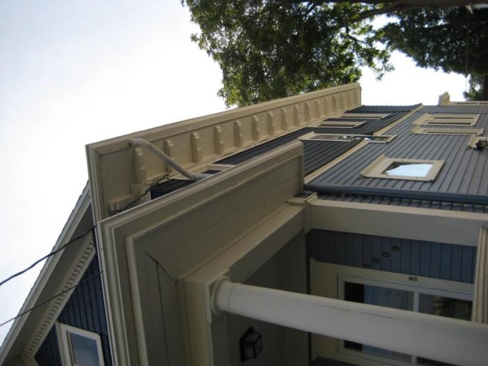

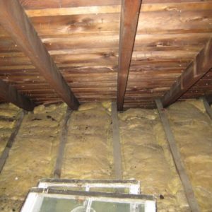

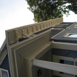

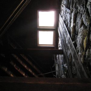

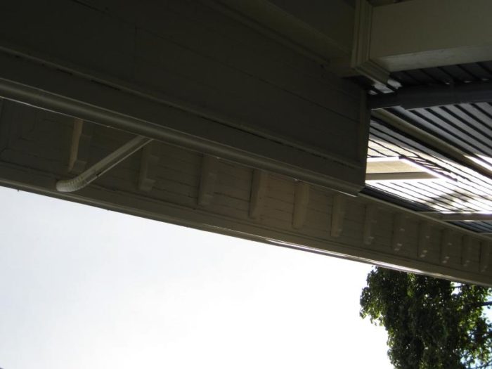

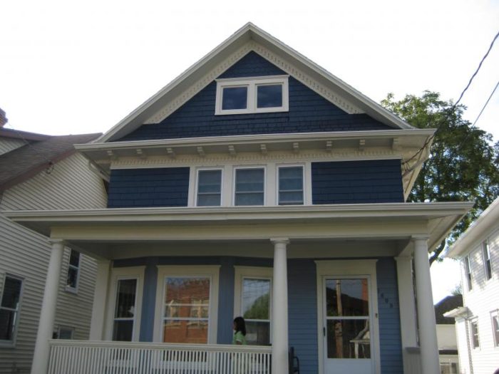

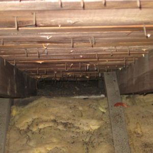

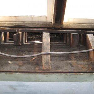

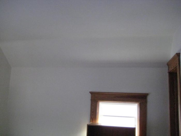

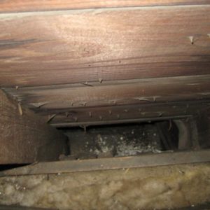

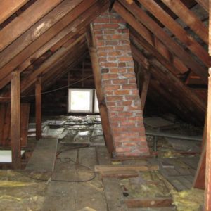

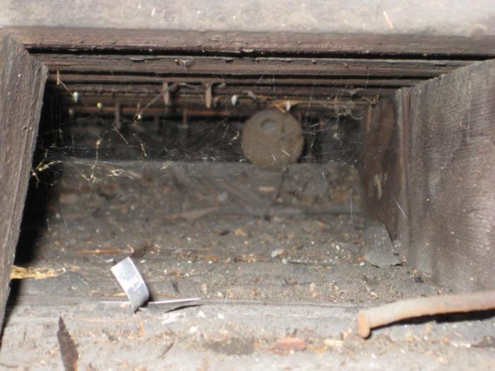

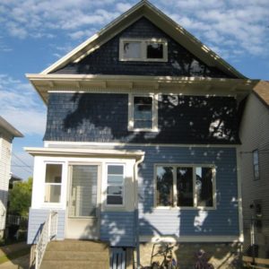

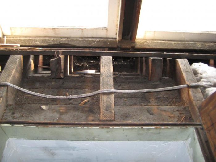

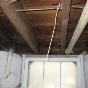

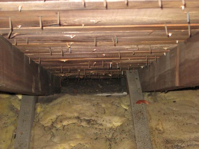

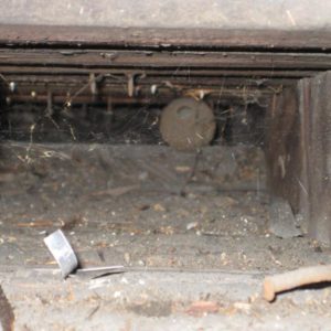

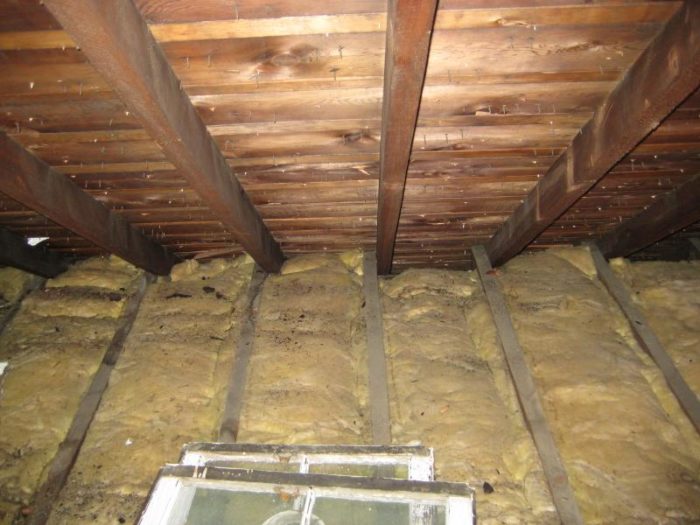

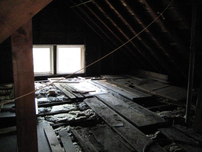

Here’s the pics of my new old house located in Sandusky, Ohio (Cedar Point).  One of my first priorites are to insulate the walls as there is no insulation at all right now. I have had an Icynene contractor, a cellulose contractor (which never even called back), and a tripolymer contractor, USA Insulation Eastlake,Ohio. The Icynene quote was $2400 more than the tripolymer guy. USA Insulation will use John Manville blown in the attic.
What do you guys think? Also there is some knob and tube and the USA guy says no need to be removed prior to installation.

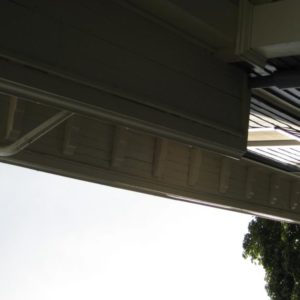

Also there is no attic ventelation what so ever right now. Usa Insualtion  plans to install 4 soffit vents (10″x5″ roughly) on each eave and 2 roof vents and I want to say he said turbine. Is that enough?
 Let me know what you guys think.

    I have no way of looking at photo files that large over my dial up, but here are a couple comments for what it is worth -
    Ifg you are going to the rouble of opening thing up where you can spray a closed cell foam, it would be foolish not to get the wiring updated at the same time.
    If you do decide to faom with K&T wiring, ask an electrician, not the insulator for the best answer.
    As a general rule, closed cell is the very best spray foam insulatioin you can get for mnany reasons

       the walls are in excellent condition and I don't have the time or money to redo right now so they will not be opened up..... although ideally i would like to rewire and drywall.

    It looks like the K&T is only run on the floor in the attic?  If that's the case then you are fine cause you are going to spray the underside of the roof with the closed cell foam right?  No venting you want a hot roof.  Look up buildingsciences.com lots of info there.
    How's the condition of the roof btw?  If if needs to be redone you should do that before you spray the insulation.  Likewise if any of the framing needs to be fixed-reinforced-etc.  If  you don't the roofers are going to punch holes in it when they are re-roofing.  The closed cell manf claim that by filling the bays with spray foam you double the racking strength of the wall-thats nice if its true.

      roof was put on in 2006. attic will be blown in johns manville climatepro

  4. Ragnar17 | Sep 29, 2007 02:04am | #8
    Very nice looking house.  What year was it built?
    1. qtsam2 | Sep 29, 2007 03:23am | #9
      thank you.
      i think 1912, but not 100% sure. i have conflicting dates.
      1. Ragnar17 | Sep 29, 2007 07:04am | #10
        Yeah, I would have guessed a bit earlier than 1912 -- seems about 1902-1907 to me.

            usa will install 8 12x8 inch soffit vents in overhang of home. usa will drill holes in soffit area and place vent over vent holes. also install 4 d/a roof vents

  6. Piffin | Oct 02, 2007 02:33am | #85
    OK, given those three, the cellulose would be the most economical if that is your concern.
    I guess it has not been clear to me so far, but are you insulating walls with existing surfaces still on or gutting things?
    The wiring should be checked and opinion offered by an electrician first.
    Bill Hartman is responding here and he may be able to comment on that
    1. qtsam2 | Oct 02, 2007 06:37am | #91
      well as far as the money goes.... i want the best but i can only afford the middle of the road at this point.  i do want to demo the lathe and plaster but theres no way i would have the time or could afford to that, and re-wire, and insulate.
      what was intially appealing about the usa stuff was the guy says you don't have to rewire with his product ( your right i should have consulted with an electrician first) and that you can fish wires through it later on if need be. so it was like getting the best of both worlds or so it seemed. i could insulate now and then down the road rewire and demo the lathe and plaster.
      so all thinks considered i will probally just do blown in cellulose at this point.
      1. Piffin | Oct 02, 2007 07:00am | #92
        "you can fish wires through it later on if need be."That guy is so full of it!
