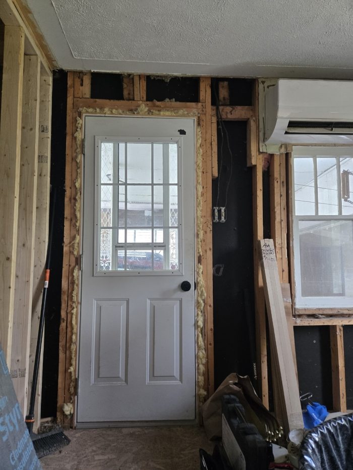

Working on a renovation. I’ll be hanging new drywall on my wall, but the ceiling still has its old drywall which isn’t being replaced. The wall does have a top plate, but it’s above the ceiling, so there’s nothing to fasten the top edge of the drywall to where it meets the ceiling.
Should I add horizontal blocking between the studs at the top for backing, or does it matter?

    You do not need blocking.

    Only if you're going to put up crown moulding
    1. calvin | Oct 06, 2024 06:18pm | #3
      On large crown I made up backer blocks first I could spot glue and tack to the stud and/or joist layout. Slightly smaller than the full blocking space behind the crown.
      On cabinets, that are out beyond stud layout, a necessity.

      Original question? I suppose for a fire blocking concern you’d do it. Electricians coming later for a remodel wouldn’t.
      1. [email protected] | Oct 07, 2024 06:11pm | #4
        Instead of blocking for fire with wood I’d use mineral wool and to get a better insulated wall.

    Thanks everyone! I hadn't even thought of crown moulding in this context, looks like I've got some backing to put up.
  4. calvin | Oct 09, 2024 11:48am | #6
    in reply to post #5
    A single flat block between the studs won’t give you much help with usual crown molding. Standing it upright between the studs would help a bit for fastening the bottom of the crown. But that’s not going to help on the top.
    You’d still be better off adding the angled blocks mentioned above.
