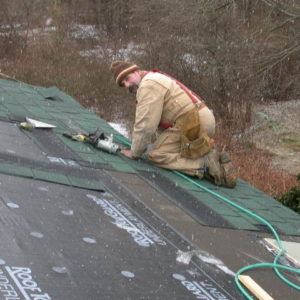

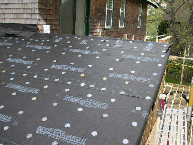

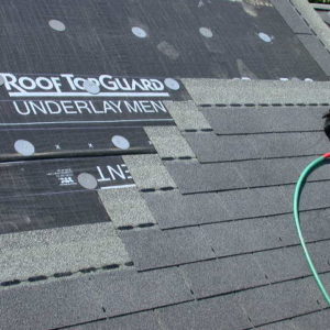

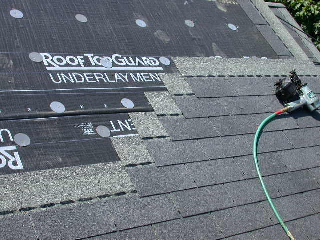

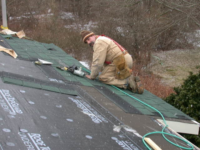

          1. xMikeSmith | Jul 08, 2003 03:15am | #11
            dino....   i like the roof from the top down... but your metal screws that pooch..
            have you looked at the new underlayment fabrics on the market now ?
            the one we've been using is RoofTopGuard II... comes in 5' x 200' rolls.. and a roll weighs less than a roll of 15 lb. felt
            you apply it with roofing tins , and it seals around the nails, and it's tear proof, and you can leave it exposed for 6 months and it costs about $150 a roll...
            i will not do reroofs again without it
             here's some pics  of it in use... Mike Smith   Rhode Island : Design / Build / Repair / Restore

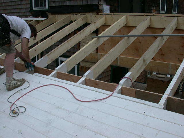

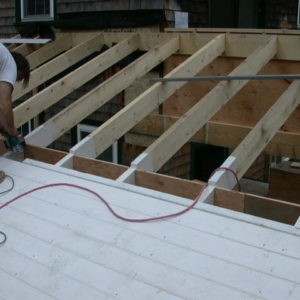

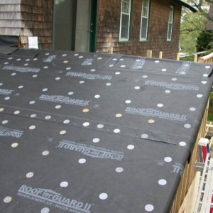

          2. xMikeSmith | Jul 08, 2003 03:17am | #12
            ok , so i got confused about the photo... here's the one i meant to postMike Smith   Rhode Island : Design / Build / Repair / Restore
          3. Piffin | Jul 08, 2003 04:05am | #13
            Yer sounding like a snake oil salesman drumming for a new wonder drug - but that's what that stuff is. I've used it because of your recommendations here and WOW, am I impressed!.
          4. xMikeSmith | Jul 08, 2003 04:25am | #14
            yeah, now how do u buy stock in  finnish company ?Mike Smith   Rhode Island : Design / Build / Repair / Restore

          9. seeyou | Jul 08, 2003 02:00pm | #21
            Look at the cost of tarps, putting them on, taking them off, etc.  The bituthane or rooftopguard (which I'm definately going to try to locate in my area) is cheap  comparatively. I've used it in valleys and for temporary flashings for years. I hardly wake up when it thunderstorms at night anymore.
