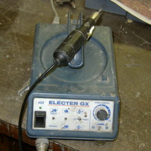

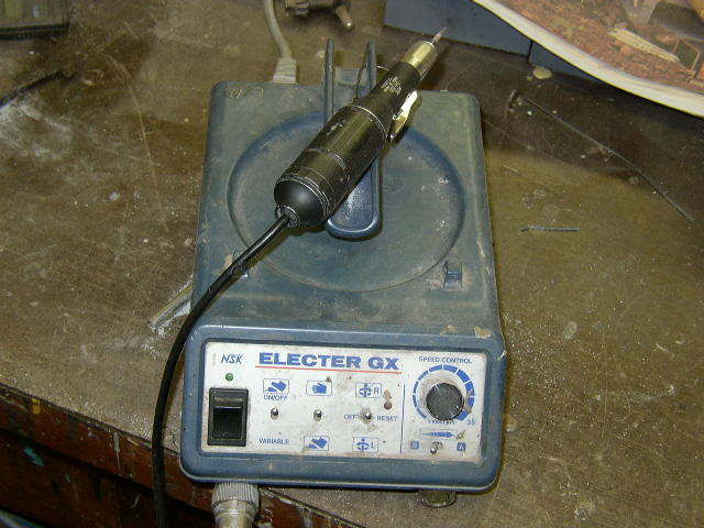

        2. WorkshopJon | May 11, 2003 04:32pm | #28
          "Anyone ever try a Dremel?  They are slim and light and powerfull, ever try a cord and cordless ones?"
          We have a "Dremel like" tool at work. (I'll try to post a pic in a few days after I go back to work) that absolutely blows the doors off a Dremel in terms of speed, power and performance. It has some built in electronics that make it maintain a constant RPM no matter what the load (unless you trip the built-in circuit breaker), just set the speed control (you can vary the RPM from ~100-20,000) and have at it. Half the size of a Dremel and easily 4 times the power, and it's revesable. Neat release for the collet too. Just twist a lever on the body of the tool and the bit pops out.

          8. WorkshopJon | May 23, 2003 12:52am | #37
            Fonzie,
            Finally remembered to take the camera to work. Here are the pics of the tool that blows the doors off a Dremel. Construction of the tool is all metal. It will maintain a constant RPM (~100 to ~35,000) no matter what the load, and doesn't need a chuck key. BTW, on the downside, new it costs close to $1K.
          9. WorkshopJon | May 23, 2003 12:54am | #38
            One more pic,
          10. wrick2003 | May 23, 2003 03:52pm | #44
            man that's cool.     rg
          11. booch | May 23, 2003 03:51am | #40
            Look at the Sears rotary die grinder. it is a dead nut ringer for yours except the housing is made of plastic where the motor resides. The handle shaft is made of cast metal. I got mine a decade ago and it still works fine. 1/4 inch shaft with a 1/8 inch collet and a host of burrs and grind stones all for 50 bucks.
            Upon further review, Sears seems to have gone the way of the dremel. Mine is a different animal than anything I find on their website now. I'll sell it for 500...;-)
            Jack of all trades and master of none - you got a problem with that?
            Edited 5/22/2003 10:52:43 PM ET by Booch
          12. WorkshopJon | May 23, 2003 06:04am | #41
            Booch,
            Can you post a pic. I'm curious. Wouldn't mind something similar at home, but not for $900.00+. I know the Electer has a bunch of built-in electronics to maintain constant speed. Any idea what yours cost new?
            jon
          13. booch | May 23, 2003 06:34am | #43
            Couldn't have been over 40 bucks. Frighteningly powerful. Makes the rotozip look like a battery operated drill.
            I use it for carving with burrs freeform in wood. Works real well until I get it in a hole that is about 2" in dia. The last time I did that I must not have been paying attention cause the next thing I knew it was dancing in the hole (fast). By the time I got it out the thing had a big vibration (30 LB Coho like) then the next thing I heard was bing, pow, zing, thunk. The bit I was using had snapped at the shank. Right where the bit had been stamped with W. Germany. The sound effects were the ceiling, a light, the tablesaw, and a pile of wood. 25000 rpm off center is a fast piece of metal.
            I'll take a photo and get it to you.Jack of all trades and master of none - you got a problem with that?
