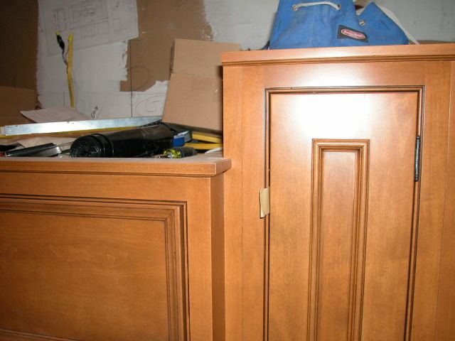

I love to spend a coupla days on an island somewhere out there in the kitchen sea’s …

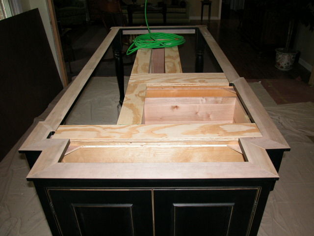

here’s a coupla shots of the latest. Nice combo design of cab’s and table … little bit of framing in the middle.
The decision was made to raise the island up 3/4″ like the rest of the kitchen …

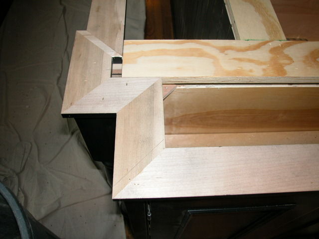

tall family … plus …. added a little more detail. The island raise added 20 pieces of trip and 5 pieces of 3/4 ply filler … my idea was to sand/finish the additional trim stock and use glass instead of granite … but no one else really seems to focus that much on my handiwork?

the top trim ...

The legs are wood-doweled into the hardwood floor. Had a hard enough time getting them in place plumb on both sides ... had to pin nail them in place ... mark the floor ... then take it all apart and drill out the centers and drill the floor. 1/2" dowels are glued to the lags first ... then set into glue in the floor. Nice and solid now.
