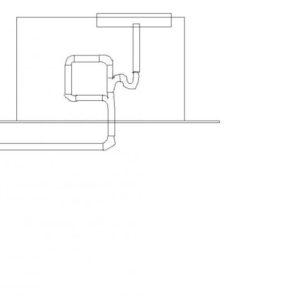

I’m wondering if any of you know what the maximum spacing is from an island sink to the nearest wall. I’ve seen a lot of island sinks that are 50″ or more from the nearest wall. My contractor friend tells me that the drain vent, to be to code, can’t be more than 42″ from the sink, before it goes vertical. I need to know because I’m designing a kitchen, and this distance controls the size and placement of the island Thanks for your help. —geoff

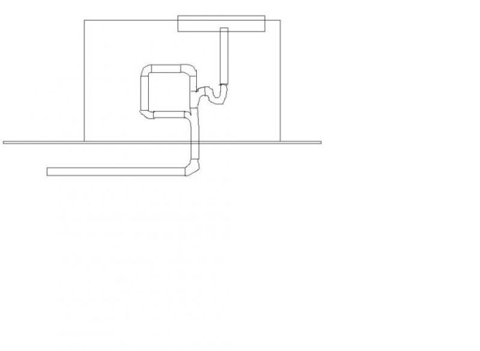

    You need to do an Island vent loop.
    This is top secret advanced plumbing stuff!
    ask a plumber who knows his #### about it and they should be able to show you the details.
    If they don't know what you are talking about, then find another plumber!!
    I will post a pic to give you a rough idea.
    Really rough!!!
    basically as the water goes down the air loops around behind it.
    Wet head warrior should know of these.
    He is DA man.
    Mr T
    Do not try this at home!
  3. sungod | Jul 08, 2003 06:05pm | #3
    View ImageThis is from http://www.codecheck.com  buy the book.  Getting the slope on the foot vent would determind the distance to the wall.  Depth of main drain is the biggest factor.
