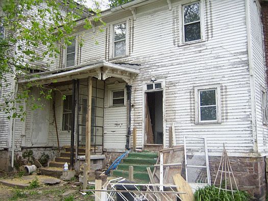

First, a reminder of what I started with in the spring of 2006. This is about all that was left of what was originally a fairly small side porch … no floor, missing posts, rotted roof and ceiling:

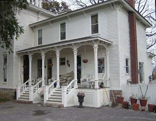

Here’s how it looked last week. The homeowners plan on restoring that center window to its original height, and replace the small window on the right with one to match. It still needs a proper paint job, too:
Another view:

Doood!
Looks super - let me be the first to congratulate you on a job really well done.
Gorgeous gingerbread.
Thanks. I really wish I could have seen the project through to completion. The homeowners had to direct their finances toward other projects and figured they could finish this one on their own. Unfortunately much of wood still has only the one coat of primer that I put on.
Allen
Allen,That looks really good! You got the proportions just right.They may have to clean and re-prime. Some primers say on the can to top coat within a certain period of time.Chuck Slive, work, build, ...better with wood
OK, you can be the first...but put me in that line too!View Image “Good work costs much more than poor imitation or factory product†– Charles GreeneCaliforniaRemodelingContractor.com

Beautiful job. Mike
Very, very nice.
That must have been satisfying. Nice work.. and nice that they bothered to go through the extra expense of restoring something like that at all.
arthur
Allen,
The highest compliment I think is that it could easily fool 99.9% of the people in believing that it was original to the home.
Exceptional work- something to be most proud of.

Wonderful work.
My favorite compliment is "Now this was here before, right?" when they have lived with out it for years, but can't remember two weeks later because it looks so natural. Yours definitely falls under that category.
Looks like it's been there for ever. Great job!
said it before & will again - beautiful & inspirationalI think you are in my niche - take what you think it will "cost", multiply by three and then add for architectural gestures and you might be whole

Wow!!! THAT is top notch. Thanks for sharing.
I'm curious as to some history however. Why the orginal two sets of steps and doors? Was this at one time some kind of multi family unit?
And why, since the orginal porch roof just went over the first door and steps, was the second set of steps retained?
As an aside, any code problems with having no rails? Or where they removed after the final?....wink.
Again, great job. A sure candidate for a FHB article IMO!!
Runnerguy
Runnerguy, the earliest photos we had showed the orginal smaller porch with steps, which I recreated fairly accurately. The second door had its own set of steps, treated similarly with large newel posts, but no covered porch.
The second door opened to a small room that led to a staircase up to the servants quarters.
The current owners wanted both doors to open onto a single covered porch, and they liked the look of the twin stairs that were evident in the old photo, so I designed it to accommodate that wish. I actually suggested using only a single set of steps, but the owners had their heart set.
When enlarging the porch to cover both doors, it was impossible to center both doors within the corresponding "bays" of the porch. But they are close enough to not be too awkward. There's a lot of asymmetry already, so I think it works OK.
As with many Italianate porches, there was no railing originally. This is a rural area, and sometimes it's possible to bend the rules a little. Supposedly railings were required for the "day of the inspection," but I don't think the homeowners even temporarily tacked up anything .
