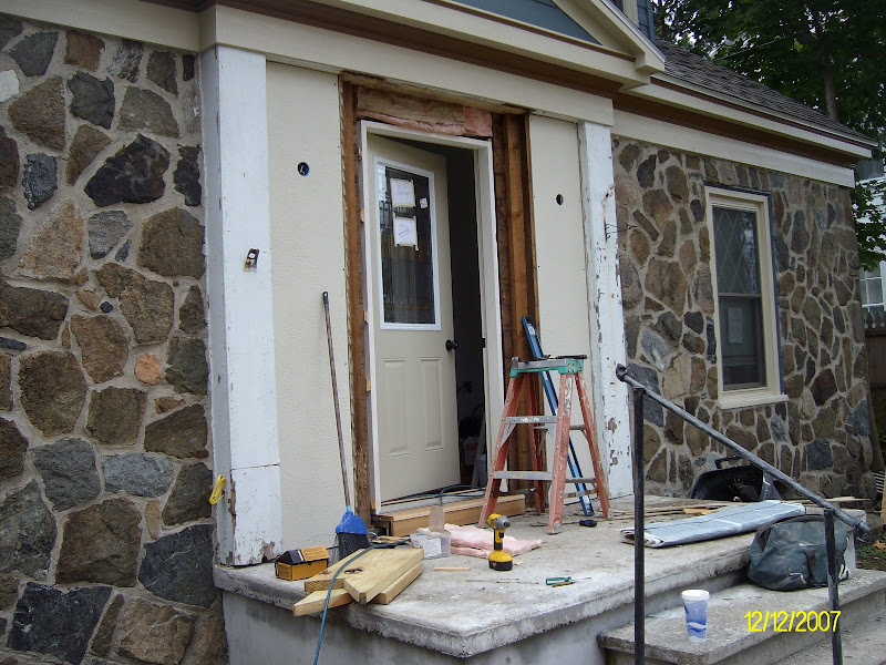

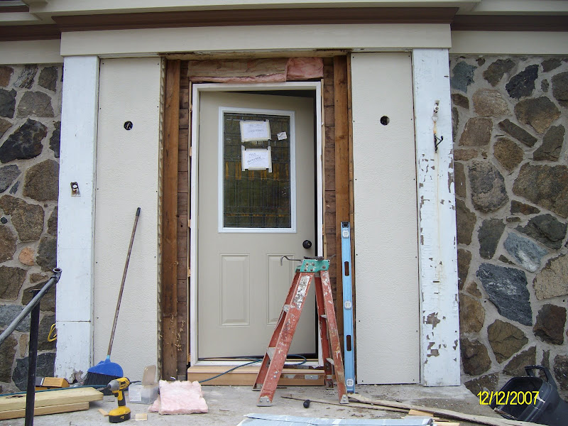

Was arranged to make some fluted colums out of cedar. The tools we have acess to is pretty basic. What the hell I figured I’ll give it a shot.
Front door that this is supposed to go around:

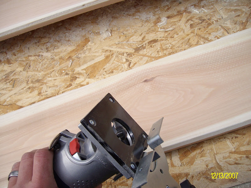

Bosch Colt router. Chamfer bit for the outside edges. Rough stop and squaring techniques
Round bit I found in pile of old bits I own and really never use. This is for the flutes...
Yea I sanded off those rough spots...

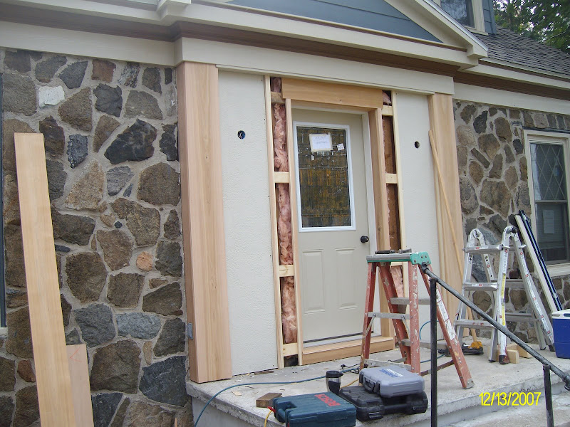

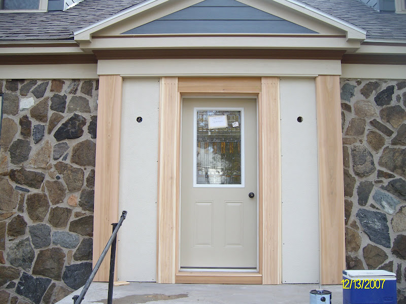

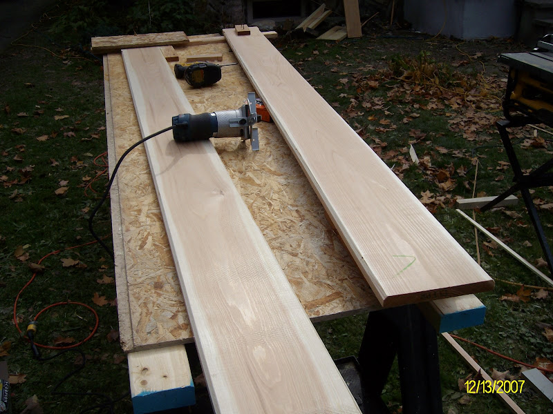

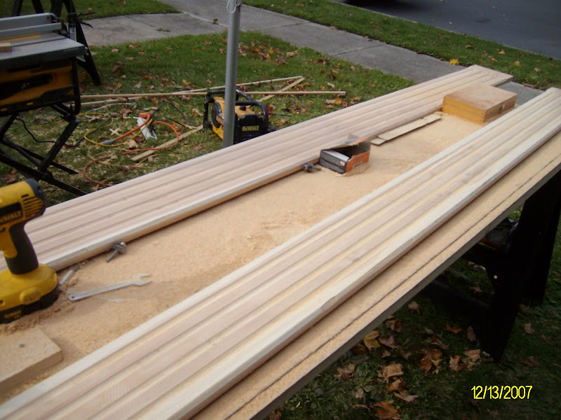

Two boards being made.. Set edge guide for 1 7/16, run one same edge of both boards up to the stop. Add another squaring board onto the left side and pull the one on the right side... run 1 7/16 guided router on other edge of both boards...

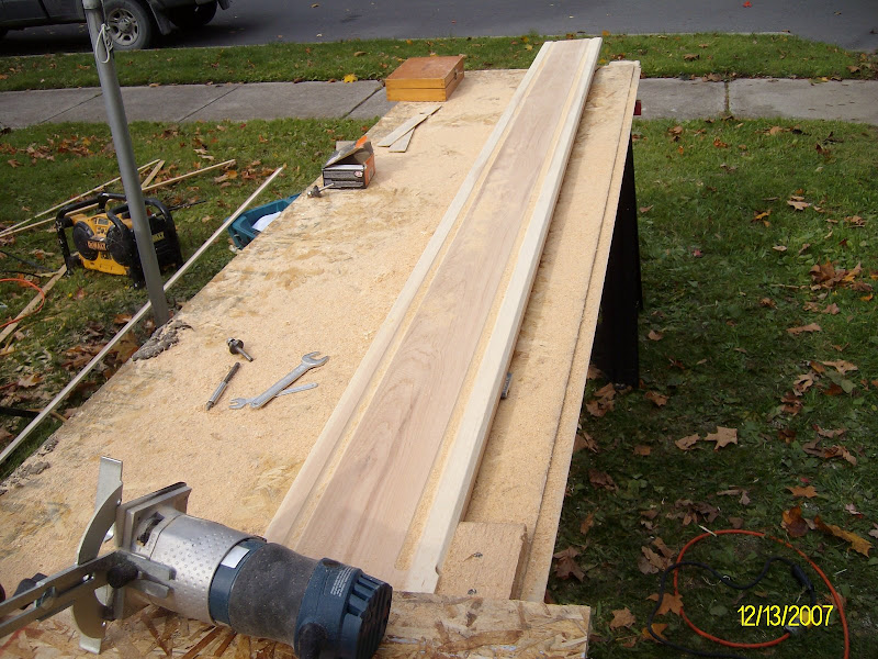

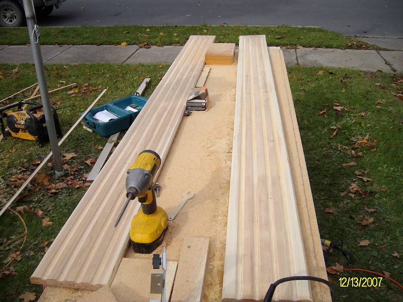

Move guide to 2 7/8 Repeat process routing both boards on same edge moving holder to other side and routing other side for the center two flutes
I wish I had taken a few more pics but I was wrapped up in the process. Came out pretty nice... had one spot on tearout it was on the edge and real easy to see in one of the pics the flutes came out real nice. I was able to sand out the tearout pretty good. couldnt even tell.

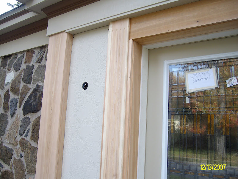

Still needs some trim to be done completly.. ill take pics if anyone cares ;^)

i care enough that i've got a few questions. why no flutes on the outer columns?
why do the flutes stop short of the top but go all the way to the bottom?
maybe the finished photos will answer those. bring'em on!
Seems more common to stop flutes short at the top and run through on the bottom or cover with pith block. Doing same on outer columns I think would be too much going on there and wouldn't look right doing all 4.
Probably the best answer I can give you for that is- thats what she wanted. Its pretty much like it was originally, house was built in the 40's, this stuff was getting pretty rotten.
I brought up doing something to the outer columns, she thought it would make it too busy. Ive got to go back sometime and put some trim around the top of the columns and some to cover the screws that hold the stucco looking hardie on. It takes her a while to make up her mind so im not sure what the trim is yet, at least shes happy with her decisions when its done, no going back and changing things.
You can kind of get the idea from these pics, if you want heres a link to some of the other pics of the house, you could use magnifying glass to check it out better.

Nicely done. Really makes that entry inviting, now.Love to see some more pics. Especially of how the fluted boards fit up against your trim header there.'Man who say it cannot be done should not interrupt man doing it' ~ Chinese proverb

I see you left room for caulking twixt the wood & masonry on everything. Use a quality caulk.
