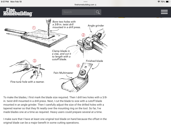

      1. user-5619319 | Feb 19, 2024 06:48pm | #8
        >Cut up the Japanese saw ...> Now that's a thought. It hadn't occurred to me that I could make the blade on such a saw narrower. Do we know what type of tooling it took to cut a steel draw saw blade parallel with the cutting edge across any significant part of it's overall length?
        1. calvin | Feb 19, 2024 09:54pm | #9
          Did the link work for the tip?
          TIPS & TECHNIQUES
          Inexpensive Multimaster Sawblades
          Issue 192
          twitter facebook linkedin pinterest email add to favorites
          One of the most useful devices I own is the Fein Multimaster oscillating tool. The problem is that when I accidentally run a sawblade into an unseen nail, the teeth become chewed up and pretty much useless. Recently, I’ve been making Multimaster replacement blades from relatively inexpensive ($20 or so) Japanese saws.
          This type of saw cuts on the pull stroke and typically includes coarse teeth on one edge and fine teeth on the other. I can get the equivalent of about 10 replacement blades from one of these saws. Ten regular replacement blades for my Multimaster would cost hundreds of dollars. Because the Japanese saws have two types of teeth, each of my shopmade blades does double duty.

          To make the blades, I first mark the blade size required. Then I drill two holes with a 3/8-in. twist drill mounted in a drill press. Next, I cut the blade to size with a cutoff blade mounted in an angle grinder. Then I carefully adjust the size of the drilled holes with a tapered reamer so that they fit neatly over the mounting ring on the tool. So far, I’ve made blades one at a time as required. Heavy users could prepare several at a time.
          I make sure that I have at least one original tool blade on hand because the offset in the original blade can be a major benefit in some cutting operations.

          1. user-5619319 | Feb 20, 2024 10:43pm | #11
