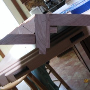

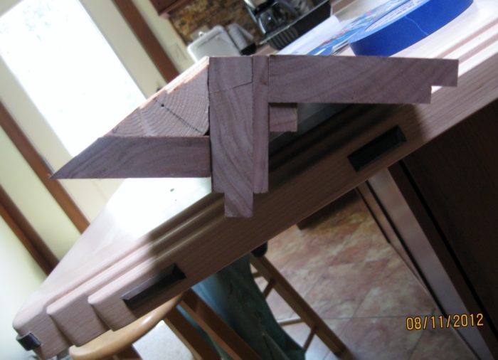

    Here is a photo of a mockup of the moulding I want to make.  The slanted surface goes against the underside of the rafters.  What do you call that part of the "ceiling"?
    Seems I must cut the spruce pieces in short sections stuck to a guide peice with carpet tape.  Only way I can see to accomplis  the job and keep my fingers.
