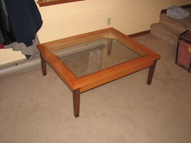

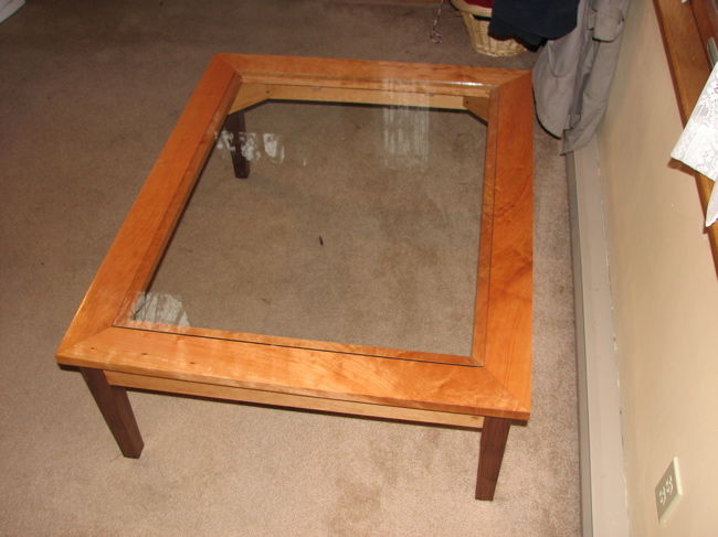

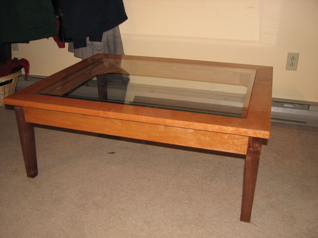

When we moved a few years ago, the wife chipped this glass on our coffee table. It went to the glass people who trimmed off the damaged part and I promised to make her a new table for it. Time came to pay up.. It’s cherry and black walnut. Made it last weekend and finished it during the week. Nothing special considering the posts from guys like Stan, etc., but I had fun making it.

Very nice. What's the finish?
sealed with a wash coat of clear 2 lb shellac. 3 coats of brushable satin lacquer from Cabot. Wife did not want stain. It really warms up the living room...she was right!!BTW, I think I just read a very good article you wrote in FHB if you are the same Mike Maines???!!!“At its most basic level, capitalism offers people the freedom to choose where they work and what they do … the dignity that comes with profiting from their talent and hard work. … The free-market system also provides the incentives that lead to prosperity -- the incentive to work, to innovate, to save and invest wisely, and to create jobs for others.†-President George W. Bush

What kind of joinery did you use on your table? I see angled corner blocks, can imagine pocket screws or biscuits for the leg-to-rail joint?
Yes, I did enjoy your article, and will continue to as I re-read it.
I used straight mortice and tenon joints on the leg to rail. I reinforced the connections with the corner blocks as I don't think I used tenons long enough for the design. I used 1/4" splines (1/2 blind to the corner) on the top 45 degree joints so that I felt comfortable with the glass having enough support. Originally, I wanted some form of lattice support under the glass, but I couldn't make it work AND look nice. So I enlarged the lip from my original 1/2" to 1" on the top, used a spline in the joint instead of biscuits. That seems to have worked as the table is very stable. I've had several inquiries from wife's friends so I just ordered some more 4/4 and 5/4 cherry. Always nice to have a working "model" as it were. Thanks for your interest!“At its most basic level, capitalism offers people the freedom to choose where they work and what they do … the dignity that comes with profiting from their talent and hard work. … The free-market system also provides the incentives that lead to prosperity -- the incentive to work, to innovate, to save and invest wisely, and to create jobs for others.†-President George W. Bush

Nice! I like the walnut with the cherry. Built a few similar to that. Done both apron, and M&T to the legs. Watch the Windex used to clean the glass getting on the lacquer until it cures for at least a month. If you break that glass, try some dark "smoked" glass. Can't see the spots on the carpet underneath that way. ;-)

Well done. Simple clean lines. Beautiful!

Nice piece of work.

Could you put some maple veneer PS strip from Depot over the edge of the corner blocks where the screws are?

Excellent point...the answer is yes.“At its most basic level, capitalism offers people the freedom to choose where they work and what they do … the dignity that comes with profiting from their talent and hard work. … The free-market system also provides the incentives that lead to prosperity -- the incentive to work, to innovate, to save and invest wisely, and to create jobs for others.†-President George W. Bush

Nice work and design balance. Talk about a Conversation piece, you've made it so a person could place a stained and finished sheet of 1/2" thick furniture grade veneer plywood supported on those corner blocks.
Think of all those small collectibles that a "shadow box" style like yours could showcase dust free under that glass!!

Nice idea!! Why didn't I think of that?? That would be too cool, I think. next one......“At its most basic level, capitalism offers people the freedom to choose where they work and what they do … the dignity that comes with profiting from their talent and hard work. … The free-market system also provides the incentives that lead to prosperity -- the incentive to work, to innovate, to save and invest wisely, and to create jobs for others.†-President George W. Bush

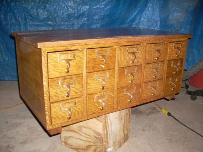

That's funny, I just finished a coffee table for myself! Well, the only things I made were the top from a leftover flooring project and the feet. The carcass, drawers, and hardware I just refinished and repurposed from an old card catalog.
Man! Do I know a retired school librarian that would kill for that table and idea!! Well Done!!!

Thanks Bill...Fun project
