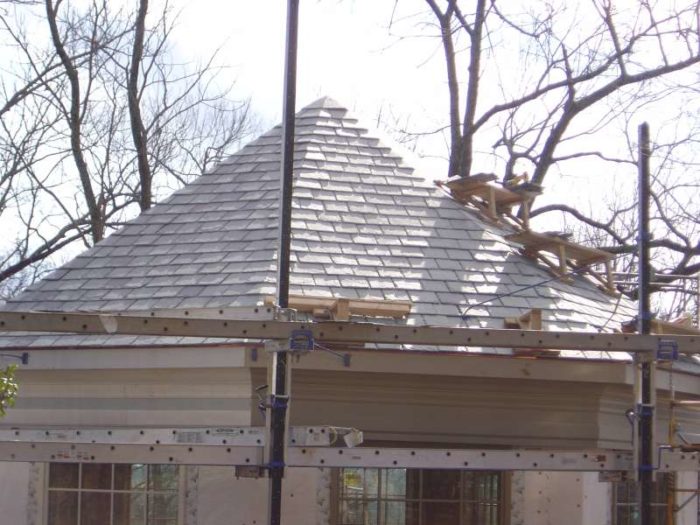

What we have is this octagon , but like a race track oval, 10/12 and them 18K doors I was talking about…and I have never seen such a sloppy, muddy jobsite in 25 yrs of mucking on sites.

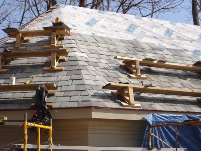

I borrowed the jack idea from Slateman, and modified his design a bit..they really work well, Thanks Walter.
We lose a lot of time on the hips, cutting the angles ( the framers did us NO favors, like being consistant..’nother rant) and the staggered sizes are a challange, we have 9”,10”, 11” and 12” …green, grey and purple. All in all, I think it looks pretty good, I have not hung slate in a LONG time.

The sheathing is OSB w/ Titainium UDL. The framers musta had a real bad day, very few nails actually in the trusses, lotsa hips out of plane, angles off..yuck.

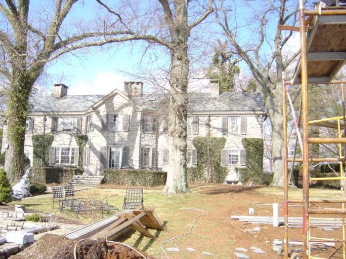

Hi Sphere, man what a castle. Its been my experience that only the real deal craftsmen are allowed to work on these beauties in the Bluegrass.
The majority of my customers seem to have the mini-mc mansions.

WOW - so, what't that you are building? The searvent's quarters? Any Rolls parked in the driveway?
Super nice work... What do you use to cut the slate for all those hip pieces - they look perfect... mason't wet saw I'm guessing? Another DA Q: where the pieces of slate are nailed in place, do you pre-drill for the nails, or do you somehow punch a hole and then nail?
BTW - is Grant the same as greenCU?
I'll answer. They're using a slate cutter some, but a grinder with a diamond blade mostly. Using the grinder allows the off fall to be used else where and this was some expensive slate. I didn't want to buy anymore than necessary. You punch a hole in the slate with a nail punch, the punch on the slate cutter, or the sharp end of a slate hammer. I am the same as greencu.Birth, school, work, death.....................
http://grantlogan.net/
And for the narrow tops of the hip pcs. we can't dare to punch the holes, I use my Hitachi impact driver with a 3/16 masonry bit, it never really gets to impact mode, but the high speed is faster than any of my drills, and we break far fewer that way.

It is called a pool house, but from what I gather it is mostly an excercise room with sauna and stuff downstairs. latest figgure I heard is 400K for the works. The HO's don't live there full time, they are in Cincy, OH.

awesome stuff you guyshow do you keep your staging up there?
Copper straps nailed above the course of slate. They cut them off flush with the bottom of the slate when they remove the jacks. Hats off to slateman for that tip.Birth, school, work, death.....................
