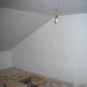

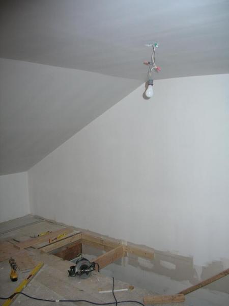

In the photos below you can see where I’m framing in the floor where the shower will go. Its gonna be about 36″X 60″. Gonna install lead over 3/4″ ply subfloor and then pour my sloped mud job then tile. Gonna use glass block for the dividing wall. The entire bathroom will be approx 8’X 8′ with about 1′ under the flat part of the ceiling and the rest goes under the sloped part of the ceiling.

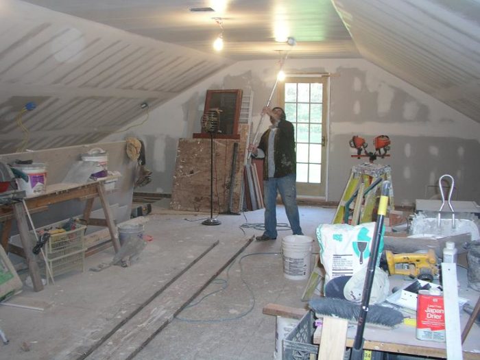

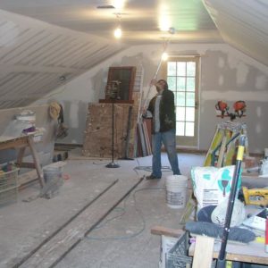

    Hey Andy, Totally unrelated but what are you using the japan drier for? Oil paint?
    1. andybuildz | Jan 31, 2007 03:37am | #51
      Hey Andy, Totally unrelated but what are you using the japan drier for? Oil paint?<<<<LOL...I thought someone was gonna ask.
      I had to do some touch up staining on my deck railings I installed just when it was getting too cold to do that so I added a little Japan dryer to speed it up a little.It worked great btw : )
      PO "I dunno guys. Methinks some people have way too much extra time on their hands". Jer
