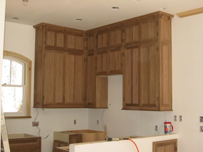

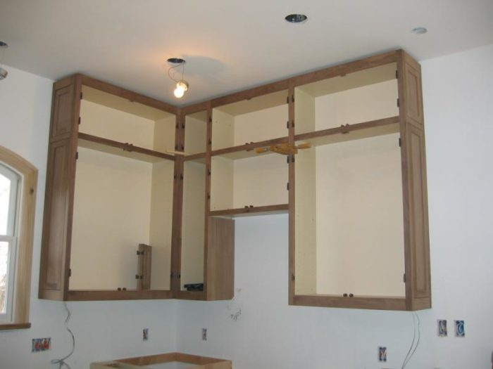

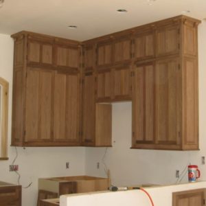

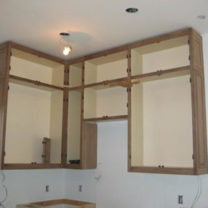

            Here is a couple pictures of some cabinets that I built using particle board, this is the best grade of particle board available, didn't come from the big box stores.
            In  this case the HO wanted the melamine on the inside of his cabinets so this was the only practical way to achieve that.

            Really nice!

          5. dinothecarpenter | May 14, 2006 12:38am | #27
            Doug.
            You got the best of both. clean interiors with the traditional look.
            WHO made the cab's for you? ;)

          6. VaTom | May 14, 2006 05:07pm | #34
            Those are nice and crisp, what we'd expect from you.
