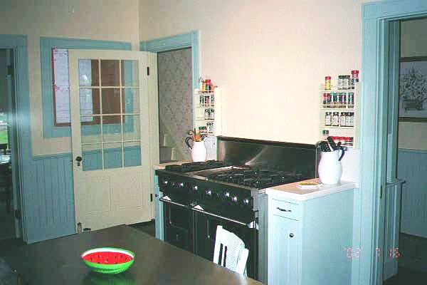

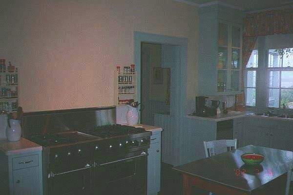

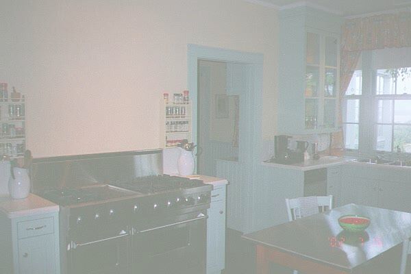

The challenge was to take a nineteenth century kitchen that looked more like a slaves quarters and turn it into something functional and pleasing to the eye.
It had a breakfast room to one side but it was isolated from the formal dining room with only a small c.22″W passthrough to the butler’s pantry. The old wealthy never entered the kitchen or co-mingled with the help who worked in there, especialy in the heat of summer. The butler’s pantry was used for storing dinner plates and for serving by the nicer help.
Where you see here a new gas range, the old kitchen had a five foot wide coal cooking oven. Just to the right of it was the pass through window where I added a pocket door to allow access to the dining room more directly.

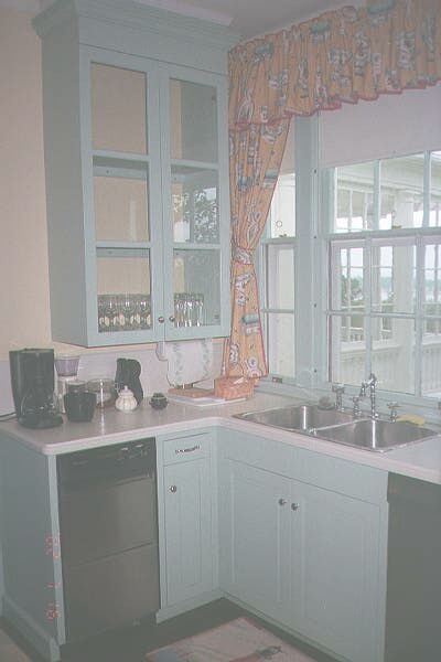

edit- I should add that there used to be an old slate sink along the wall to the left of the new sink. I was likewise about five feet long and had three bays in it.

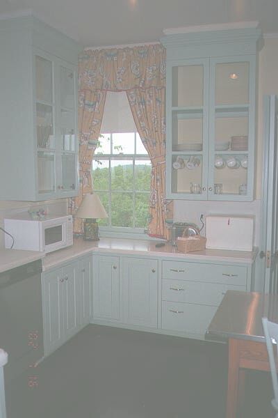

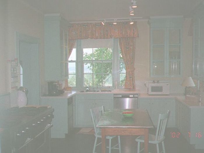

One of the challenges was that I was not allowed to move opennings into the room. The exterior of the house (I'll do another thread showing the facade) was very symetrical. I lerarned from measuring and reducing the house to CAD that it was very precisely and mathematically laid out with a balance.
So the windows in the kitchen were a little off balance as seen inside. Galley slaves don't need niceties, I guess was the view of the old archy.
In this shot, you see a wall cabinet that I diod not originally design or build in but two years later, they had me add it for more storage and convenience, even though it impinged on the view. These wall cabs are 14" deep because they hve larger serving plates to eat off of than most of us do.

I like the range...48"? Your cooks (or maybe the cleaning staff) would appreciate something on the wall that lends itself to easy cleanup behind that beautiful range. The stainless steel covered work table does impede traffic but it's a great work space.
I like your deeper upper cabinets. Most of my platters end up in lower cabinets because they're too wide. Nice country kitchen.

What I'm suprised at is that no-one mentioned that there is no exhaust fan above the range. There are few of them used here because these places were built for summer use before the advent of air conditioning. Flow through ventilation with high double hyng windows on boith sides to make use of the sea breeze let the heat out pretty well.
Those countertops are Corian Solid Surface. We considered Stainless Steel for next to the stove. Never thought about behind it! I might mention it some day..

Thought maybe you had a downdraft vent, couldn't tell from the pics...my eyesight's been gone for awhile. It's not just the heat that needs to vent, it's the "grease". Most commercial vents run into the $1000's but I recall a FHB article where an innovative and cost-minded Canuk fashioned his own custom stainless steel hood. (I can dig it out if you're interested.) There are a number of fan units available.

I too was wondering about the lack of range hood. Even with natural cross ventelation, don't you get a lot of grease build up on walls and cabinets, especially with high powered cooking?
Modern "enlightened" people don't fry any more.

You oughta see the refer if you think the range is overkill. This guy owns a chain of restaurants so he had to have heavy duty, comercial stuff. The 3/8" copper we ran for gas supply wouldn't run it very good. We had to replace it with 1". That range is considerably smaller than the one we took out though and it's probably justifiable. When they throw a dinnerparty, there is some serious cooking going on! I always make sure that I get to meet the new cook at the beginning of each season. ;)
That upper detail is unique and has a story to go with it. The old plaster ceiling was out of level by an inch or so and it had water supply pipes suspended just below it on one side of the room. I planned to lower the ceiling by five inches to level it out and hide the pipes so the crown attached at that level was intended to be the flush to ceiling trim. That was the size cabs I designed. After they were in production, the owners told me that they wanted that old ceiling left exposed to highlight the oldness so I built mini soffits to fill the space and trimed them with the same bedmold in the balance of the room.
Everybody loved it and the cooks he hires every year tell me that it is a good kitchen to work in for layout. Of course, the view helps.

I like the uppers in that kitchen, man that stove is bigger than my truck!
I think I like every kitchen that doesnt look like it came from a big box store.
Good job with limited space, I like it.
PS, is that water melon I see on the table in that first pic?
Edited 1/4/2003 1:38:35 AM ET by Doug@es
I had to go back and look. It's a fruit bowl painted to look like a watermelon..

Nice work. I'm kind of confused on the trim detail over the upper cabs. Is that a cove above and behind the crown?
Don
It is bedmold to ceiling and crown on cabinet.
See second paragraph of post 4 for reason why..

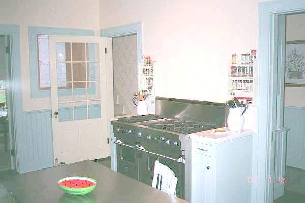

Just a test. I darkened this one using the "Gamma" adjustment under the Balance options in MS PhotoEditor. Not the best editing package in the world, but one of the easiest to use.
Wow! I think that's darker than the original!

Hmm, I haven't used infraview, so I don't know if both packages use the term "gamma" the same way. I try to manage balance by adjusting both brightness and contrast. The gamma adjustment in Photo Editor does a better job with less fuss.
Difference in monotors also have an impact on the display of images. The Kitchen image that I modified was not overly dark displayed on my monitor. Play around and see what you get.
Wasn't infraview a freebe from somewhere? I guess I should download it and play around with it a bit.
I just downloaded Irfanview. Gamma seems to do the same thing, try that next time. I certainly was as easy to do that as in PhotoEditor, resizing is also easy since it will default to proportional resizing and the cropping tool is usable. Bargain price too!

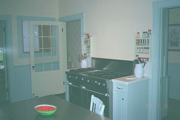

Is this any better ?
Quittin' Time
That's nice. Still just a bit washed out on my monitor, but much better contrast.

Really man, my digital is not too bad for $250 but these were from archived on 35mm with a floppy prepared by the developer, Clark Photo at only 72 DPI.
I shoot most jobs with both cameras but this one I onmly had the one camera that day and the older shots from when I did the work were amoung those lost in the system crash I mentioned once before.
Not too bad on your restore try but when the original hasn't got much, this is what we're stuck with..

Hey, nice job Piff, but you need to be a thin cook to work there;^}
I can't tell from here, but If the range is Viking, it is most likely 0 clearance. In the most recent kitchen I completed(see post for Cherry kitchen), the client is a pro chef/cooking school owner, and had wanted to use the stoves she already had. It was impossible to do because the industrial version of the stove required something like 10"clearance on three sides. That was a big no-go. They ended up with a 3' and a 4' Viking side by side.
Thanks.
About the skinny comment, I originaly didn't plan a center table. In my mind it just gets in the way but the lady of the house found it out in the shed and had it covered with stainless to stick in there for some reason. She said her sons like to eat snacks right in the kitchen.
Now with a breakfast room to one side and a formal dining room to the other side, I ask myself why would a young man want to eat right smack dab in the middle of the kitchen, getting in the cooks way?
Suffice it to say that these girls hired to cook manage to decorate the kitchen with their presence too..
