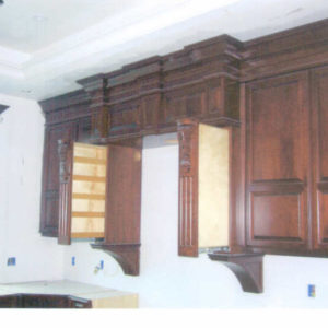

  11. DougU | Jan 19, 2006 06:45am | #18
    Connie
    Here is a picture of some cherry cabinets that we did that has a 9" crown buildup.
    sorry the pic is a scan so its not all that clear.
    Edited 1/18/2006 11:00 pm ET by DougU
    1. connie363 | Jan 19, 2006 10:39am | #19
      Thank you! That helps to see your pic. Was that soffit built first and cabinets installed after? Forgive me if this seems an obvious question. We have 10' ceiling adjacent to a vaulted ceiling family room, so am afraid building a lower 9' soffit would look out of scale with the high ceiling room next to it. That's why I'm trying to figure out how to build the cabinets up higher or else possibly add a wide ceiling crown that comes down. I have photos and will attempt to attach them.

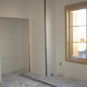

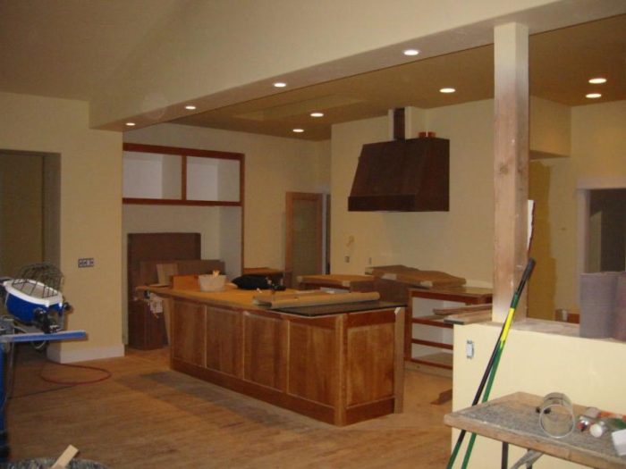

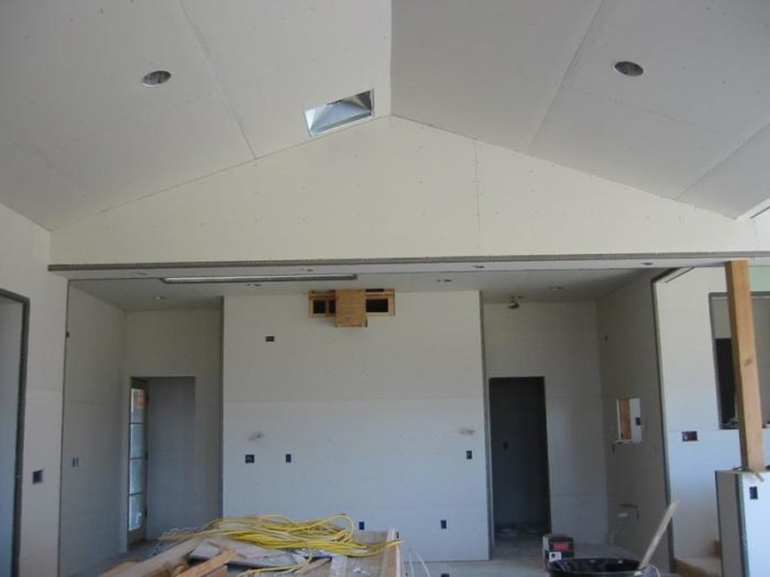

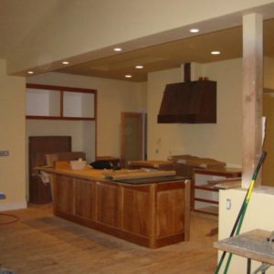

  13. Tejanohombre | Jan 19, 2006 07:02pm | #23
    Hi Connie!
    I'm in the process of building our new home and just ordered the custom Cherry cabinets last week. Also have 10' ceilings but what I'm planning to do is lay in simple flourescent fixtures on top, out of sight. Also planning for undercabinet downlighting as well. In preplanning, we ran all the wiring with the switches in one box for the uplighting, downlighting and recessed cans. This way, you can get several different light effects at one time. Personally, I plan to use the uplights for sort of a "night light" effect as I just like the flourescents better than the rope lighting. (Ropes just not bright enough IMO) Also plan to add some greenery and other items on top as DW sees fit.
    Just a thought but if your cabs end at 105", you're only talking about 15" of space. Are you doing any crown moulding in the kitchen? Ours is a two piece moulding and comes down a pretty good ways softening the look of that bare space. Anyway, just a thought...
