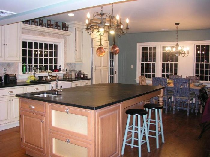

When I put my kitchen together I made my island just under four feet from the sink counter and its absolutly perfect!!! Not too close and not too far. Did I say perrrrrfect?

nice work/kitchen....
what are the countertops?
thanks
p

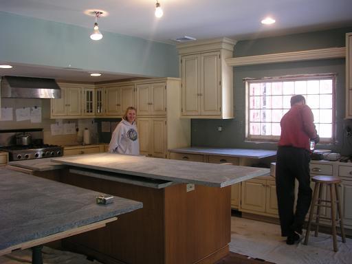

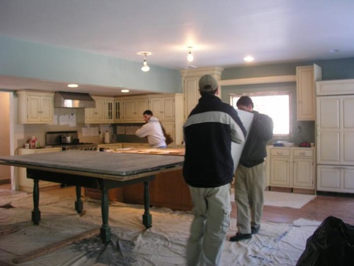

They're soapstone. And if you're willing to fabricate them like I was you save more than half! Here's a picture the day they came. Beckman happened to be here visiting and he helped us carry them in. Took like six guys to carry that island slab maybe twenty feet...Whewwww. That suff is heavier than granite.Soapstone is "the most" dense stone of all contertops. It can scratch but it can also be easily sanded then you add mineral oit to finish the tops.

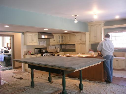

Sorry...didnt mean to hijack Pino's thread...yeh...I bought just the slab totally unfinishedView Image

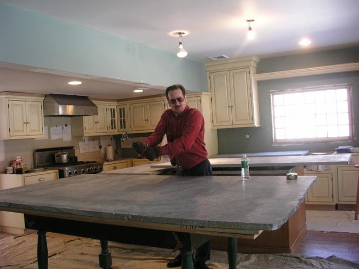

A hijack most appreciated. That is some beautiful work on your kitchen Andy. I too am interested in how you fab'd the soapstone. >>>>>thanks Pino...Its like anything else. Just take your time. Anyone can do it (Katrina says I say that about everything I do...lol). Just support the stone real well on all sides of the piece and all sides of the cuts.
USe one of those cheap stone carbide blades in your saw and make several passes. If you can do it out side that's the best. The dust is intense. Same dust as talcum powder so your skin feels like a babies azz when you're done. Really.
Then get out your belt sander and start with a 60 drit and work up till you're satisfied. Then go to a ROS doing the same. You can route the edges if you want but I wanted to just ease over the edges with sandpaper for my house.
Cut outs are the same...use your jig saw and appropriate blade... all can be gotten at HD as well as drill bits to put faucet holes in.
Soapstone is the most dense stone of all yet does scratch but not terribly easily if youre careful. Any scratch sands out real easily and you dont need any machines to sand unless it's a bad scratch.
Clean off all the dust and use mineral oil to get the finish.
There's special glue you can get from your supplier to glue pieces if need be.

Be aware: You'll need a lot of guys for island sized pieces. Dense=mega heavy!!

Heres a few more pic...one where you see a corner I glued together and after oiling it I saw they were never going to match. Not even close...ugh. I'm oiling it for the fourth time in that picture before I had to cut them apart.
Bye the way...counter to counter I have about 46-47 inches and its really perfect. I could have spaced them way further apart but I set up pieces of plywood on saw horses first and got the feel before I was set on where I was going to install the base cabs. Totally perfect. Definitely not closer!

Andy.. Nice island, I like the contrast between the painted cupboards and the the island, the white glaze tyes them together real well, Good work

nice kitchen...too bad about the blue stools (G)
nice kitchen...too bad about the blue stools (G)>>>>>>>Thought Katrina was gonna kill me for ruining her new ten dollar stools.
Decided to use some black spray I had in the shop and spray the tops the same color as the soapstone and had paint left from the walls so I painted the rest with that. You know how it gets with a spray can staring you in the face and ugly cheap stools sittin' right there <W>
actually...now that I look at that picture...The walls and the stools are really green, not blue....not even close to that picture...hmmmm
