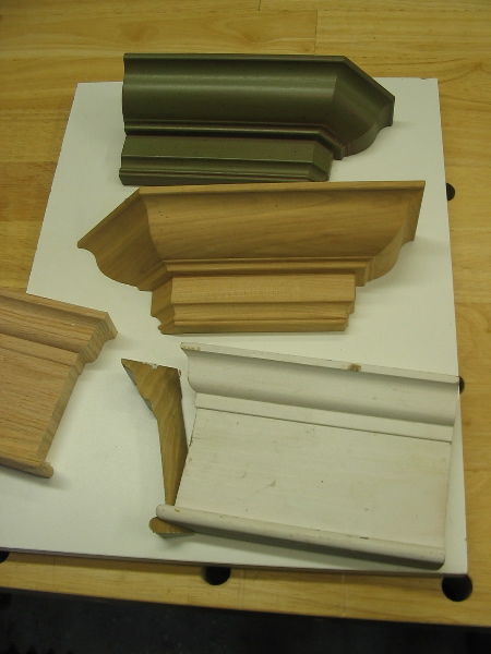

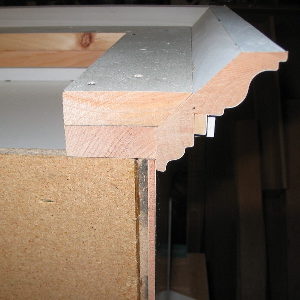

    hammer1 | Jun 21, 2011 10:42pm | #2
    Construction adhesive like Liquid nails , Power Grab, etc. works well for both applications. A backer added to the top of the cabinets helps with crown, especially when there isn't much purchase on the cabinets.
    1. Jake0358 | Jun 22, 2011 06:45am | #3
      Crown Backer
      Hammer,
      Thanks for taking the time to put the pic In. I was thinking of doing the same thing using a 2x4, but after seeing your photo I think using two pieces of 1x would have more stability.

        hammer1 | Jun 22, 2011 01:25pm | #5

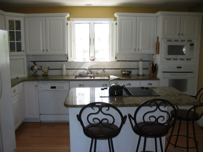

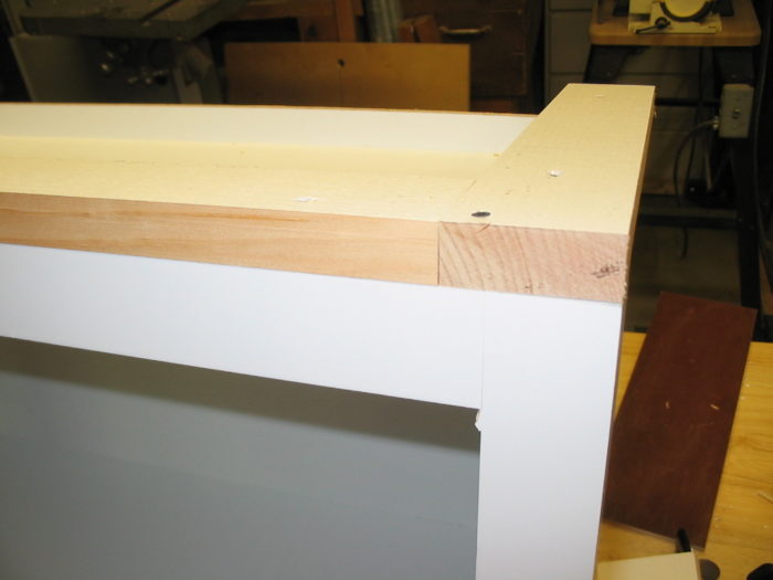

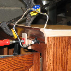

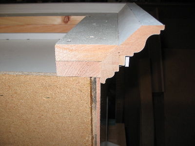

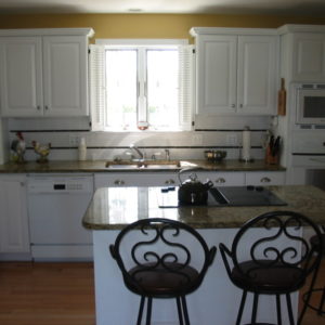

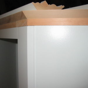

        It all depends on the situation, Jake. On some cabinets, the overlay of the doors don't leave any room for the crown to overlap the faceframe, same with euro style, other times there is plenty. Sometimes I will use nails and pins other times I just use adhesive. It only takes a thin bead of adhesive. For the miters and mitered returns, I prefer to use an all purpose adhesive, comes in a small tube, rather than a water based woodworking glue since glue may cause small pieces to warp. Just press together and hold a minute. There are times I scratch my head looking for ways to clamp things up until glue sets up. The Power grab adhesives do just that and clamping may not be necessary if the crown isn't too heavy, long or warped.
        On the white cabinets with dentin crown, there wasn't much room to overlap the crown. I made the backer in two parts, the first piece was screwed to the faceframe, after that the second piece was easy, you just want to get the angle ripped accurately. Watch out for faceframes with pocket screws, hate those things. There is a pic of an oak job where there was plenty of overlap room but I added a single beveled backer for strength. Folks often put stuff on top of their cabinets and a less solid crown attachment might get knocked loose. There is also a pic of a white kitchen where there was no room for a crown. I placed a piece of plywood on top, traced around, cut it and added the crown to that. It's installed as a separate unit. It's always nice when you can work on the bench rather than after the cabinets are installed but that doesn't always work.  Helps to have a close quarters drill when installing a backer after cabinets are up since there isn't a lot of room between the top of the cabinets and the ceiling.
