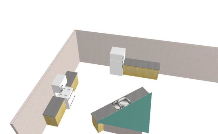

    1. confused2 | Aug 15, 2008 08:05pm | #5
      So here is the plan design (with scribbles). While I don't drink beer, the keg might be an interesting feature :)
      1. Piffin | Aug 15, 2008 09:37pm | #9
        I have to admit there are things about the traffic pattern and space in that kitchen layout that bother me instinctively. Have you considered reversing the wedge and sink base shapes like this?

    CapnMac | Aug 16, 2008 12:04am | #12
    This creates an inside corner section that is a bit unusable
    Actually, that inside corner will be the place most will gravitate, once shooed out of the kitchen, to my thinking.
    I'd put the dw to right of the sink, if only to make the outside corner a bit easier to deal with.  Check when you select the casework supplier, a two-front cabinet there with full-height doors would be a spiffy place to stash a trashcan(s) handy to the entire work polygon.
    You might consider wrapping the raised edge around the end of the counter where it "points" at the Dining Area (to break the sight line).
    As a personal preference, I'm not at all a fan of oven-micro combos, as two different "cohorts" in the kitchen need them at once.  I'd spot the MW over on the refridgerator wall (much handier for getting frozen stuff out and MW-ing it).
    Mind you, I'd have at least drawn the plan once with the oven cabinet at the corner end of the run, to mirror the reefer on the other wall; then put the cooktop in the middle of one island run and the double sink in the other; and the small prep sink opposite of the reefer on it's wall (since you'll likely need plumbing over there anyway).  Cooks get to talk to guest while either using sink or cooktop like that.  Also the reefer wall becomes sort of a natural prep area to the range.
    I might, too, be inclinded to extend the cabinetry past the present wall oven location to create a "coffee bar" area for the dining room.  Might, maybe, perhaps--enough conditionals?
    Edited 8/15/2008 5:05 pm by CapnMac

    2. confused2 | Aug 18, 2008 03:41am | #16
      Ha! I had already changed the plan & moved the oven/MW combo and created the coffee bar further out to the dining room. And yes have thought about doing the microwave next to the fridge, but still not sure about that - but it does make sense to do. I keep getting advised to do double wall ovens, but at the lake, we mostly BBQ anyways. The compromise so to speak, was the Kithcen Aid oven / convection oven / micro combo as  I like how the door on top is a drop down, not a swing. I am choking at the price of it though.Thanks for bumping to Susie,  I am feeling not so overwhelmed now.

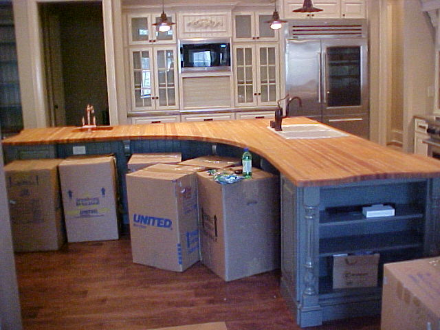

  7. susiekitchen | Aug 18, 2008 02:09am | #14
    CapnMac bumped this to me, so I played around with it a bit for you. I did an almost identical kitchen last year, except that each leg of the island was 10'. We did the entire top in mahogany with an ogee edge shaped like the one in plan "B". It could just as easily have been raised.
    Plan A is a version of what you are thinking. I used a cap on the pony wall that could match the working countertop or the raised section. I just like the idea of those two surfaces having their own identities. I'm thinking you could use some really spiffy tubular stainless supports coming up from the pony wall for the raised the upper portion.  That's a lot of top to cantilever, so you're going to have to work out the support carefully.
    Plan B has a continuous raised top with an arc that I think makes a nice counterpoint to the angles in the plan and the loft above. A little easier to support this since the greatest depth is at the 90 in the middle. You can actually furr out the base in an arc for support and attach traditional corbels if you like.
    Plan C is an illustration of what CapnMac was saying about flipping the ovens to the opposite side. It balances what's happening on the fridge wall so your heaviest objects are in a like position. Some people, however, like the idea of a strong visual break at the end of a cabinet run near an eating area. Either way will work, but I'm favoring function by preferring what you have drawn since it places the range a bit closer to the fridge.

          2. confused2 | Aug 18, 2008 10:05pm | #21
            Wow, you are a dream Susie!
            "Plan A is a version of what you are thinking" - yes - you are correct - that is pretty much what we had in mind.
            " Plan B has a continuous raised top with an arc that I think makes a nice counterpoint to the angles in the plan and the loft above. A little easier to support this since the greatest depth is at the 90 in the middle. You can actually furr out the base in an arc for support and attach traditional corbels if you like."
            I do like the curve alot - does the pony wall still get built, then the wood top sits onto of it? I have no idea how get the wood top done - but guess that is the carpenter's job :)
            Plan C is an illustration of what CapnMac was saying about flipping the ovens to the opposite side. It balances what's happening on the fridge wall so your heaviest objects are in a like position. Some people, however, like the idea of a strong visual break at the end of a cabinet run near an eating area. Either way will work, but I'm favoring function by preferring what you have drawn since it places the range a bit closer to the fridge."
            I had pretty much decided to move the ovens to the plan C location & extend the lower cabinets toward the dining room - there is a patio door there onto the BBQ deck, so it will make a nice transition zone. So that function won out over the range being closer to the fridge. I also like the way you have cut the corner - will save my hips from countless bruises!
            "I do like the idea of moving the MWV to beside the fridge, particularly if you have kids. It will be closest to the fridge and pantry, where most of the heat&eat stuff comes from. With the additional sink nearby, it also gives you a perfect place to set up an entertainment center. You can add an icemaker or a drinks fridge under the counter, glasses and party stuff above and you're all set. It's also a great place for a breakfast area since you've got all you need right in one handy place. Keeps guests and family a bit removed from the major work area."
            That's what we were thinking - breakfast,  beverages, party central - just stay out of the cooks way!
            What do you think about having the pony wall / raised area wrap around to visually break  / obstruct view into the kitchen on both ends of the island? While I like that idea, I am thinking with only 8 feet, it breaks it up too much. Half thinking on the dining room end of installing a lovely hand painted blind tucked behind the loft edge  and just pulling it down when needing the block from the dining room. (like really - do guests care or does it just bother the hostess that they can see into the kitchen)
            Thanks again for your advice & help.
          3. susiekitchen | Aug 19, 2008 06:47pm | #22
            Glad I can help in any way!
            If you decide to raise the top on the curved version I think it would look better sitting on a pony wall. I had my installer fabricate the top on the island I did. Because of the size it was made in 2 pieces. There are a couple of wood shops around here who could have done it, but not within our schedule, so my guy did it on his own. Lengthy process and not at all cheap, but it was exactly what the well-to-do client wanted. I'll post a pic (not very good quality, I'm afraid) so you can get an idea.
            Totally agree with that move with the patio nearby. The additional counter will be great when staging or serving food from the grill.
            The biggest mess in the kitchen for me is during prep and the pots, pans and utensils left after everything is in serving dishes. In your instance both areas are pretty exposed. If you're like me and stuff gets tossed everywhere during cooking, then having the raised area surround your counters could be a good idea. However, if you clean up as you go and put your cooking stuff directly into the DW, I'd opt to keep the ends open. I don't think many people pay as much attention to the "mess" as the cook does. We have an eat-in kitchen, not very big or efficient, and no one seems to mind holiday dinners within 5' of the sink.
            If you like the idea of raising the ends, why not do something attractive on them? I've done open display units or lit displays with glass doors there from 42-48"H. Worked in so that your columns "grow" out of them tops like those you often see in Craftsman homes and it can be a nice addition.
            Some other things:  do put a trash can/recycle unit in the prep area so that it's accessible to it and your breakfast area. Since I generally recommend 2 of these when there is more "zone" than "triangle", an additional one could be located by the range, too. I have a thing about trash cans not being readily accessible or out in the open.
            Your counter height is a matter of personal preference; 42" was typical for a long time, but lately all the ones I've done have been from 43-45". You'll find stool heights from 24-36" high, and the seat will generally be about 12" lower than the top.
            You need outlets for convenience and by code for your island. You can work these in along the raised back (they can go horizontally if nec.), on the ends or built into the face of the base cabinetry. There is also a pop-up duplex that gets built into the countertop (by Mockett, I think) that's often used in islands. Just be sure to take these into consideration as you plan - the last thing you want is to have to make last-minute revisions to your plans to avoid violating codes.
            Let me know if there's anything else I can do to help. You can email me directly if you need to.
