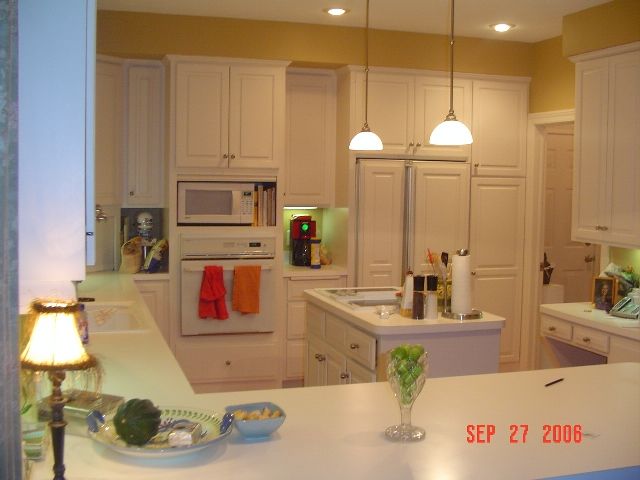

this is the view of the existing kitchen from the dining room…

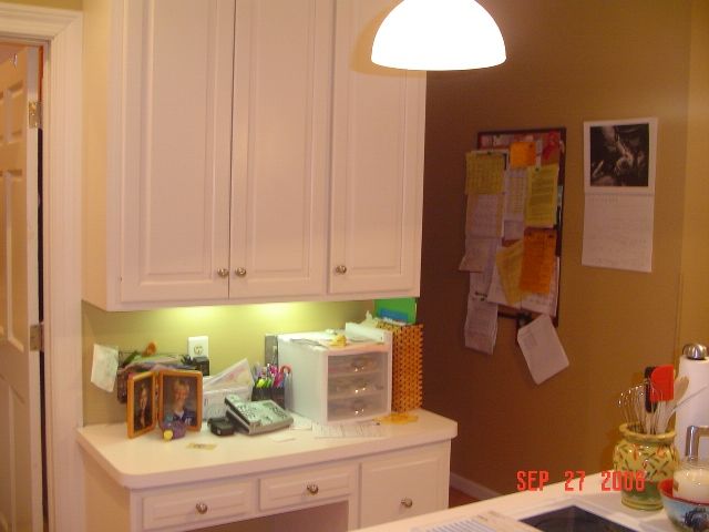

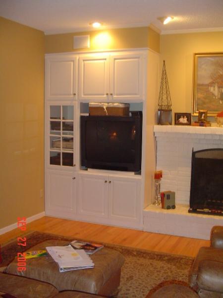

the wall by the existing desk will completely disappear…the door you see in the background is where the mud room will go (it is the garage service door)…the wall with the picture will be angled on the left side in order to have a better traffic flow to/from the mudroom…
here is another shot of the desk area that will be demo’d…the doorway to the left goes to the laundry room/garage service door and the hall on the right leads to the formal dining room (that will be framed in and closed off)

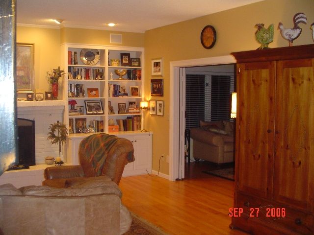

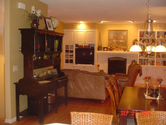

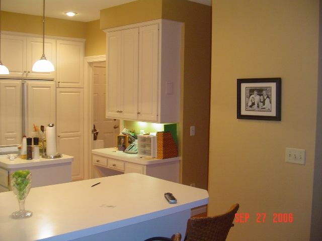

a shot from the kitchen through the dining area, out to the living room…we’re going to frame up some half walls to separate the areas a bit more (you can see the transition strip in the hardwood floor)…the fireplace brick is to be removed and a new stone will go in it’s place…the cabs on either side will be re done, and a 2×4 fixed window will go above each cabinet to allow more natural light…
the french doors going out into the “sitting room” will be removed, the header will be raised and the entire opening will be framed much bigger…the idea is to make the living room and sitting room feel more open…
