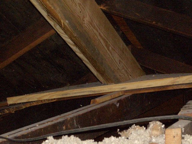

During the demo stages alot of things that we uncovered needed to be fixed. Understructured framing, and faulty wiring being the biggest culprits.
I was going to just replace the ceiling joists they were spliced many times and sagged inches because of that, so I installed a ridge beam to give us all the time in the world to reframe the joists and the sky light hole.
I decided on a pair of Southern Yellow Pine 2×12’s for the 8′ span. After we had that installed the HO asks me if we can make it a cathedral ceiling and keep the skylight. I gave her the thumbs up after discussing the finances.
I had to order a different framing package now. No big deal the rafters were undersized anyway. I chose 2×10’s for rafters, those were the biggest I could use and not interfere with the new upper cabinets that are already being made.

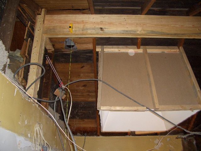

These are a few of the electircal hazards I found in the demo stages, these two pictures are of boxes that were drywalled over. No cover plates, even then they still would have been against code.
I also pulled out a junction box in the attic that was sparking a few feet from me. No cover plate and blown full of cellulose insulation. I killed the breaker and called in my electrician a few days early to get rid of the existing wiring in the kitchen. He'll start over with all new making everyone involved sleep better at night.

This is a good thread. Could you show a few pics zoomed out. I'm missing exactly what you're doing on those pushed in hangers. Thanks man.
I will get better pictures tommorrow, THe pictures of the hangers was just before we installed a 2 ply 11-7/8" LVL header.
I slid the hangers in first so I didn't have to cut more sheetrock out to get them in. I have already filled a 20 yard dumpster from what has come out of the old 8x14 kitchen.
