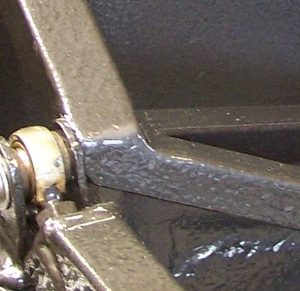

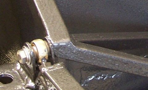

    I like this stuff - lowly Rustoleum brush-on enamel; hammertone black -
    Forrest
