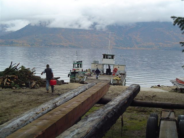

      1. gordsco | May 04, 2006 04:28pm | #16
        They were building a larger cottage on the same site and decided to bulldoze the old one.
        One of the locals asked if they could have the old cottage.
        The forest behind was too heavy to truck it and they didn't want a swath of trees cleared, so the guy floated it down the Lake.
        Kootenay Lake BC.
        The second picture is decieving, the lake is over 4 miles wide at that point. (90 miles long)
        Gord
        Edited 5/4/2006 9:58 am by gordsco
        1. pickings | May 04, 2006 06:30pm | #17
          The first floating click floor I saw was in my cousins cottage at Kootenay Lake. When they bought a larger cottage they unclicked the floor and took it with them.
          Jeezs....
          I thought they took the floor w/ them....then I saw the photos.
