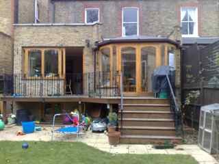

Partial demolition of existing brick rear addition and conservatory.
Cutting back of suspended concrete floor in conservatory.
Rebuilding of brickwork.
Construction of flat roof and installation of two sky lights. (Being imported from Denmark.)
Installation of new windows to addition and basement. (Being imported from Denmark.)
Installation of Bi Fold doors (Being imported from Denmark.) from addition onto new Swedish Pine deck.

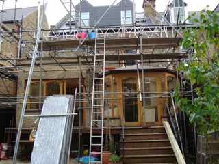

Addition 1 – Rear Addition on in the morning of day 1

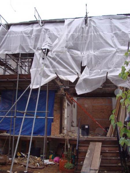

Addition 2 – Scaffolding is started, scaffold will support a tin roof while reconstruction is carried out.

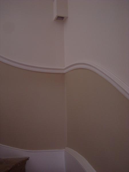

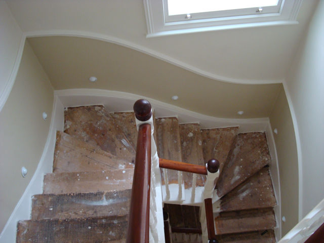

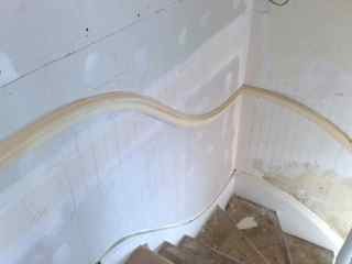

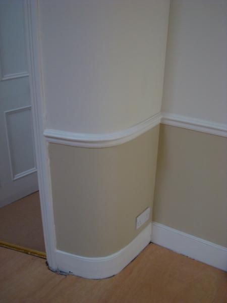

Dado 1 - curved dado on stair
Dado 2 - Finished section of dado
Dado from above - view from landing

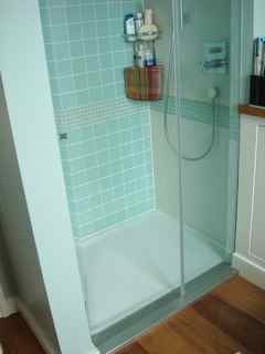

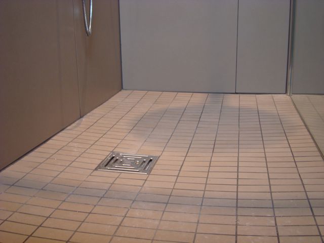

Wet room - shower

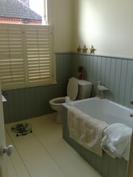

Family bathroom - bath
Family bathroom 2 - shower

"wet room 2" ... wherre is the water tank?
One of the pictures of the stair shows what looks like lights in the wall to light the steps. I really like the curved handrail. Why do you call it a dado?"Put your creed in your deed." Emerson
Wet room over here means a shower room where the floor forms the shower tray and generally while there is a screen there is not a door, will post some pics later of other wet rooms i built, as i am on my lunch at the moment and only got the laptop out to check my emails and ended up here, I love Break Time but it sure can distract you from you other duties. Will also take a close up of the dado rail tomorrow. Yes they are lights in the wall.

Great pics. Beautiful work.In the bathroom. I assume the flooring is original to the house. What species? What did you do to protect the wood from the water?
Thanks.The bathroom floor is engineered Teak, we glued the Teak down to a ply sub base and finished the floor with 3 coats of 'Bona, Traffic super matt.Floor was the first job for the client and was fitted 18 months ago and is showing no signs of water damage., even though it is in every day use.

What is a bespoke shower?
If we tried to import something from Denmark, it would likely be a nightmare considering the distance and customs etc. How does it work for you? Is it easy to get material from the continent?
A bespoke suit is a custom made one. I'd imagine the word can be used in other circumstances.
Thanks.House is in London, pretty much a standard high income house for London. I will email some pics of the street to give you a idea of the density. Regarding problems, it causes a lot, such as,Small staircases meaning we often cannot get 8' x 4' sheets to the upper levels.Parking is a nightmare, especially with over keen traffic wardens ready to fine you £80 for being 30 seconds late moving the van as there are limitations on when and how long you can park for, blocking street to unload a truck or any other reason they feel justifies ruining your day. Material wise we have to have materials delivered a day or two before we need them, can lead to added stress when materials are delayed or damaged.The shower screen was bespoke, as in made to my design by my glass guy. Buying from DK is great for us as they are part of the European Union which allows us free trade with other European Union members, also helps that the wife is Danish and that I was trained by a Danish contractor. The biggest advantage for us though is that we are setting up a Danish window and door supply company in London at the moment.

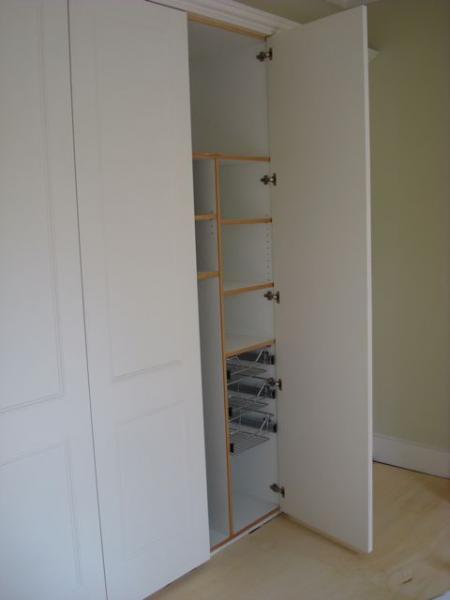

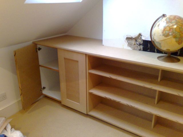

Here are some more pics of various works i have carried out in the house except for wet room 2 which is the neighbors house.

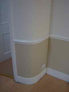

Here are some better pics of the dado rail, have also attached section of dado as there is some confusion about what it is. Will be interested to find out what you guys call it. Should have some pics tomorrow of the addition as scaffold is now up, one roof is down and second will be down tomorrow.

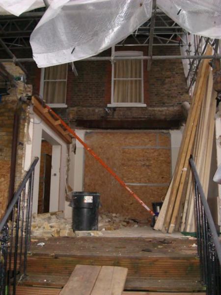

Been a long week, with two other jobs on the go as well as this job. Have not been able to post pics this week due to work commitments, these pics where taken Thursday morning, will take more on Monday as strip out is almost finished.Scaffold pic shows completed temporary roof.
Strip out 1 & 2 show brickwork and roof removed.
Access shows limited access on job through side access.
That is tight access. Hope the neighbors are friendly. Interesting thread, please keep posting."Put your creed in your deed." Emerson
